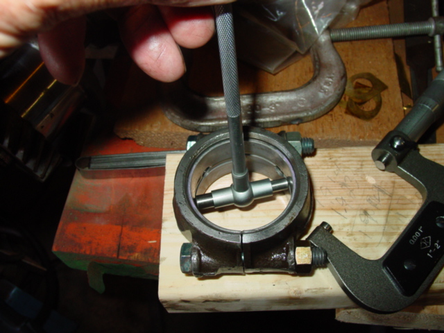

As a guess without seeing the engine with the pan off before disassembly would be one rod was installed back ward. That would put a bind on both the wrist pin and rod bearing. If the piston boss was under sized enough to seize you would have had to drive it in to start with. At this point I would take two bearing caps and bolt the bearing shells together and measure the ID as well as the crankshaft journal OD to see the actual difference.

That is the first thing I though too. I figured I had turned the rod in the wrong direction. When I get a new rod bearing set, I am going to mic everything. I checked the rod orientation and the long side was turned away from the mains, just like it is in the service manual.  Another thing, when we pulled the number one piston rod assembly out I noticed a catch in the wrist pin on it when you slide it in the bosses.  Talked to a Tisco rep. These guys don't actually make these kits, just bundle them. They want the old pistons back. I told them that one of them was in pieces as we had to cut the boss in half to get the rod out. They are sending two holes on warranty.

I am going to put the engine back on the stand, drop out the crank and spin the cam with my air wrench. We  can immerse the intake in a quart or so of oil with the pan off to test the pump. There was oil in the head but I am going to check the pump to make sure we are getting proper flow. The pumps on these engines only had 15 psi output pressure. With all the buillders lube that was used this thing should not have seized up in such a sort period of time. It popped off and ran only a few seconds.
I am a mechanical engineer and have access to a metallurgy lab. I am going to take a piece off this broken piston and have it analyzed to determine mass density properties and hardness. I have the sections of the bosses I sawed out. I am wondering if it may be a casting defect.
