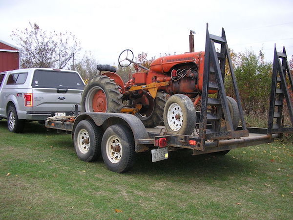

And B makes 3. Finally found a B I wanted to buy. I has it's share of issues so I will be asking(begging) for help in the future. For now it is put away in a friends pole barn. Question 1 What are the custom from rims off of?

Looks like rims from a car to me, like what you'd find on a spare.

That's what I thought.

Those rims might be off a trailer.

Those are 5 bolt trailer or light duty pickup rims.

They are off a 3500 lb. rated trailer axle.

A 12 inch garden tractor rim will fit a B- C hub !

Many tractor front rims are standard SAE ag rims, used on implements, wagons, trailers and sometimes cars and trucks. And were available from multiple manufacturers when the B was built and still today.

The rims on a B or C are 5 bolt on 4 1/2 in bolt circle. The same as Ford or Dodge used in the 60's, as well as 3500 lb. trailer axles. Standard ag 5 bolt are 5 in bolt circle.
