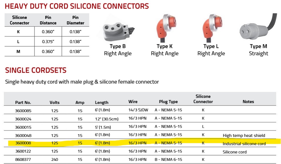

Post Options Post Options   Thanks (0) Thanks(0)   Quote calico190xt68 Quote  Post ReplyReply Direct Link To This Post Posted: 37 minutes ago at 7:37am
Here is the cordset that it uses too.  Looks like it is a 16 gauge wire.  So, 12 or even a 14 gauge extension cord depending upon how far the distance is to the receptacle, would work.
