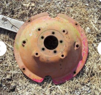

the rear hubs of a "C" have a big DISH to them.... the "B" is basically flat with a very small dish.
Rear tires are 5 ft (60 in) center to center.  Front is 45 inches center to center.
I think you have a "B" front axle ( probably engine and torque tube also) and a "C" rear axle ( including the trans).
"C" hub

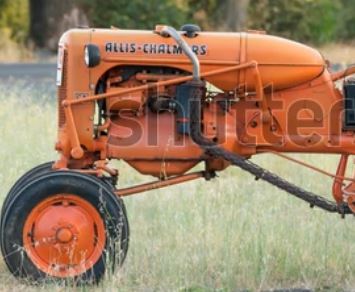

This is the front end of the tractor.  It appears to me to be obvious "B".
This shows the steering arms.  Again looks obvious "B" to me.

Look at the BIG DISH on the rear hubs..... Look at the STEERING Arm below the gas tank ( up or down)... look at the radiator wrap around and see if it has a hole and arm on the left side....... those are the tell tale signs... We already know the trans is a "C" due to the serial number.

Your steering box, steering arm ,and king pin connections are all B... so i would assume everything forward of the torque tube was off a B tractor...There is an extra plate on the side of the motor .. That is not original.. Could be some type of mount for equip.
