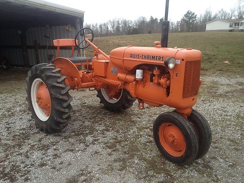

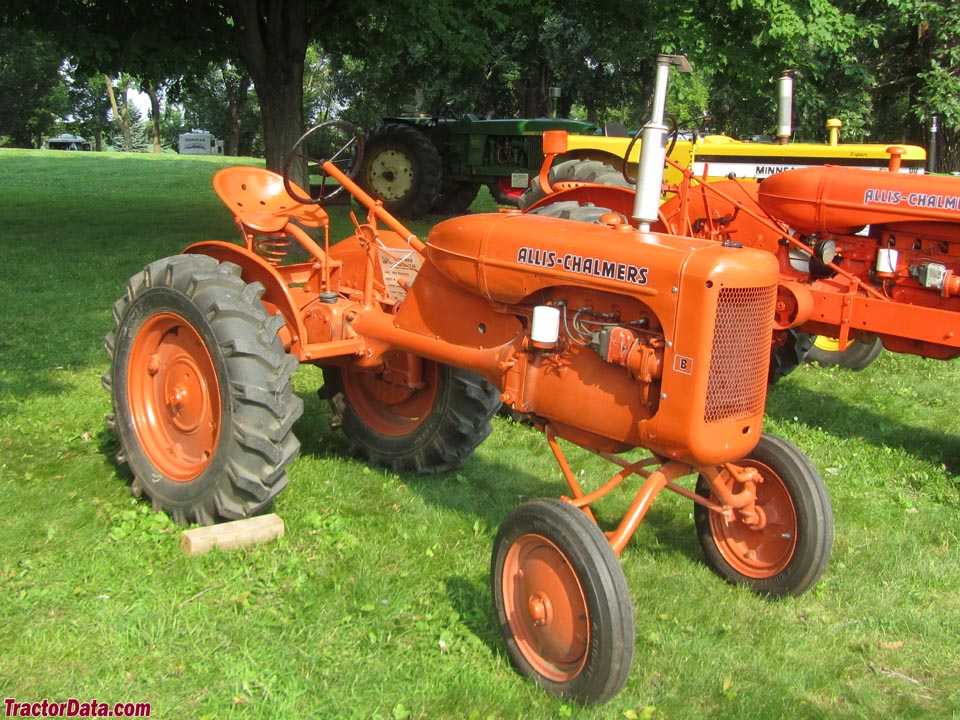

could help me to know the differences between model B and model C and even CA
I thought all C model had the 2 twin wheels at the front and a bench seat like that
And I thought all B model had the 2 wheels apart at the front and a metal seat like that
But it seems that it is not so clear? And what about model CA

C has a wider rear end, wider drawbar and the steering arm from the steering box.
Both B and C have three speed transmissions.
CA has four speed transmission, hand clutch and power adjust wheels.

C could be bought with either narrow, wide or single front wheel.
All B's were wide front end. Some later models had adjustable front end verses the "wishbone" type in your picture.
C was considered a two pow tractor, because of the added width. B was considered and one row tractor.

Most B's had a bench seat like the C in your picture. The seat on the B in the picture was an option.

The B  and C use the same engine, transmission, differential, hydraulics, tires and rims, and most sheet metal and radiator.  The C is "about" 6 ft wide and the B is "about " 5 ft wide. The rear axle is a foot wider ( 6 inches each side) than the B.. You could flip the rims and mount inside or outside the hub to get various width of  "tire on the ground"... ALL B were wide front... The C could be narrow or  wide front.
The CA was an Upgraded C . production of the C stopped and CA started. It had 4 speed transmission, and  upgraded hydraulics.  You picture of the C is VERY COMMON for a C.. Your picture for the B is VERY COMMON, except someone has changed the bench seat to suspension seat. Note the rear HUB on the C bolts on with a 5 bolt pattern... The HUB for the B normally slides over a 2 inch splined shaft with ONE big nut to retain it... There were a few variations to that rear hub, but not common.

i just got a c today sn 67135  are the torque tubes the same lenght on a b or c ?     on tractor data it says the c is longer than the b is that the differance in the front axles or some were else ?  i need few rear wheel clamps like the wheels in the first picture two dont belong and i cannot move the right wheel all the way in because two clamps hit the axle housing bolts

The torque tubes on the B and C should all be the same length. Over the years they added a few cast BOSS threaded holes for mounting equip. The steering box for the B was under the gas tank and the LINK goes to the left front wheel.... The C has a steering box under the gas tank with a LINK that runs to a second gear box under the radiator and  operates the vertical post attached to the front wheels.. That works better for a narrow front end. The gear boxes are not interchangable between the B and C.. they operate in opposite direction. Wheel clamps are available on e-bay... or if yours are worn they can be welded to additional thickness.
