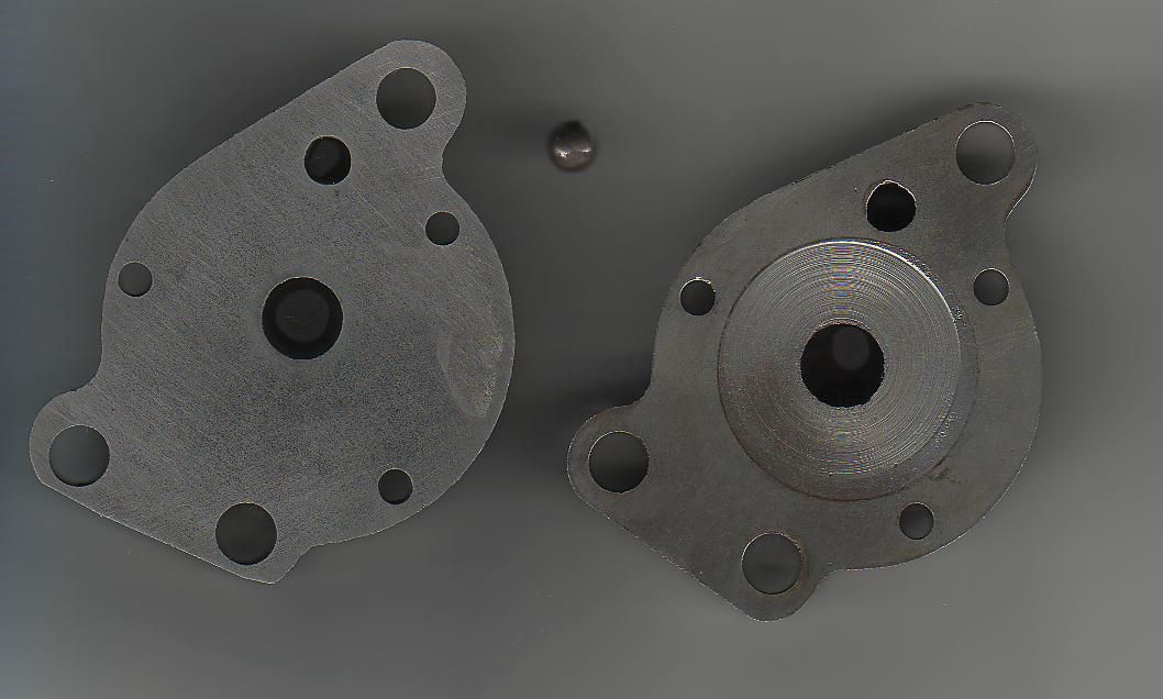

Do you have the pump apart? Any pumps that I have had that was low on pressure and the vanes and springs were good lost the pressure from an eat out cover or the ball in the stem was not holding.  Other  problems can exist like stem bushing being wore over sized.
The cover on the left looked like the one on the right before I resurfaced it.  The ball in the picture is rust pitted.
