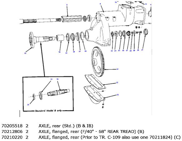

What I wanted to know ,were the final drive housing the same on all B's  even the last ones built.  I know the  rear wheels were different,  on the later B's they were same as the C's . Did they keep the final drives the same even though the wheels changed  .

NO: Some of the final drives on the very late Bs has a flange axle like the C tractors to do away with the splined hubs.
 The Build a B project tractor that I have has this style flange axles. The earlier B that had the 5 bolt hubs still had the splined axle with a 5 bolt hub.

Post Options Post Options   Thanks (0) Thanks(0)   Quote chaskaduo Quote  Post ReplyReply Direct Link To This Post Posted: 29 Nov 2018 at 5:59pm
From the AGCO ALLIS PARTS BOOK   page 144
Says 68' Rear Tread

Post Options Post Options   Thanks (0) Thanks(0)   Quote AaronSEIA Quote  Post ReplyReply Direct Link To This Post Posted: 30 Nov 2018 at 3:58pm
From the parts book it looks like there was only 1 final drive casting.  It looks like at B #18055 they changed to the 5 bolt flanged axle.
