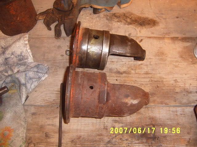

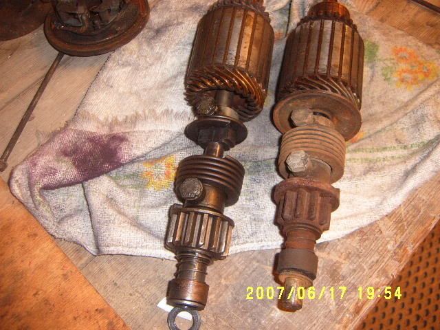

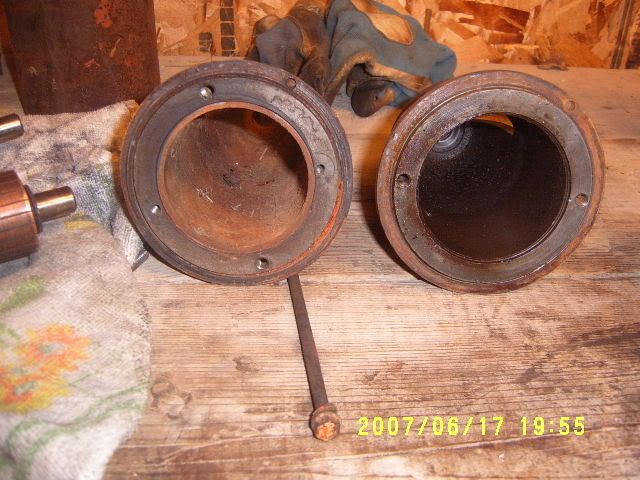

Post Options Post Options   Thanks (0) Thanks(0)   Quote Wil M (NEIA) Quote  Post ReplyReply Direct Link To This Post Posted: 16 Oct 2011 at 8:11am
Here are some pictures of a C starter and a WD starter nose cone and "inards" side by side.  The C starter is the shiny one and the WD is the rusty one.

Post Options Post Options   Thanks (0) Thanks(0)   Quote Rick Quote  Post ReplyReply Direct Link To This Post Posted: 16 Oct 2011 at 9:04am
Well...I thought i had changed them around before,but it's been a long time. According to the pics though,I would say not. Hopefully,I got the tooth count correct on the previous question! LOL!  Rick
