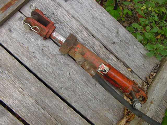

The tractor I am using it with is a WD45. The owners manual for the mower shows a cylinder with the hose fitting on the ram end of the cylinder, not the bottom like an Allis single acting cylinder.
1953 WD45 WF/Model 90 Loader, Oxnard Rear Blade, 80R Mower, Model 209 Disc, WD Rear Mounted Scoop, Model 184 & 160 Rotary Mowers, 1952 CA NF/L306CA mower, 1953 CA WF/Model 8 Loader.
orangereborn View Drop Down
Location: NW WI
Points: 1516
Post Options Post Options   Thanks (0) Thanks(0)   Quote orangereborn Quote  Post ReplyReply Direct Link To This Post Posted: 26 Sep 2016 at 5:49pm
 This is the cylinder used on the mower.  I think it is higher pressure rated than the standard 2 way but it functions as a 2 way. Probably similar to the 3000 PSI of the welded construction version.   It is not at all like the original AC high pressure design. Many regular 2 ways were used on AC High pressure systems but you could blow them out if the tractor pump was up to full pressure capability. AC also used this 2 way before they went to low PSI systems.  You should be able to use this cylinder on most any tractor......Dale
