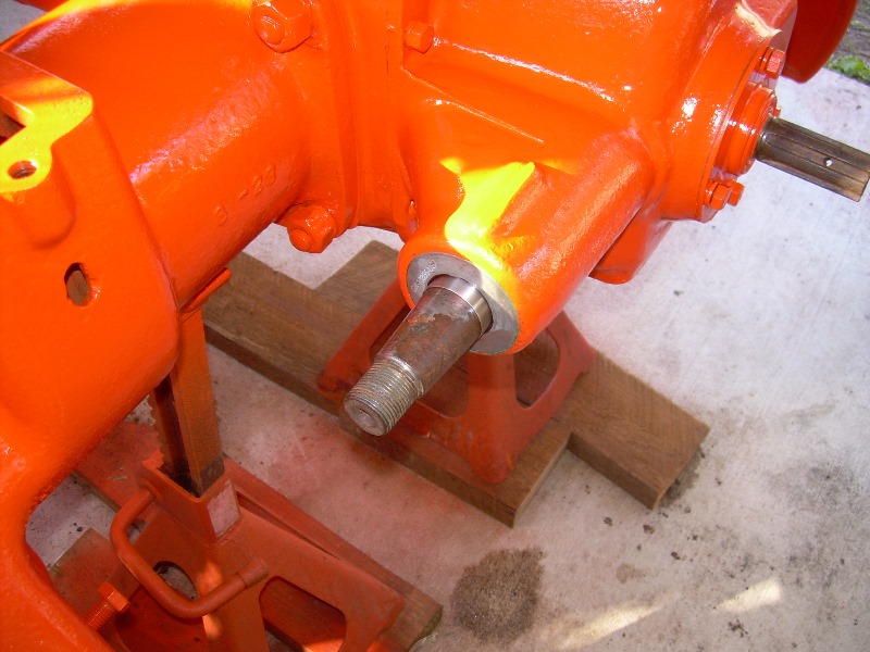

I also installed a speedi sleeve and new PTO shaft seal today.  It was leaking like a sieve! Got parts at NAPA.  Speedi sleeve is 99138, seal is 13865.

Good solid fix on the seal and new speedi sleeve! That should be much better!

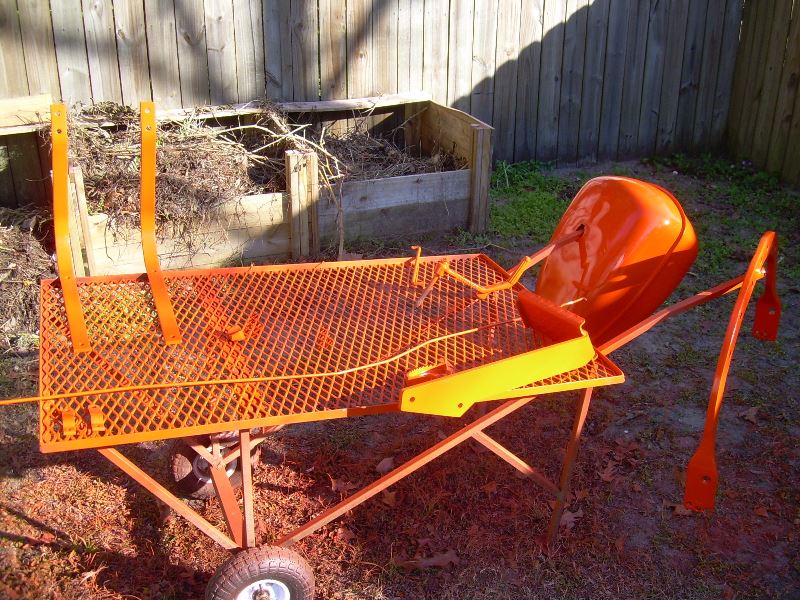

Hubnut... here are a couple photos i promised you of an "orchard" model I built out of a standard B... very similar looking to an IB, but has the long torque tube, and homemade straight front axle.... your  NEXT project ?
Hubnut View Drop Down
Joined: 30 Jul 2014
Location: Gainesville, FL
Points: 1817
Post Options Post Options   Thanks (0) Thanks(0)   Quote Hubnut Quote  Post ReplyReply Direct Link To This Post Posted: 19 Jan 2018 at 2:59pm

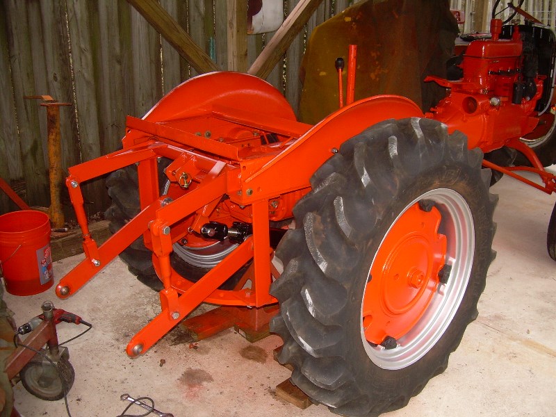

Was off from work today and it was warm enough to finish up the painting.  I hate that part of the job!  Tomorrow should be about reassembly.
1940 B "Lucy"
1941 B w/ Woods L59 "Flavia"
1942 B w/ finish mower "Dick"
1941 C w/ 3-point "Maggie"
1947 C SFW w/ L306 "Trixie"
1972 314H

 I like the custom spray cart! Great idea!
Pieces parts are looking real good.

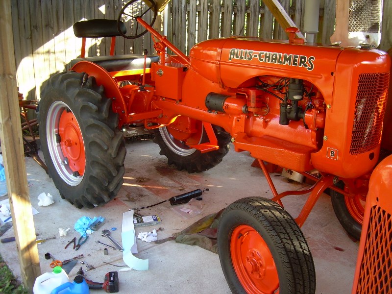

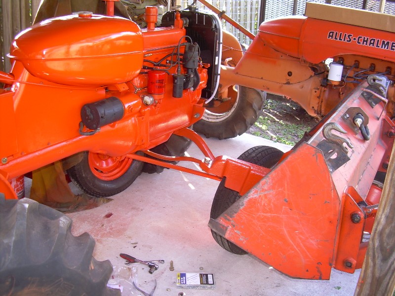

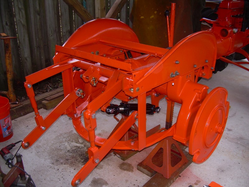

Started assembly today.  I thought I'd get the whole tractor done and running.  No.  Brake assembly and 3 point assembly took longer than anticipated.  I should be able to get it back together tomorrow.

Finished most of the assembly today.  Still have to hook up the lights and a few things here and there.  Used Katy Kubota to help install the engine weights.

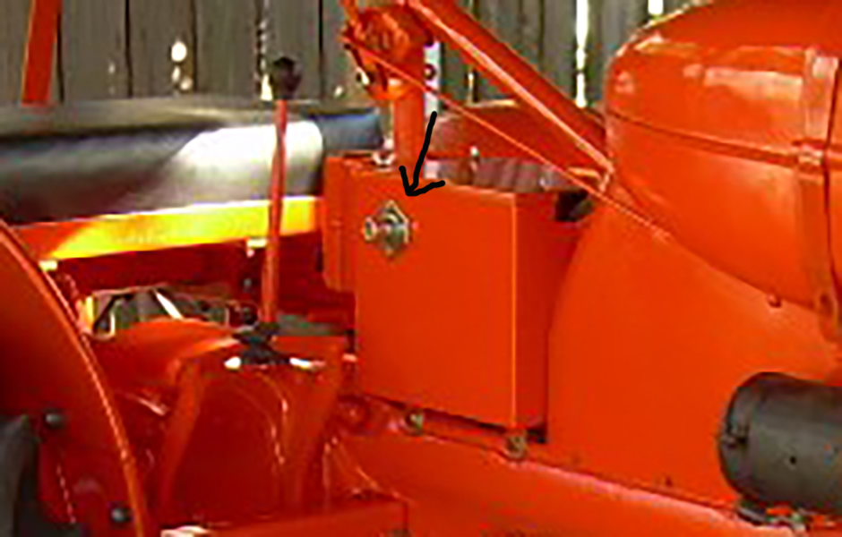

I must have missed something...
what's that protruding from the battery box?
btw, the rest of the tractor looks just like mine... and then I wake up.
superb work, sir!

drobCA,
It's an old (new) foot switch I had leftover from something else (like on 8Ns).  I figured there was no reason to buy anything I didn't need.  Thank you for the comments.

I thought that looked vaguely familiar...
very nice "owner engineering"!Thumbs Up
but, wow... if the Fun Police ever find you out you are in for a huuuuge fine!!!.
