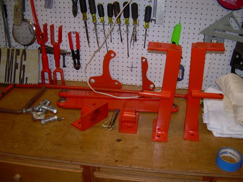

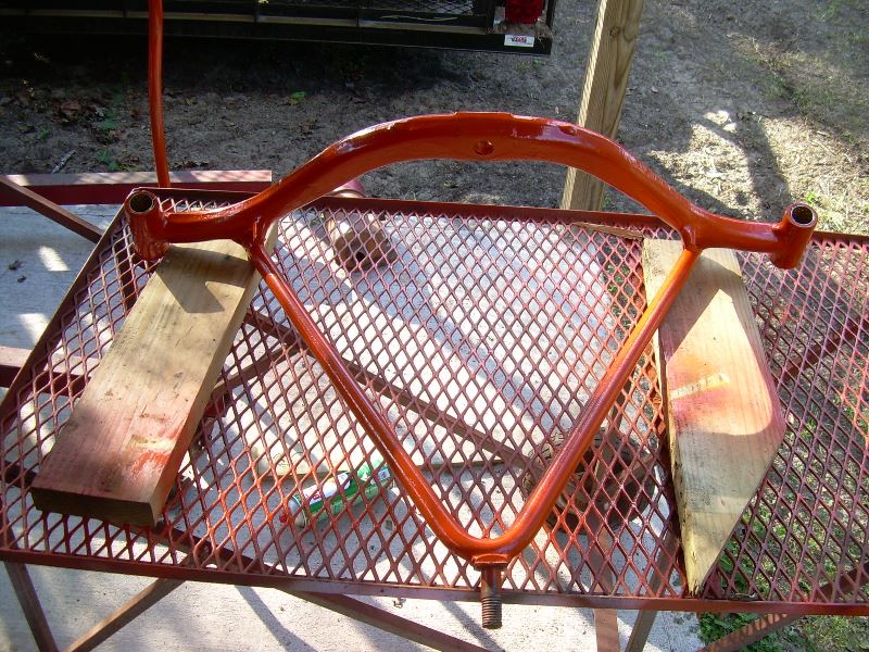

Posted By: Hubnut

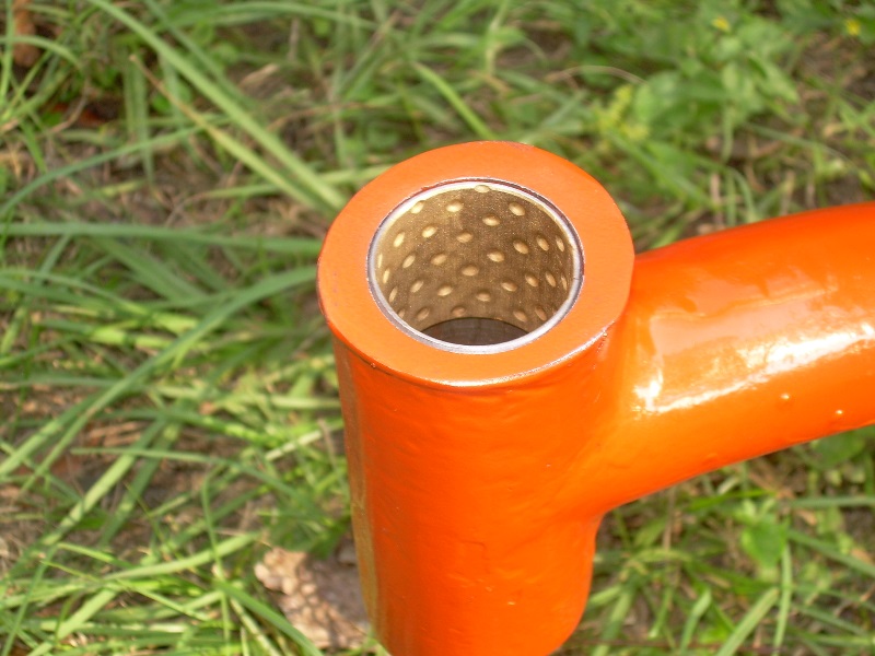

Date Posted: 04 Nov 2017 at 4:43pm
The work progresses slowly.  Got the front end partially rebuilt and painted.  New spindle bushings installed.  I'm trying something new with this tractor.  Fix as I pull things off.  By the time I get to the end, all I have to do is reassemble.

Posted By: Sugarmaker
Date Posted: 04 Nov 2017 at 6:13pm
Steve,
 Repaired wish bone looks very good with bushings in place. I have toyed with the concept of fixing things as removed. Never seems to work for me!

How did you get the old spindle bushings out?  How did you press the new ones in?  I tried to get mine out but they have become one with the axle.  Thanks in advance for any advice - Brad
Posted By: Hubnut
Date Posted: 05 Nov 2017 at 4:55pm
Brad,
Two came out with a brass drift from the inside. You try to grab an edge and work it out.  Two were like yours, no edge--almost gone.  I take a hacksaw blade and slowly cut a groove into the bushing.  You don't have to all the way to the support metal, but get close.  Then, I use a drift on the outside to "peel" the bushing inward on itself.  Takes some effort, but works for me.  Probably not the correct way either, but it works for me.  To put them back in, simply press them in.  I use a piece of flat stock to cover the entire bushing.  Go slowly.  Good luck.

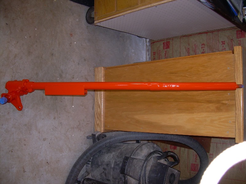

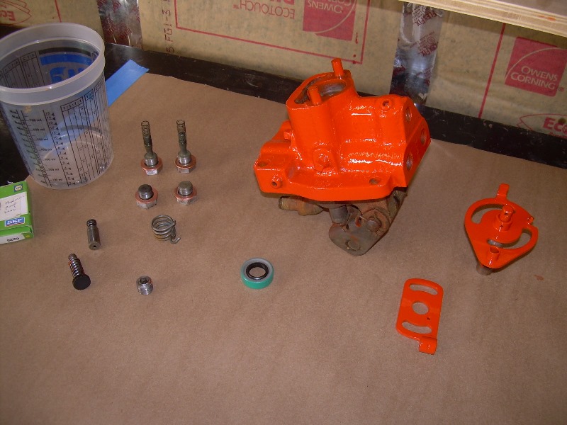

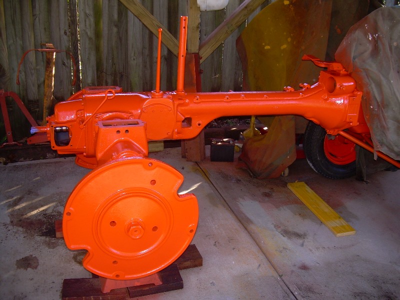

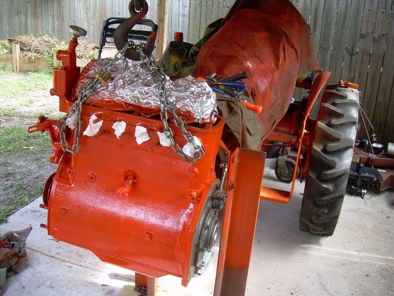

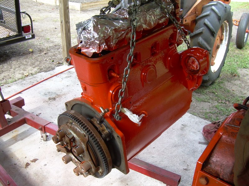

Posted By: Hubnut
Date Posted: 12 Nov 2017 at 5:01pm
Made some progress this weekend.  I pulled the engine and got it cleaned up, primed and painted.  I still need to get the peripherals (oil filter assembly, distributor, valve cover etc.) cleaned, serviced and painted.  The previous owner told me the engine was rebuilt and he could never get it started after the rebuild.  The magneto was bad and it ran great for me.  The back of the engine was spotless and the oil pump was obviously rebuilt.  I disassembled it to check it out.  I replaced the ring gear--it was a little worn.  Making progress.
Date Posted: 12 Nov 2017 at 6:25pm
Steve,
 Looks awesome! You headed towards a totally cleaned up tractor if your not careful!
Nice to check things out so you know what shape the tractor is in. Sounds like it was not monkeyed up like some are!
Engine looks awesome!

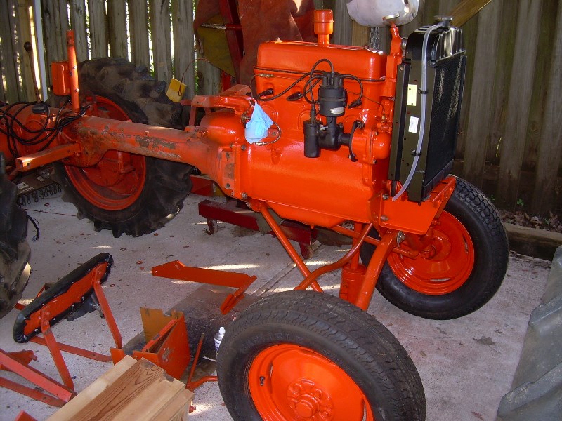

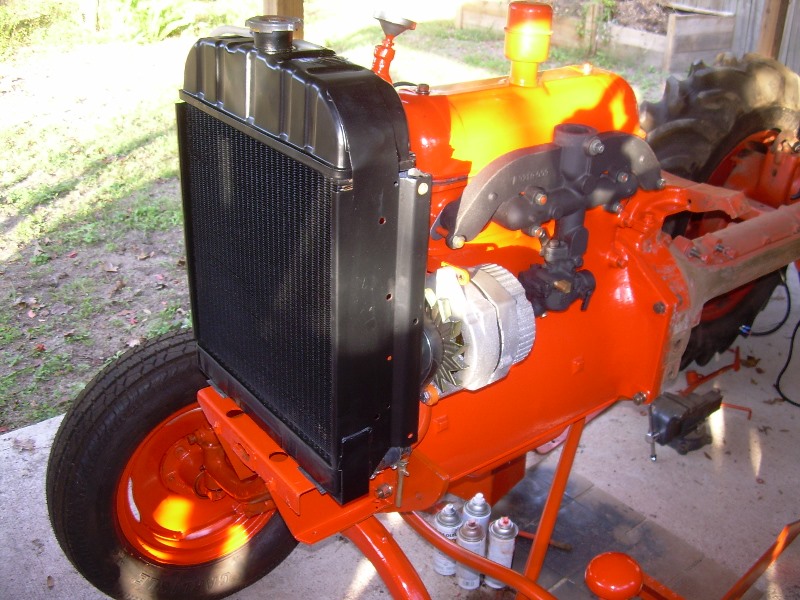

Made a little progress on my latest B project.  The radiator was used in another B that needed one.  I bought a new one for this B.  I got the exhaust manifold, oil filter housing, alternator, and distributor installed.  I also got a 3 point conversion for this B.  Had all the parts sandblasted and painted.  Also sandblasted other parts.  There was some DEEP rust pitting in the seat frame and fender supports.  Still serviceable though.  I took the weekend off to do some woodworking.  I found some 100 year old heart pine from a deconstructed hardware store that needed to made into something.  Simply beautiful wood!  I'll get on the B next weekend--or the next.

Posted By: theropod
Date Posted: 03 Dec 2017 at 3:44pm
Posts like this make me sick! Sick with envy.
Gonna be such a nice B when you are done.
I have yet to open up the front end of mine. I sort of dread it, but in for a penny, in for a pound.
Great work.

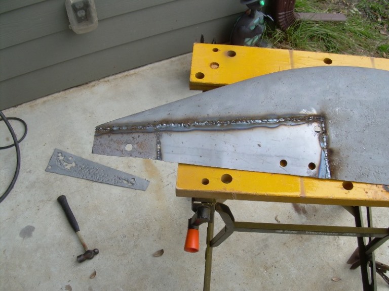

Posted By: Hubnut

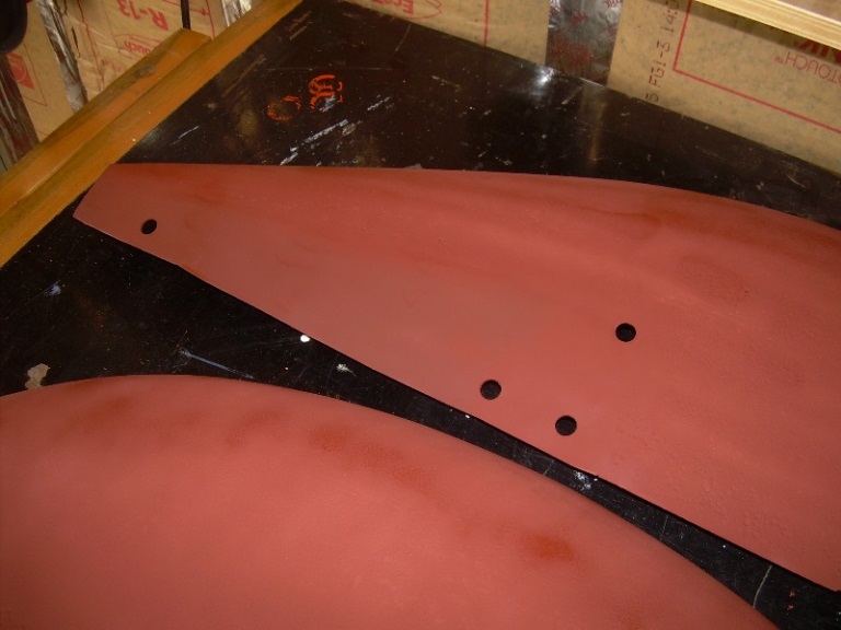

Date Posted: 31 Dec 2017 at 5:51pm

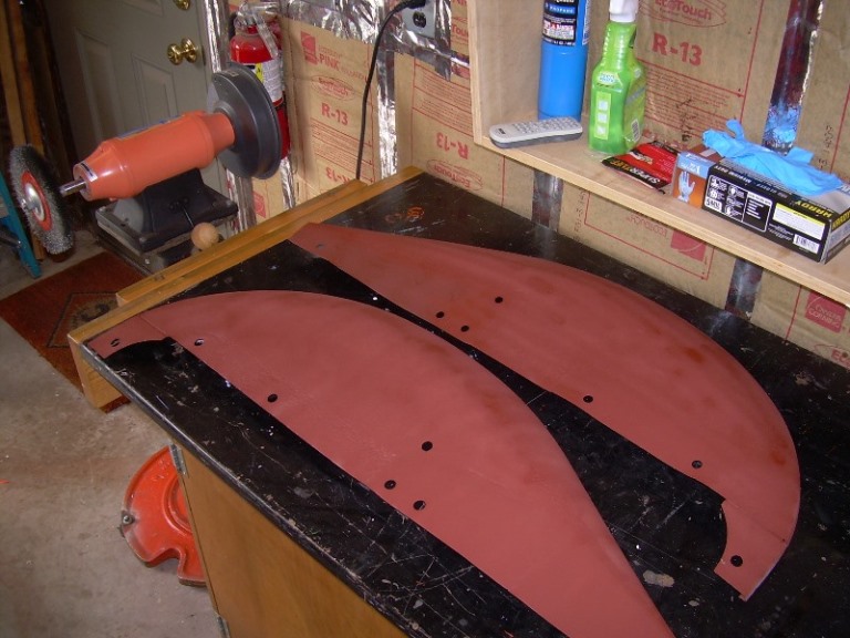

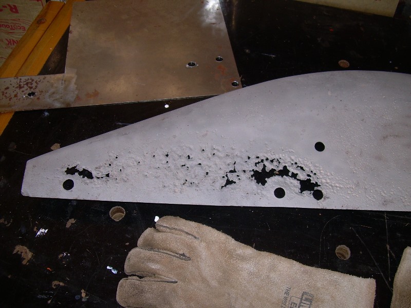

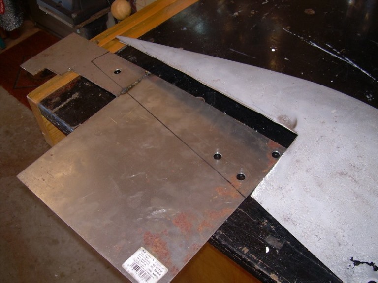

Got a little done on the B today.  I had the fenders sandblasted and they are rough.  Deep pits and rust through.  Had some sheet metal scraps in the shop, so I decided to fix the rot.  Not a professional job, but it is strong and whole again.

Posted By: LeonR2013
Date Posted: 31 Dec 2017 at 6:22pm
The easy way to take out those spindle bushings is to get a caping chisel (a narrow chisel that just cuts on one side). Drive it down between the bushing and spindle and it will cut the old bushing right out without damaging the spindle.
Date Posted: 31 Dec 2017 at 6:29pm
Steve,
 As far as I am concerned it sure looks like a professional job you did on the fenders! Nice work!

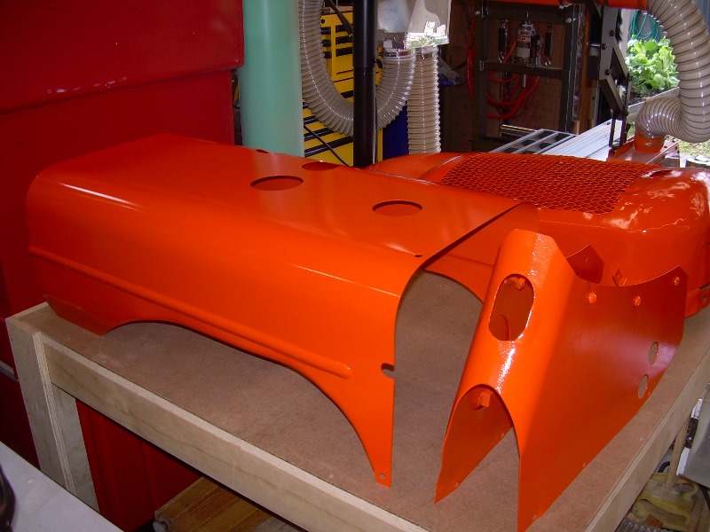

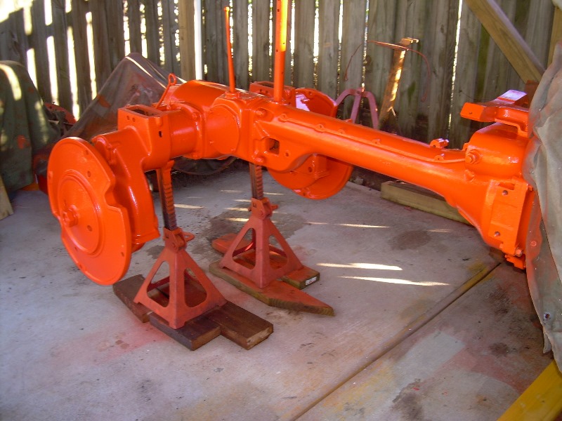

Posted By: Hubnut
Date Posted: 05 Jan 2018 at 4:34pm

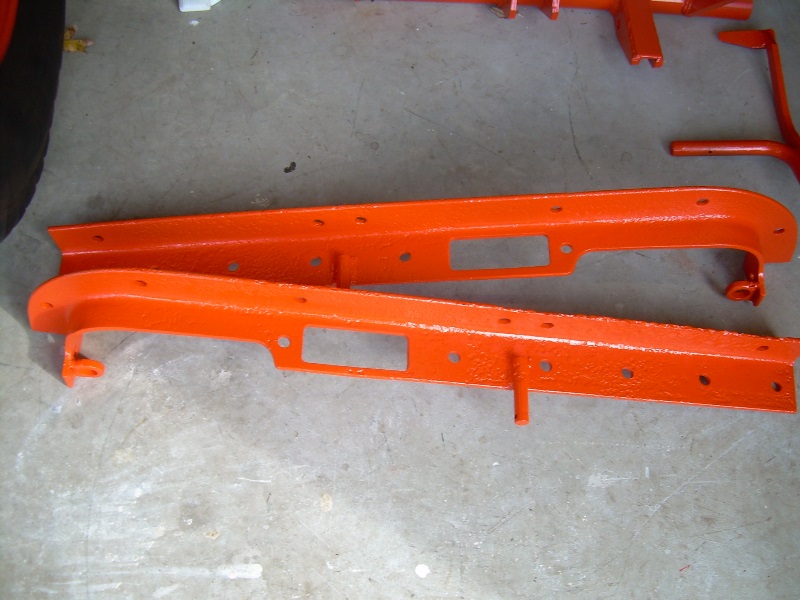

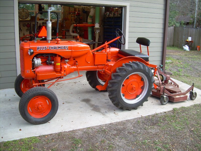

Another brief update.  I got some painting done last weekend before it rained and turned cold.  Paint went on very well for a change.
Date Posted: 05 Jan 2018 at 4:58pm
Steve,
 I like it! Man that orange really pops! Nice work on the sheet metal! Looks great. Now assembly.

Today's event with the 45.
Posted By: theropod
Date Posted: 05 Jan 2018 at 6:03pm
Thise radiator shrouds sure did take a beating. Mine has the same crumpled dents, and I left them in mine too.
Nice work! Thanks for sharing. All my work has come to a screeching halt too.
Put the bunny back in the box!
1938 B, 1977 Yanmar YM2200

Posted By: Ken in Texas
Date Posted: 05 Jan 2018 at 6:11pm
Steve Hubnut
    You the man when it comes tp sheetmetal repair.  One thing I never learned to do was weld.   Raised 2 boys that are expert welders  both stick and wire. Youngest is putting new floors in my  52 willys Pickup restoration.  When he does stuff like this it is better and stronger than  when new.    Youngest  makes his living doing Auto Restoratiion Work. Oldest boy is a rig welder with his own truck.
    If you need any C or C parts I still have a pretty good stash of good useable used parts. Kenny
Posted By: Hubnut
Date Posted: 05 Jan 2018 at 8:29pm
Originally posted by Ken in Texas Ken in Texas wrote:
Steve Hubnut
Kenny,
Thank for the complement.  Means a great deal to me coming from you!  A lot of people on this site will be glad you've posted.  I (we) hope things are going okay for you.  I wish you well in 2018 my friend.  My best,
Steve

Posted By: Hubnut
Date Posted: 05 Jan 2018 at 8:55pm
Steve,
Thanks for the update on the latest B:
Rain whats that? Oh I remember now. We might get some of that in a few days too.
Chris,
Not quite ready for reassembly.  Getting there though.  Sorry to poke fun about the weather.  I know I have it good here in Florida.  However, I would like to experience some snow like that one day.  Stay warm!
Steve

Posted By: Hubnut
Date Posted: 05 Jan 2018 at 8:57pm
I beat the snot out of those dents.  It actually looks better now.  All of my tractors have those same dents.
Date Posted: 06 Jan 2018 at 11:14am
Steve,
 The season changes really make us hate winter more and appreciate the summers!:) Better for you to just look at it from afar!
Off to plow the drive again. And get the new battery in the 45.
Have you tried any of the high fill primers for rust pits? I want to try some in the future, if I ever paint another tractor.

Posted By: theropod
Date Posted: 06 Jan 2018 at 5:42pm
I just stuck my foot in my mouth there didn’t I? Lol...

Small steps.  Cleaned the hydraulic pump and got a new seal for it.  Will reassemble after paint dries.  Steering box was in excellent shape, so I just cleaned it and painted it.  Notice the hump in the middle of the shaft sleeve.  Previous owner made a nice repair to rust through and I saw no need to change it.  Looks like a snake ate a big rat.

Date Posted: 14 Jan 2018 at 4:53pm
Got warm enough to get the remainder of the chassis painted.  It was very dry so the paint went on really nicely.  One or two runs, but it's getting there.
1940 B "Lucy"
1941 B w/ Woods L59 "Flavia"
1942 B w/ finish mower "Dick"
1941 C w/ 3-point "Maggie"
1947 C SFW w/ L306 "Trixie"
1972 314H
Date Posted: 15 Jan 2018 at 3:43pm
Steve,
Back of B looks awesome! Man does fresh PO look good! Don't worry about those runs, I bet the factory had some too! So your just trying to make it look authentic!:)
Also, when you get this far, there is not turning back now!
I am not going to say anything about the weather, temperature, paint drying, or the viewing of the sun!:) Ok just a little!
Its snowing enough I can't see the woods behind the house, we were about zero last night.
I did go to Kel's and fired up the WD45!

Posted By: CrestonM
Date Posted: 15 Jan 2018 at 3:59pm
Yep, looks great!
Like Chris said, they had runs from the factory. My Super 100 has a bunch on it.

Was off from work today and it was warm enough to finish up the painting.  I hate that part of the job!  Tomorrow should be about reassembly.

Date Posted: 20 Jan 2018 at 4:51pm
Started assembly today.  I thought I'd get the whole tractor done and running.  No.  Brake assembly and 3 point assembly took longer than anticipated.  I should be able to get it back together tomorrow.

Finished most of the assembly today.  Still have to hook up the lights and a few things here and there.  Used Katy Kubota to help install the engine weights.

Got the mower on today.  I got this finishing mower in a previous deal.  Thought it would work well with the new B.  Got the lights on too.  I need to hit it with a timing light this weekend. I also need a fitting for the hose to pump.

Posted By: BenGiBoy
Date Posted: 22 Jan 2018 at 5:44pm
Sweet! Looks really nice... Just don't forget to take the muffler sticker off before you start her up for a extended period of time, it might smell a bit funny. Smile

Posted By: The Consultator
Date Posted: 26 Jan 2018 at 8:09am
Steve, amazing job in such a short time! I've mulled over fixing everything completely right as I go, and reading this thread definitely motivated me.
One question: Those angle irons you used to support the tractor with the front end off- home-made? Excellent idea! I know my front end needs attention as well. It's on the to-do list.
Again, fantastic work!
1939 Allis-Chalmers "B" restored in 2010- very good condition.
Posted By: Hubnut
Date Posted: 26 Jan 2018 at 10:59am
Consultator,
Thank you for the kind words.  It went well doing a little at a time.  Seemed more manageable than having a thousand pieces all over.
Yes, the angle iron is homemade.  Just drill two holes for the torque tube.  Safest way I've found to work on these tractors.  I got the idea from someone else on here.
