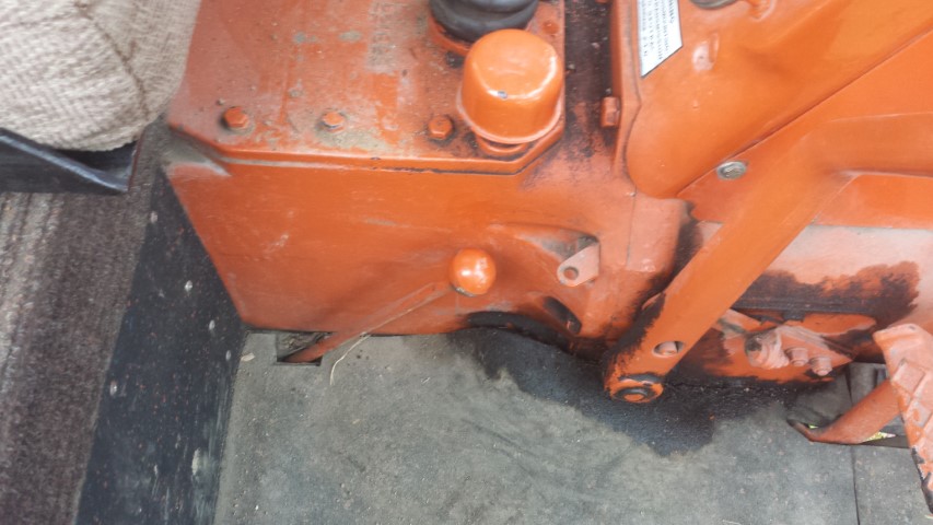

First off, whats this lever with round knob?  I ordered an op manual, but can't wait.. LOL

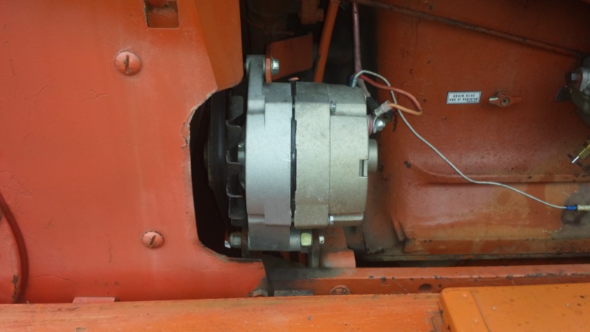

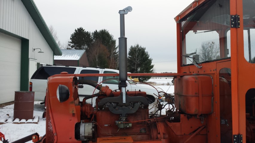

So, I posted some pics.  GM alternator, however, not a one wire.  Frame on side of tractor looks like for a Jerry can or another battery.  Right grill needs some work.  Under cab support. Couple shots of interior of cab.  Rear valve stem corrosion, tires are NOT loaded, I will get some silver PR15 and touch up.  Rear end, not sure whats Allis and whats not.  Category 1 on the arms which I use, however link is category 2.  Gas gauge is corroded and doesn't work.  Gauges are junk.
I did adjust the carb and it runs pretty smooth.  The monkeys at the auction went banana's on it when it apparently ran out of fuel, all thinking they knew what was wrong.  I put a gallon of gas in it and it fired right up.
Its charging and is 12V positive ground.  Which will help with the plow hookup.
The exhaust manifold is shot where the muffler threads in.  Will have to get a new one.
I do like the pin mount plow mount.
More too come..

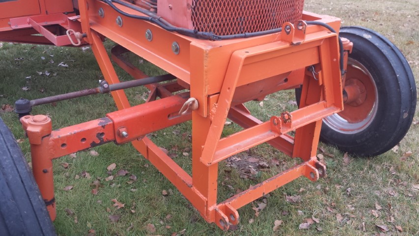

WF owner View Drop Down
Joined: 12 May 2013
Location: Bombay NY
Points: 5025
Post Options Post Options   Thanks (0) Thanks(0)   Quote WF owner Quote  Post ReplyReply Direct Link To This Post Posted: 29 Oct 2018 at 6:26pm
Are you sure it's positive ground? It's possible, but not very common with an alternator. Also, I see you have a radio. Most radios require negative ground.

The little round knob is on the snap coupler release lever. That lever pulls back to remove the drawbar, which enables you to mount other snap coupler equipment. You won't need that if you are just using three point mounted equipment. The power director lever should lock in both high and low positions. The power director clutches run in oil, so when the oil is cold, the clutches drag in neutral, like a motorcycle clutch. Usually gets better when warmed up. If you need a slower travel speed, the power director can be slipped for long periods without damaging anything.
Whoops, I meant to say Negative ground.  Opposite of what its supposed to be.

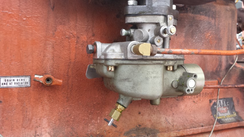

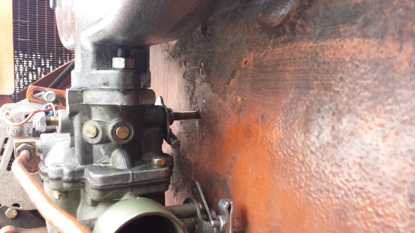

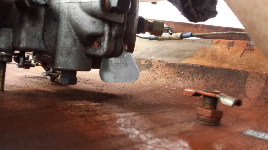

All that glitters is not gold.
Exhaust manifold was cracked and shot, muffler bottom was rotted through.  New manifold and muffler.

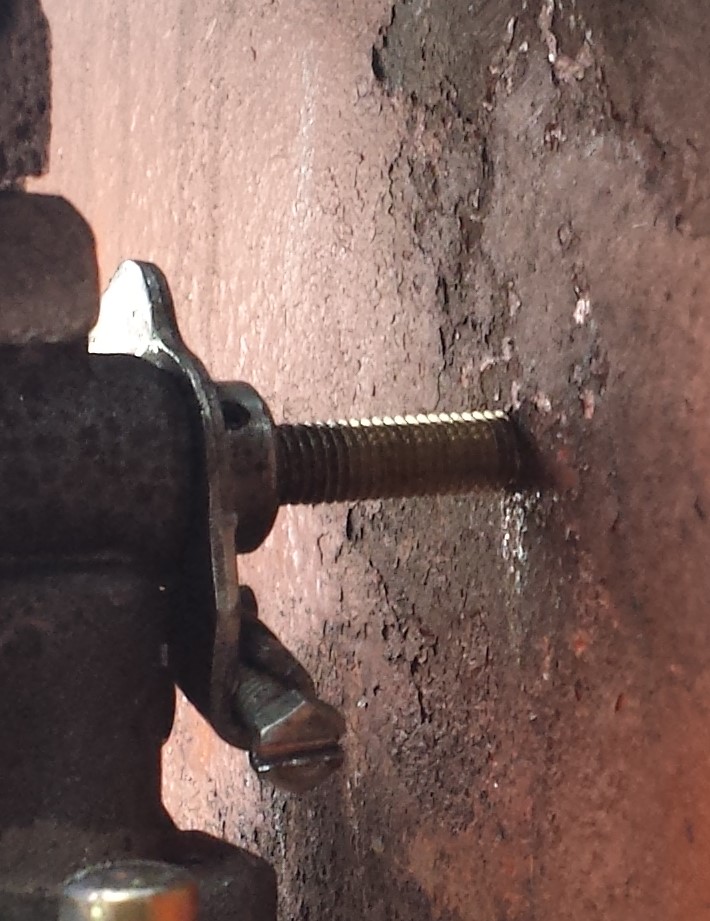

Carb is a new replacement, however, a universal.  The throttle shaft is tight against the block.  Governor linkage was to clubby and hit the choke arm which is also clubby.  10 pounds in a 5 pound bag.
Will need to rework the throttle.  Good time to hook up a foot throttle for snow plowing.

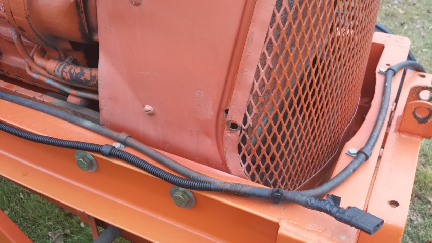

Have plow hanging on it, net to wire and plumb that up.
All for now.
Points: 21919
Post Options Post Options   Thanks (0) Thanks(0)   Quote DrAllis Quote  Post ReplyReply Direct Link To This Post Posted: 10 Nov 2018 at 4:42pm
Don't know what the point of the picture is, but as long as that throttle shaft isn't rubbing on the engine block, it won't hurt anything.

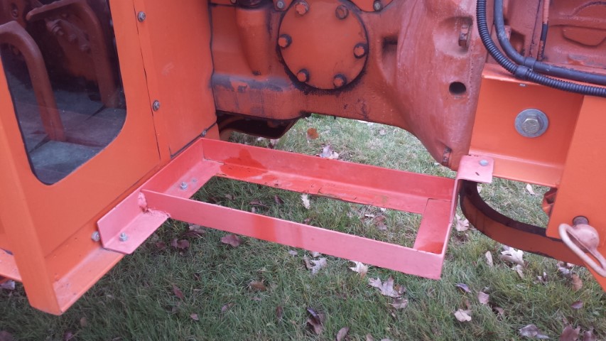

Battery pan in battery box was rusted out.  Have the new pan being fabricated.  New box costs $180.  I will post pics when I get the "fixed" battery box back from powder coater.
The throttle shaft is buried into the engine block as seen in the picture(s).  Thats the issue.  Also, the universal arm was loose as a goose.

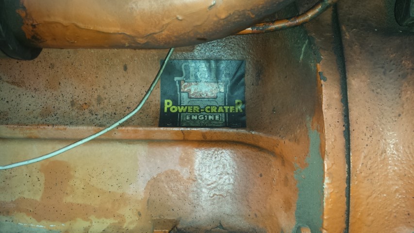

OldSchoolRecovery View Drop Down
Joined: 06 Nov 2015
Location: Eagle River, WI
Points: 301
Post Options Post Options   Thanks (0) Thanks(0)   Quote OldSchoolRecovery Quote  Post ReplyReply Direct Link To This Post Posted: 10 Nov 2018 at 5:12pm
I will have to take tag off to get a better look at the numbers to see what it is for.
