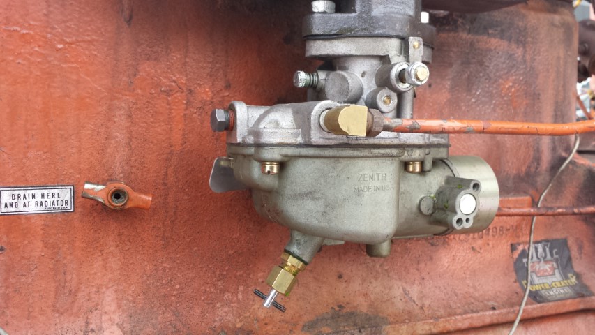

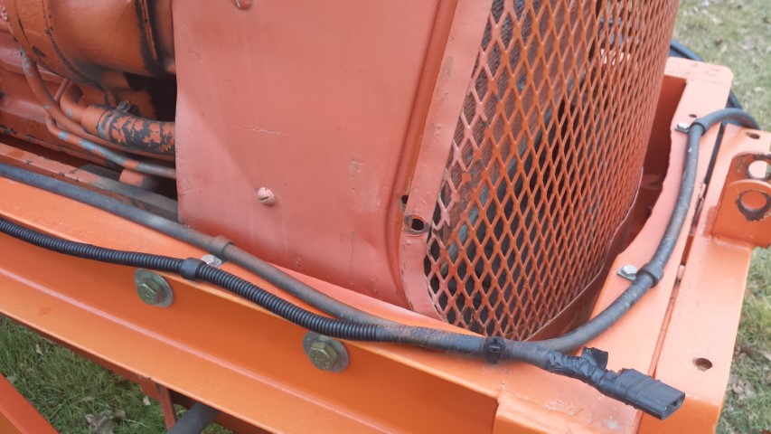

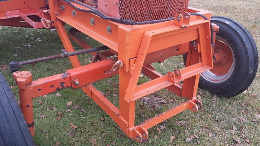

So, I posted some pics.  GM alternator, however, not a one wire.  Frame on side of tractor looks like for a Jerry can or another battery.  Right grill needs some work.  Under cab support. Couple shots of interior of cab.  Rear valve stem corrosion, tires are NOT loaded, I will get some silver PR15 and touch up.  Rear end, not sure whats Allis and whats not.  Category 1 on the arms which I use, however link is category 2.  Gas gauge is corroded and doesn't work.  Gauges are junk.
I did adjust the carb and it runs pretty smooth.  The monkeys at the auction went banana's on it when it apparently ran out of fuel, all thinking they knew what was wrong.  I put a gallon of gas in it and it fired right up.
Its charging and is 12V positive ground.  Which will help with the plow hookup.
The exhaust manifold is shot where the muffler threads in.  Will have to get a new one.
I do like the pin mount plow mount.

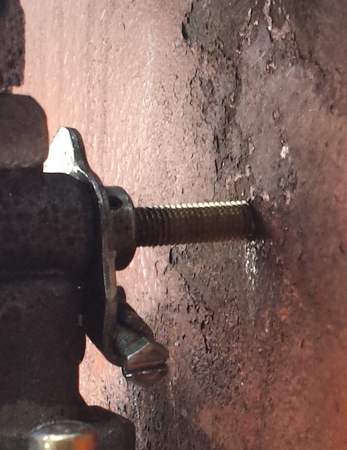

Date Posted: 10 Nov 2018 at 4:41pm

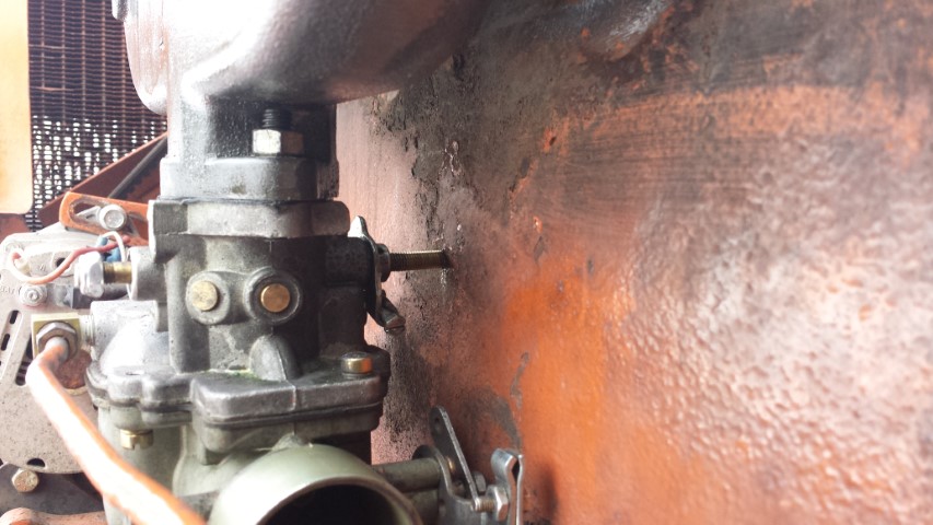

All that glitters is not gold.
Exhaust manifold was cracked and shot, muffler bottom was rotted through.  New manifold and muffler.
Carb is a new replacement, however, a universal.  The throttle shaft is tight against the block.  Governor linkage was to clubby and hit the choke arm which is also clubby.  10 pounds in a 5 pound bag.
Will need to rework the throttle.  Good time to hook up a foot throttle for snow plowing.
Have plow hanging on it, net to wire and plumb that up.

Posted By: DrAllis
Date Posted: 10 Nov 2018 at 4:42pm
Don't know what the point of the picture is, but as long as that throttle shaft isn't rubbing on the engine block, it won't hurt anything.

Date Posted: 10 Nov 2018 at 5:07pm
The throttle shaft is buried into the engine block as seen in the picture(s).  Thats the issue.  Also, the universal arm was loose as a goose.

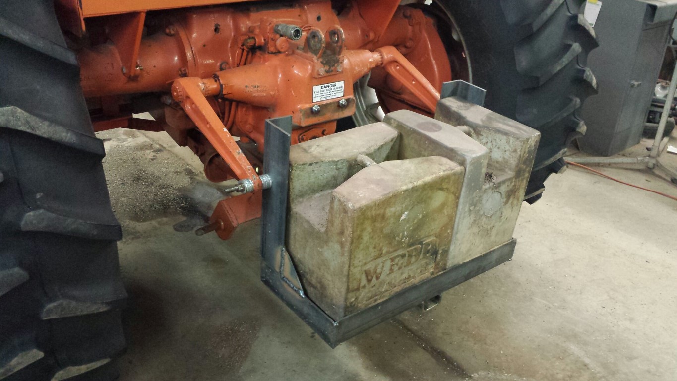

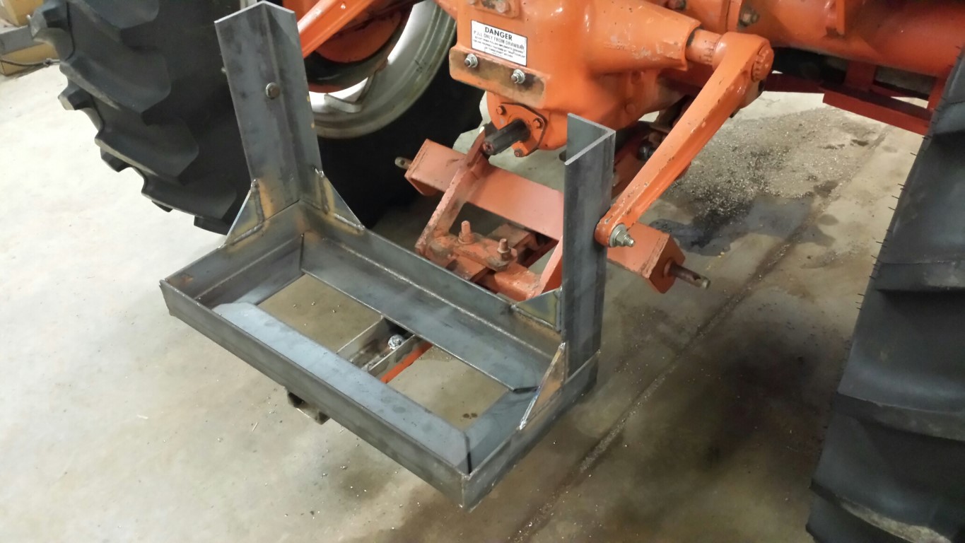

Update
Made a weight box for the back.  Made it to hold two 500 lb weights.  Gave it a try and while traction improved a bunch (was not too bad before, just on ice) it will push sideways if plow angled and a heavy push.
Overengineered.
Will try one 500 pounder tomorrow.

Date Posted: 23 Jan 2019 at 6:09pm
1000 pounds....

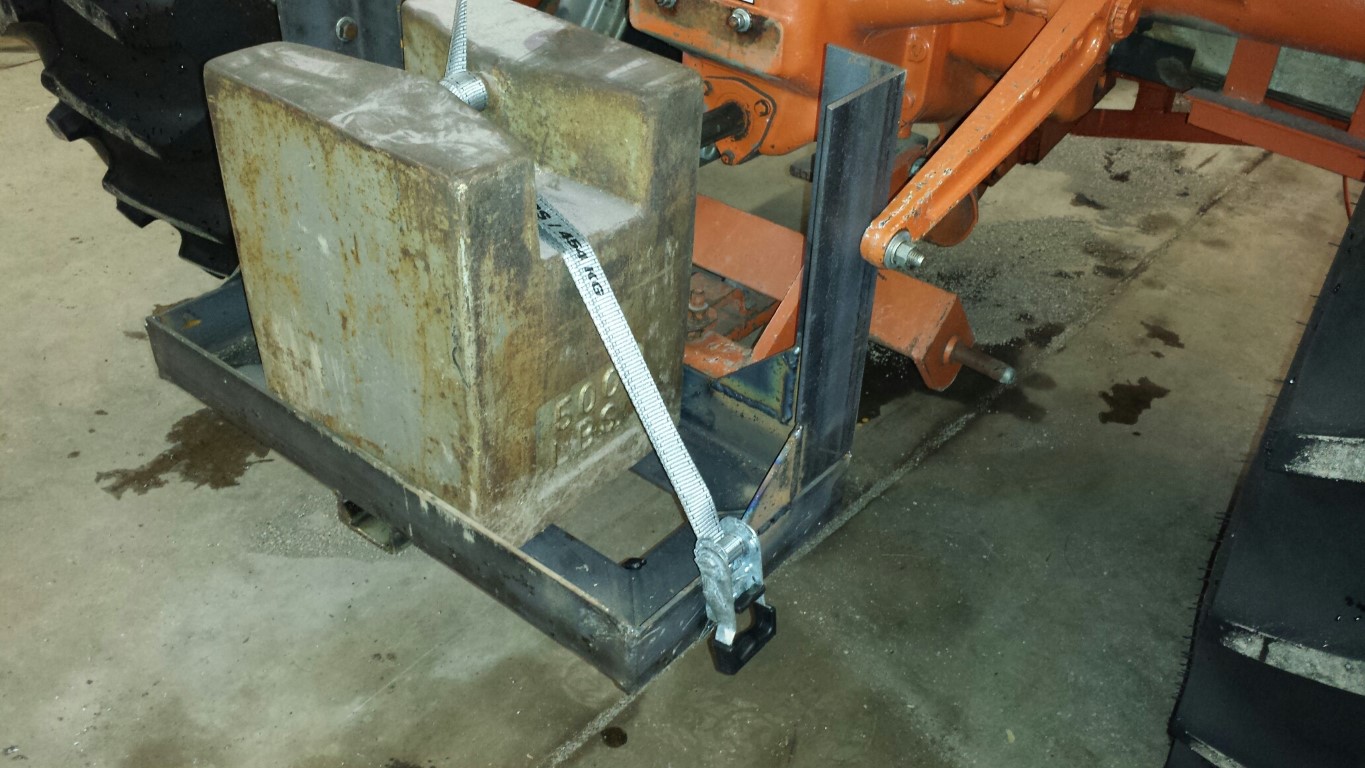

Posted By: OldSchoolRecovery
Date Posted: 23 Jan 2019 at 6:11pm
500 pounds.  Will make two wood blocks to take up space on each side of weight.  Powder coat this summer.  Might engineer a better hold down by then.

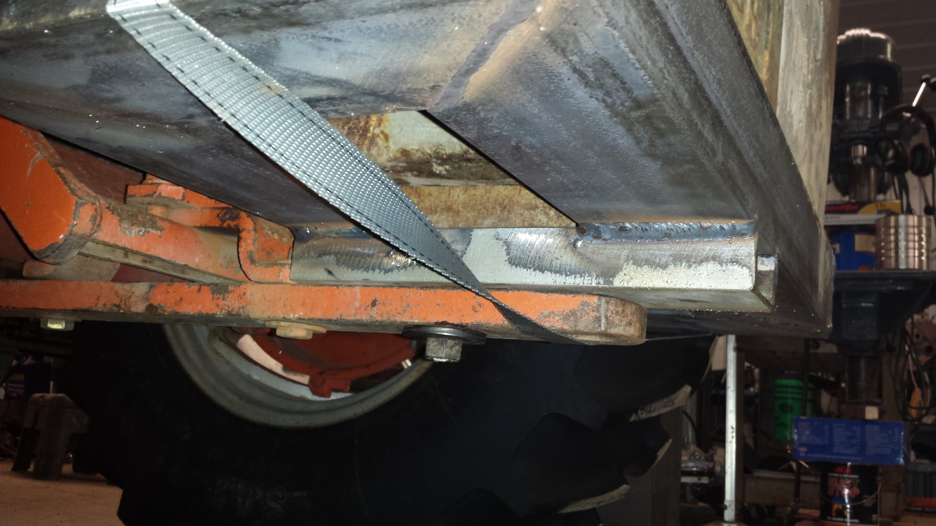

Date Posted: 23 Jan 2019 at 6:24pm
Bolted through hitch..

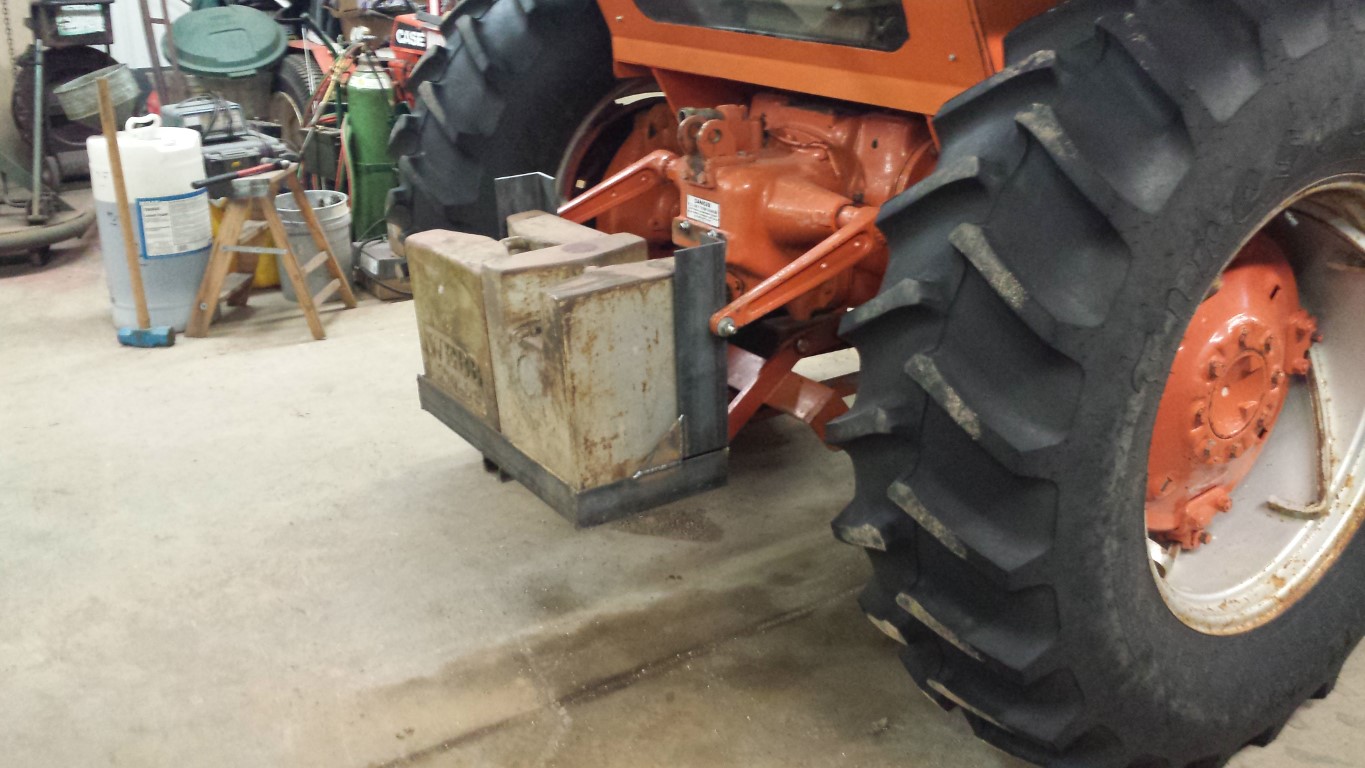

Date Posted: 23 Jan 2019 at 6:25pm
Standoff picture with two weights..

Date Posted: 23 Jan 2019 at 6:47pm
what a super setup! I like it!

Date Posted: 23 Jan 2019 at 7:01pm
I cant help but throw this out there. The throttle shaft is too long, but its a universal fit style, hence the threads all the way to the end of the shaft. Why don't you get out the ole hacksaw and shorten the end of the shaft? You shouldn't ever need the end there.
Date Posted: 23 Jan 2019 at 7:29pm
That is already done.  Plus, the choke rod was upside down.  Fixed that too.  I'll get a pic of the fix..
