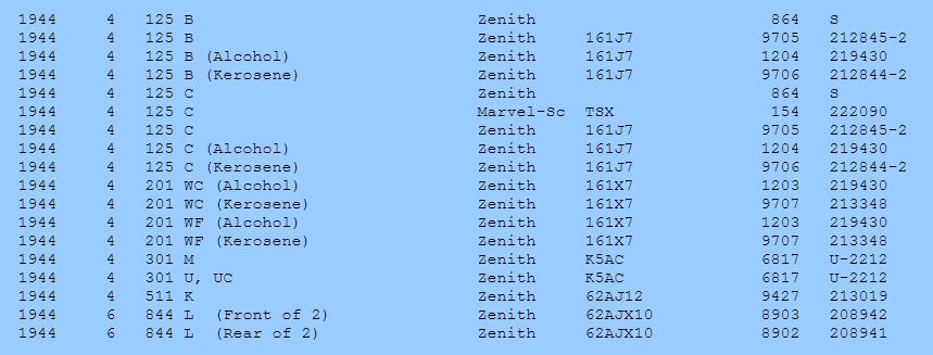

A 9707 is off a WC tractor.... Have seen that before... You may have to change the throat tube to smaller ... and change a jet to get it to run right.......... When you "CHOKE" it, you are cutting down on the air because the VENTURI is too large of diameter for a 125 cid engine  (WC was 201 )
I dont remember exactly, but im thinking on the B or C version, the venturi is about 9/16 or 5/8 inch bore ??  ......... see what yours measures.

from .."thecarburetorshop.com"  .............

Some of the popular B/C Zenith Carburetors are the 212844, 212845, 216937,224641,225621 or 622.  The popular Marvel Schebler Carburetors would be a TSX 154, TSX-305, TSX 470. The CA Carb usually was a TSX-486, or the popular TSX670. All should fit the B,C,CA manifold.  As Steve mentioned, that 9707 fits the WC, and WD equipped with the 201 engine......  HTH
