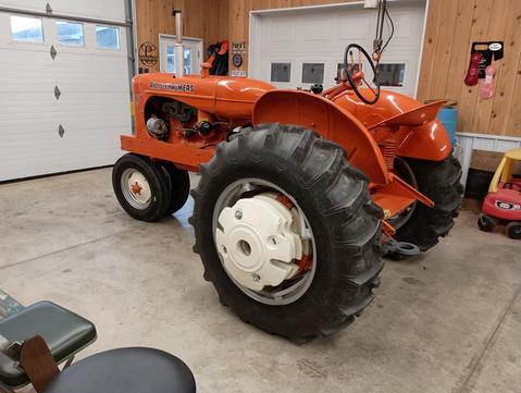

 I did get some additional details completed on the CA.

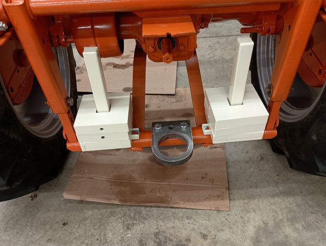

Since its a pulling tractor and we do now have weights available. Then we need systems to attach and secure them. Heaviest weight are the side engine weights at 90 lbs each.
The 12 IH rear wheel weights are approx 32 ish each, bolting to the IH rims.
I fabed these 4 stud extenders to add the additional 4 weights to the rims after the eight were in place. Just tacked at this point.-+
I wanted a D ring on each side to attach the tractor to the trailer. These were from Tractor Supply and were to be bolted the a trailer. I blacksmithed the attachment bracket to fit the tractor.
I was so happy with Rustoleum paint today. I sprayed a second coat of the cream on these and within minutes it went to cobweb texture. So much for all the cleaning and prep!
This is 1.5 sq tubing where I was mocking up a tube to hold the 200+ lbs of sq , 15 lb weights we have.
These flat sq weights can be stacked on these tubes. That should work.
All that playing around will get us in the 3000 lb class if desired. Or allow us to add some weight if the Great grandkids are driving the CA.

Heck of a concept reading the lable! Well I accepted the crinkle paint texture on the weights.
New seal in place for the PTO:
 old seal tapped out with a large socket
First day in bibs
Hanging out:
Weights added. The extensions worked well to secure the outer weights.
Engine -2 side weights. These are awkward to install.
 That 180 lb on the front should keep the front on the ground??
Cleaned and added an exhaust flapper rain cap. Sand blasted several of the 15 lb weights for the back of of the CA.

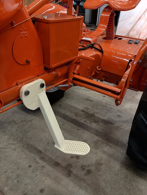

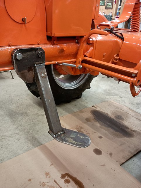

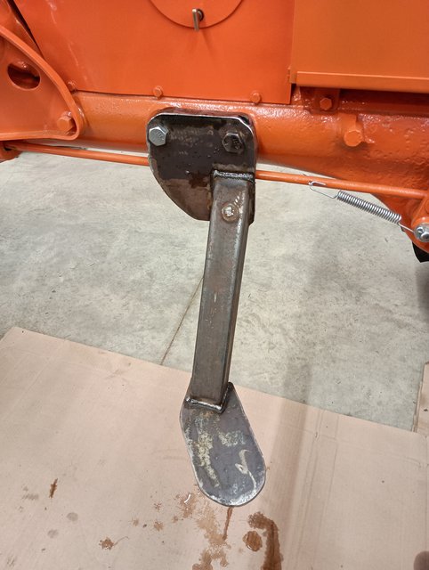

Allis did not have ergonomics at the center of the tractor design. So as I thought about this, I saw there were steps that could be added to assist old folks like me to at least start to get up into the seat. The designs I saw attached to the torque tube of the CA. I liked the idea. So to be cheap I chose to look through my scrap stuff and try to build a step.
I added my own design features (translate that into this was to cover up something or was just how the parts were that I found) as the design was prototyped. This cuts the step in half and seems like it may just work. Did I save anything if I count my time? Heck no! Did I design and build it out of nothing? Yep!

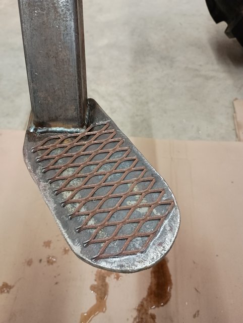

Mesh from Allis grill to add non slip. Let's paint it cream, just because we don't feel like mixing paint!
The step is not a bad idea. Will see how it ends up.

Points: 8647
Post Options Post Options   Thanks (0) Thanks(0)   Quote Sugarmaker Quote  Post ReplyReply Direct Link To This Post Posted: 08 Sep 2025 at 8:38am
Guys,
 I think I have all the do-dads on the CA. Time for a viewing!
This step turned out ok.
 Chris and Cheryl
