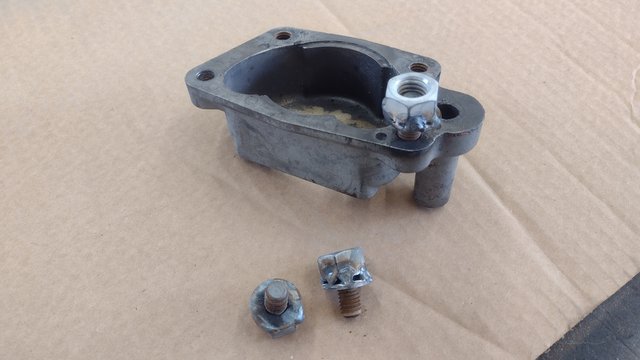

Re the busted bolts, try to beg, borrow, buy, or steal one of these, they're the cats whiskers of bolt removal!
A bolt buster, and a sharp pair of vice grips, and you should have them out, in about 5 minutes...Wink

I went old school and welded a washer to the broken stud, then a bigger nut onto the washer. The broken studs came right out.

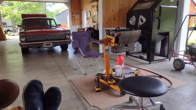

Our son Adam and friend John helped me clean the shop and work on blowing the CA apart even more yesterday. We moved the final drives to another rolling cart. I like to try to have all the heavy parts on carts for moving them around and under the jib crane.
We set the rear end on to a bigger cart and then removed the engine. It was nice to have helpers!
I will get the pressure plate, clutch and flywheel removed for inspection:
Next i will get it on the engine stand, remove the pan, and rotate the block to inspect the bottom end. Probably will pull the caps and inspect bearings.
Small moves, but it also allows us to use the drive through portion of the shop if needed.

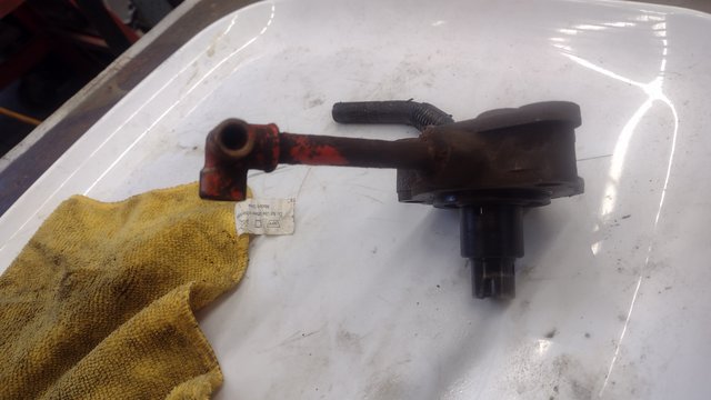

Well not much happening on the CA. Have not heard from the machine shop on the head refurbish.
 Did get a new throw out bearing assembly from Sandy Lake.

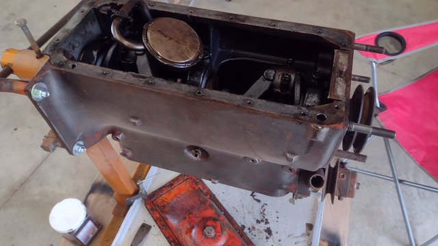

I did accidentally drop the CA engine as I leveled it to place it on the engine stand. I guess I had too small of bolts in the block. It missed my foot and Ruby. The lower left stud was bent. I got a replacement stud from Sandy Lake.
I also ordered a valve kit for the head rework.
Have a new 4 puck type clutch disc.
I want to get the pressure plate and flywheel resurfaced soon.
I have not opened the engine yet.

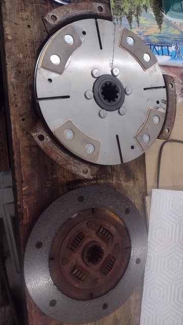

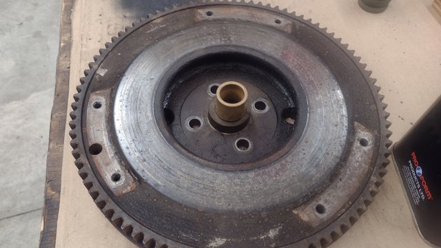

 I dropped the flywheel off for resurfacing today. Also told the machinist to please replace the freeze plugs in the head.
Then we traveled to Sandy lake Implement to get a new clutch disc, the standard kind, and a pressure plate. both had core exchange required. I was a little surprised that the pressure plate arms were very much out of adjustment compared to each other. Like by 3/8 inch. I guess all these details are now up to the customer.
 I did also buy a complete gasket kit for the CA refurb.

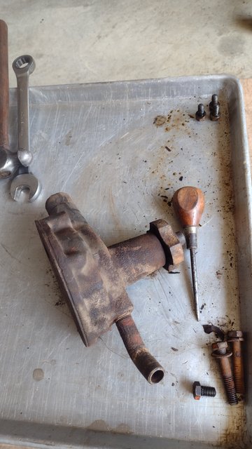

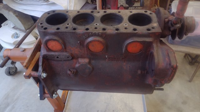

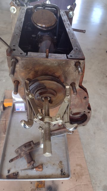

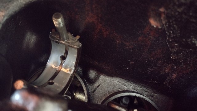

At home I took the front crank pulley off. Also checked piston #1 rod clearance e with plasti-gage. it was .001 to .0015. Then checked the front main clearance. It was about .003. There is a shim of some thickness on each side of the main so I may re check if they are peel off type shims. I plan to check all the rods and mains while i have it upside down.
The cylinder walls look very good. I didn't check any dimensions on the bores.

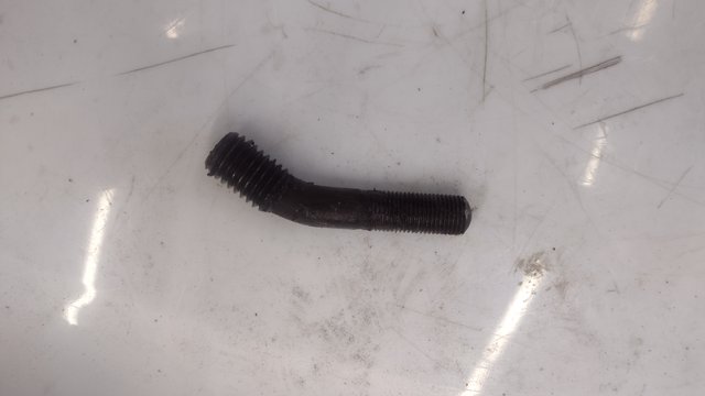

 Taking a little break I did have some various pictures to add. I am making some small moves on the CA project.
Cleaned the old gasket material off the top bottom and front of the CA block. All the clearances in the rod caps and mains seem to be good. visual on the crank and caps look acceptable. The tractor ran fine when I pulled it, and ran it around the yard too. So at this time I do not plan on a complete rebuild.

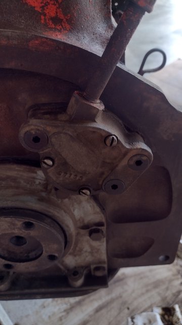

Oil pump removal was not bad. Just need to open and check it out.
The 4 puck clutch, that I now don't plan on using:
old pressure plate, (did get a new one of the same old style with the springs)
as mentioned flywheel is in shop for resurfacing and new pilot bushing to be installed.
block on stand was a long time coming:
Was very lucky this was the only damage when I dropped the block on the floor:
water pump off:
Pulling the crank pulley:

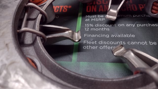

I need to adjust the new clutch fingers to be about three credit card thickness from a flat surface under each finger.
Most of the time I just age the CA project. I need to get the great grand boys working on it too! Many moves to make on it. I would like to take a look at the Ross steering box also. I think it could use a good refreshing. I need to get the E-tank set up again for cleaning parts too.
 Chris and Cheryl
Edited by Sugarmaker - 04 Aug 2024 at 7:31pm

Sure sounds like you have an engine that's in decent shape. I am never that lucky. Can't wait to hear how you do pulling with this tractor.
