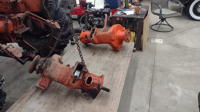

We have the left final drive cleaned of grease and grime and set aside:
Have the CA supported on both sides:
ready to pull the right rear. Brake pin design on the top is awesome! Brake shoes on the right side were junk, Brake drum on the right is in pretty good shape, so I do not plan to change that. The seal in the differential has been replaced.;

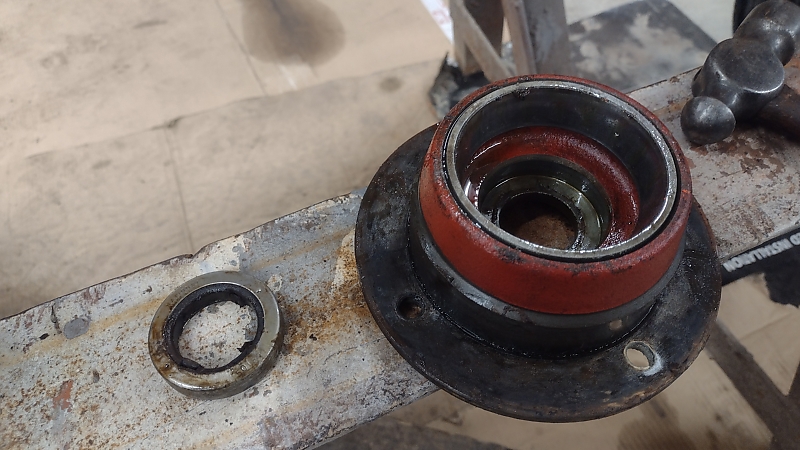

This is what these old brake shoes look like, not good at all:
Pulling the right final was easy:
Remove the cover from the right side of the rearend:
Pop out the old seal and install the new seal:
Sealant on the bolt threads

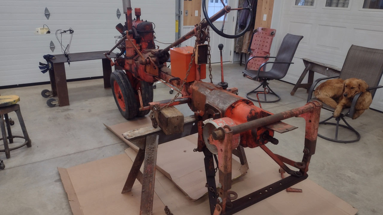

 The CA is back in the middle of the main bay in the shop. Right in the way. I should be out working on it. Being lazy! The weather was warm enough to mow the yard a couple days ago, then back to cold and snow!
 Syrup season is done for 2023, Thoughts turn to old tractors and my old truck. Car shows coming up soon, along with cruise-in events.
So the CA, Well it is still apart. I did order some paint for it which I hate to say will cost as much as the tractor. But I do like to see them freshened up. So this hopefully will be a Refurb, Clean and Paint project. Will it be ready for prime time this season on the pulling track?? Time will tell. I will try to get some pictures posted.
Here is Ruby my helper:

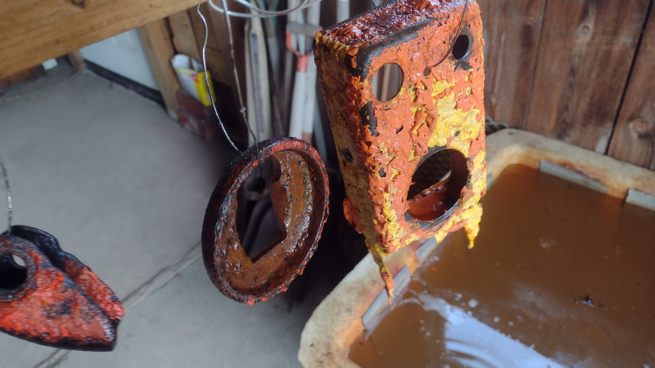

 I did get the E-tank operational. Part #1 came out yesterday. the right brake pedal casting.
It removed 95% of the rust and paint. a little wire brushing to remove the black smut, and a good rinsing. Then a little wire wheel work to remove the stubborn paint areas. A wipe down with mineral spirits, and its ready to prime. Might get the primer/paint next week. Need to set up a paint area somewhere to reduce the mess.

Many many parts to clean. The electrolysis tank is working around the clock. Today the hood is in the tank.
Here are some parts being removed. Yes this does remove a lot of the paint too!

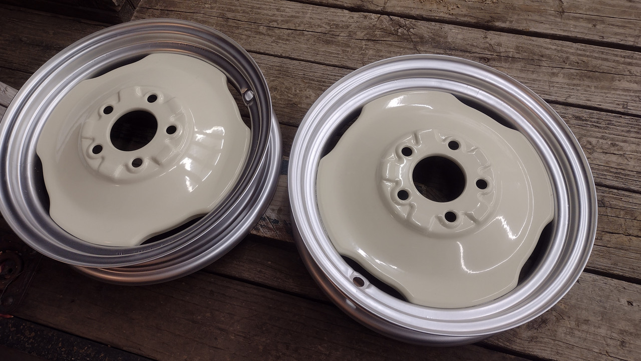

I cleaned up old the front rims for the CA. They were not good! Ordered and new set from Sandy Lake.  Painted the rim rusteolem silver, Have new 4.00-16 tri ribs mounted on these. Just have to go get them.

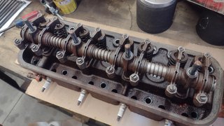

Pulled the head off the CA to get it cleaned up. Decided to have a valve job done. Nothing broken or bent or missing, and the engine ran ok. Just feel its the right thing to do if the great grandkids are going to pull this tractor someday!
I broke off three of the 4 bolts in the lower waterneck. Yea the steel screws in aluminum housing! Galvanic corrosion set in. Hope I can get the remaining portions of the bolts out? Might have to find an new part?
Will probably pull the engine off the torque tube also to take a look at the bottom end of the rotating assembly. Also to look at the clutch and pressure plate assembly.
