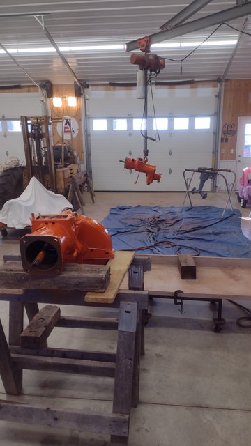

We have a new project in the shop today also. Friend John brought his 46 Ford Super Deluxe four door, over to work on brakes and new wiring. That should fill in the gaps to keep us up and moving, if we run out of Allis projects.
I shuffled Allis tractors in the small shop today. Only have 6 tractors in there! Got the snow plow blade on the D14. We are ready for winter!

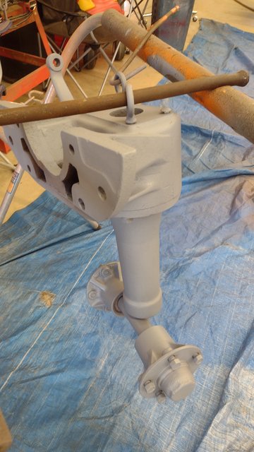

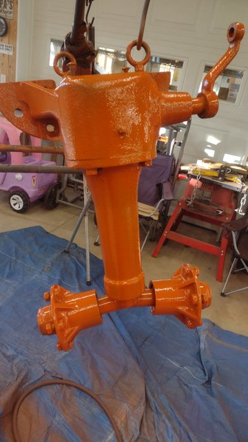

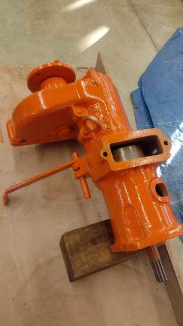

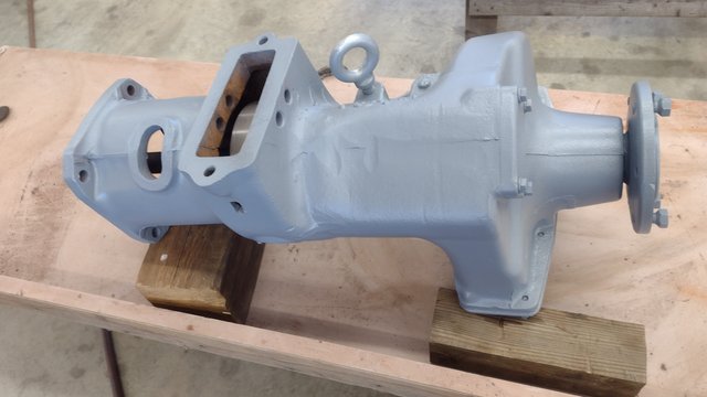

As the weather cools down in our neck of the woods, I decided to paint primer and top coat on the final drives and the front pedestal.
I did get them painted. Waiting for paint to dry.

Dan, Folks,
 Thanks! Some additional shots as the paint was drying yesterday.
More small parts cleaned and sand blasted today. Also putting the IH portions of the wheel weights through several sessions in the E-tank.
I may go look at a couple CA tractors up in Grape country this week. Friend John's dad has a large collection with some CA's in there too.
Having this shop sure helps me get some things done easier. Not having a dedicated paint area is a problem, but we just keep going.

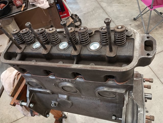

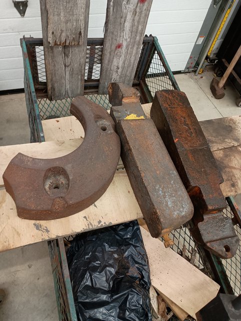

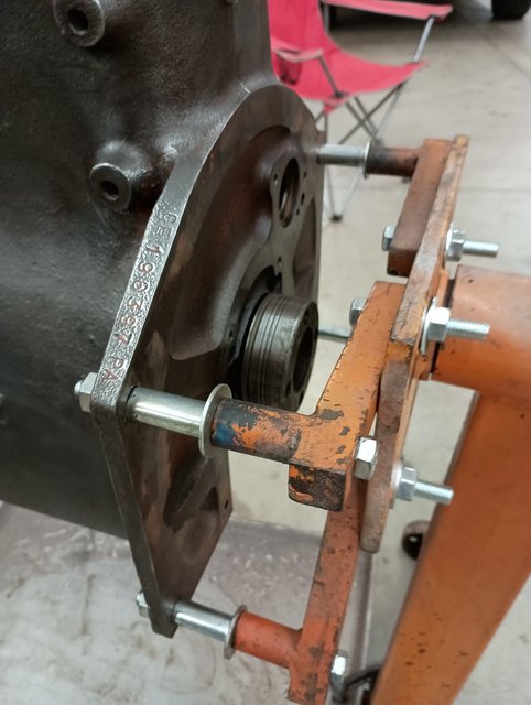

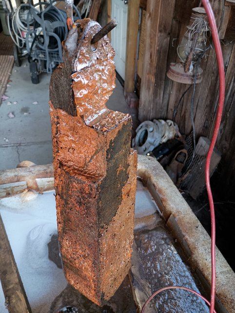

 I am going to try to space the engine out a inch and a half more on the engine stand to try to get the oil pump on and the rear seal inside the aluminum plate in place. I assume I need to oil the felt seal on the rear of the crank as it is installed?
I could just set this block on the table but would like to flip the engine to install the pan gasket and pan too, so if I can keep it on the stand that would be an advantage!
I just put the second side weight for the side of the engine in the E-tank. Not sure if I will use them but it keeps the tank busy and the paint just falls off in big chunks.

I was surprised how well the e-tank would assist in paint removal. Discovered that when cleaning the PA wheel clamps. Speeds up time in the blast cabinet as well.

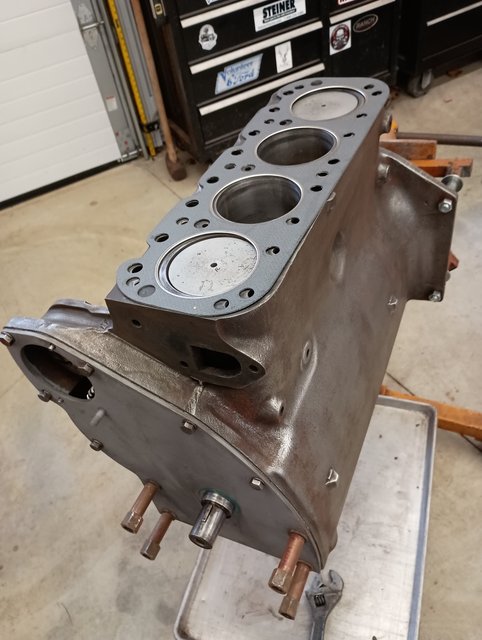

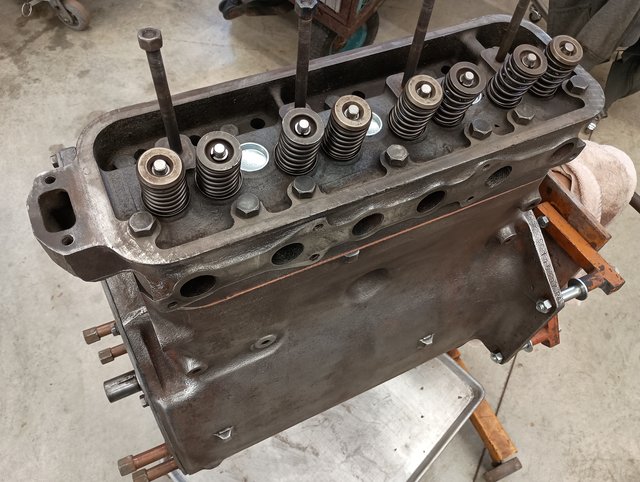

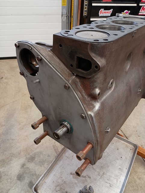

Allis folks,

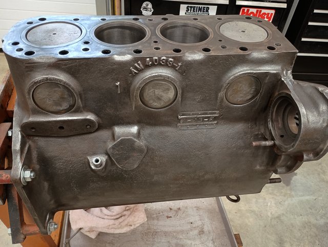

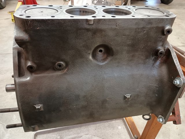

Cleaning the block:

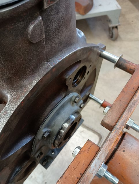

Spaced the block out on the stand to work on the rear seal:
Added the  cam spring and spacer then front plate and the seal:
Then the rear seal (oiled) and new gaskets:
Next parts to be cleaned up:

Looks great Chris! Love a nice clean block ready for primer and paint.

 Mike I used a half roll of paper towels and solvent and dirt was still coming off the block. At some point it will just be enough.

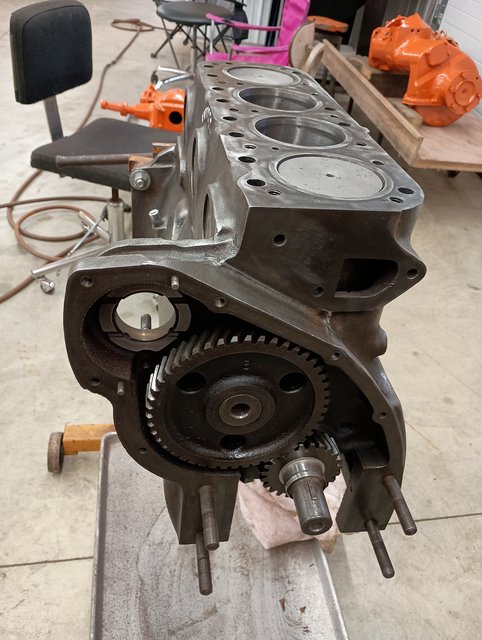

 Realized the front cover for the governor used the bolts and the pins on the front cover. So some of these items may get added prior to paint work. But I needed to tighten that gasket down so it worked ok. Also on the lowered studs I put some 1.2 inch copper spacers and the nuts to keep that gasket tight also.
Trying to get a little done each day on the CA. Some days not so much. Got the Copper gasket spray for the head gasket. Installed the head and torqued from the center outward. Cleaned up the housing for the distributor in the blaster.

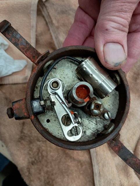

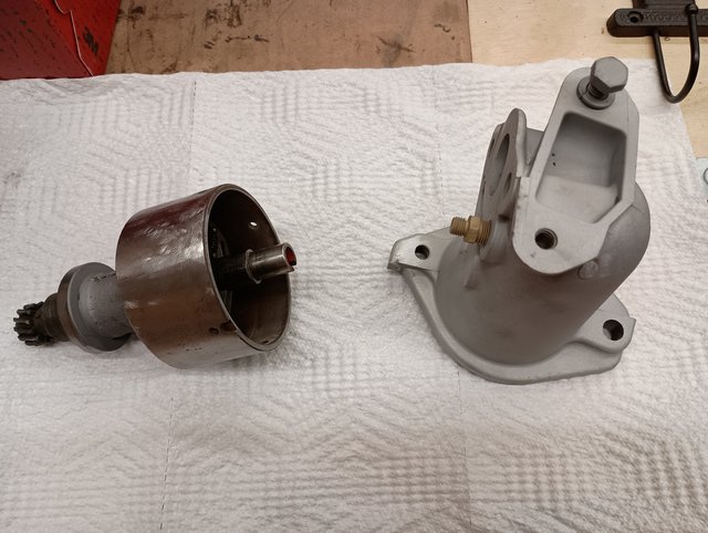

Cleaned up the distributor and the base. Just lots of details. Will put in new points and maybe a condenser?

Might be better to clean up the existing ones, given the extremely poor quality of modern replacement electrical parts!

 Good suggestion! I just might do that on the points. They did not look that bad. I need to spend some time cleaning fasteners and small parts. I need too build a poor man's paint booth for a bunch of these small items.

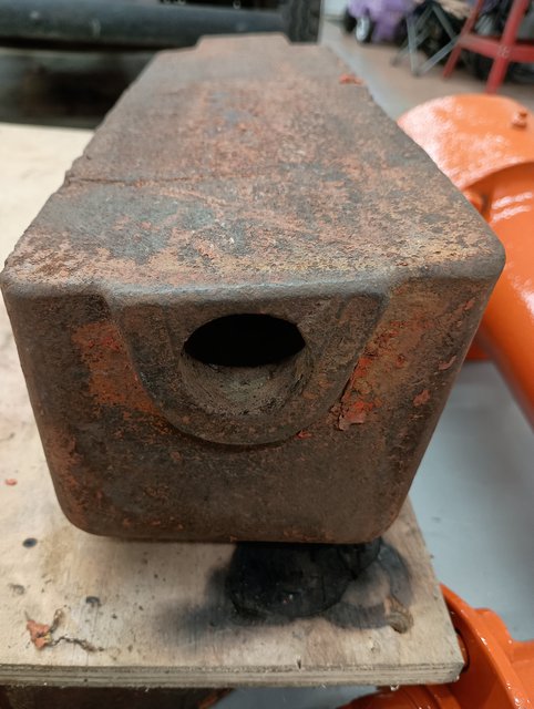

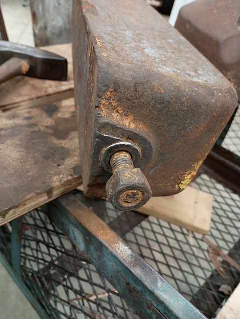

So the side weights on a CA. I assume this plug is supposed to be bolted to the front ear of the tractor? This one is stuck and will need some encouragement. The other one is missing. Are these available?
Tonight I added the front governor gasket and cover to the front of the CA engine.

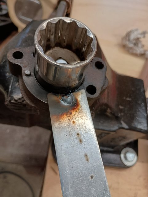

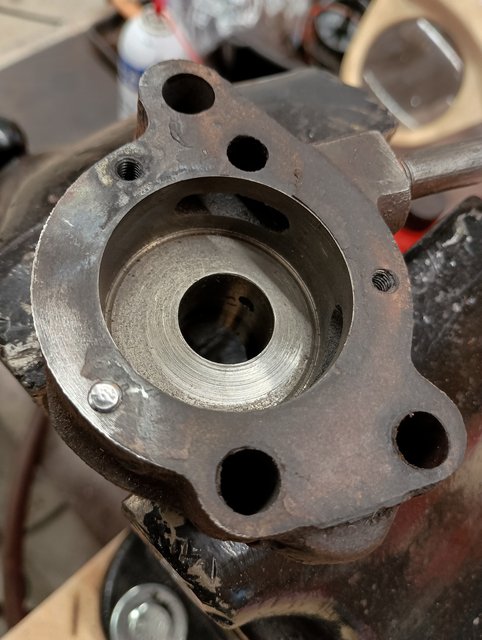

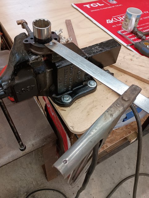

I decided to review the oil pump. After starting to open it up, I realized it was going to take some more work. Two of the three screws broke off, with about 1/8 inch sticking out of the oil pump housing. Yikes this is going to take just a little bit of noodling! I decided to try welding something to the top of the remaining screw protrusion. John gave me an idea to use a large socket to fill the oil pump cavity during welding. I added the electrical tape. This was to keep any splatter out of the pump cavity.
I usually do the washers with a nut welded on top, but decided to scale the concept to a counter sunk hole in a 1/8 inch strip of steel.
First two times it failed, and broke the weld.Went to the other broken one, This  time I brought out the blue tip.
Heated the housing at the screw location. Bingo the screw came right out! Back to the shorter one and the same process worked to remove it too.
