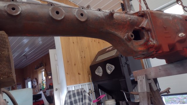

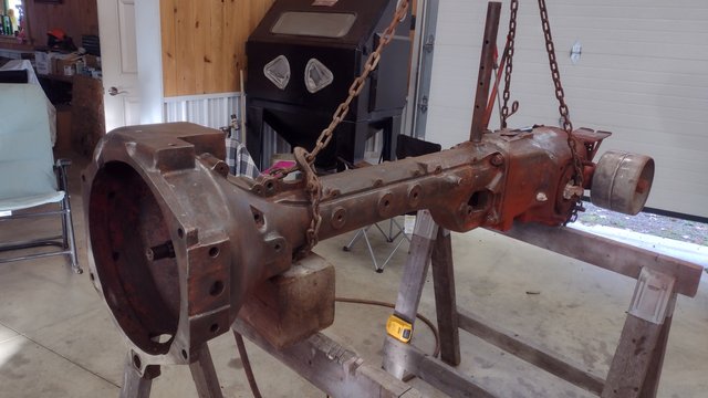

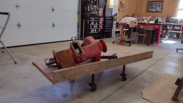

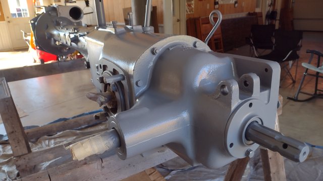

Yes I guess we are at that level of this Refurb, Clean and Paint process. I did not do a complete new kit for the engine. Most of the engine components looked pretty good. So maybe saved a few dollars there?? Just a freshened stock HP CA engine. Which means we should see what they were capable of when new. Lots of other tractors in the 2500 -3000 lb classes have mods that may increase horse power? All that spends more money and not sure we would have any more fun?

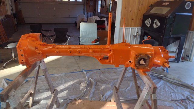

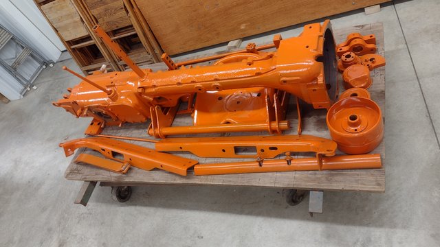

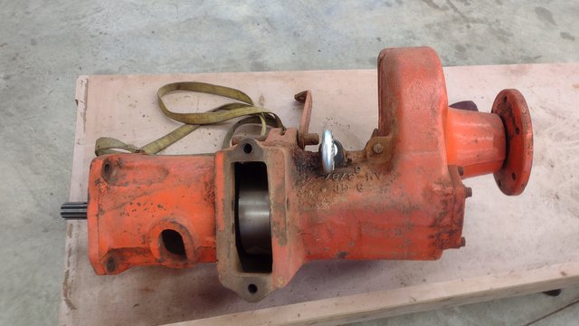

I worked on the torque tube today:
Hope to get the transmission and rear end cleaned up tomorrow?
I did get the oil ring for piston #1 today. So will try to get that and other components installed. Was able to sand blast some CA parts and get them ready for primer soon.

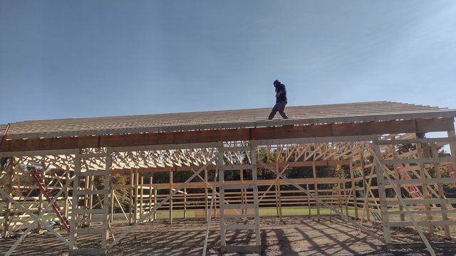

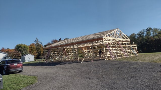

I just did not get much done today. Helped supervise at Grandson Nic's new building. The crew and helpers have most of the girts on the sides and purlins on front trusses. Tomorrow the rear roof purlins and the lean to rafters portion will be set in place.

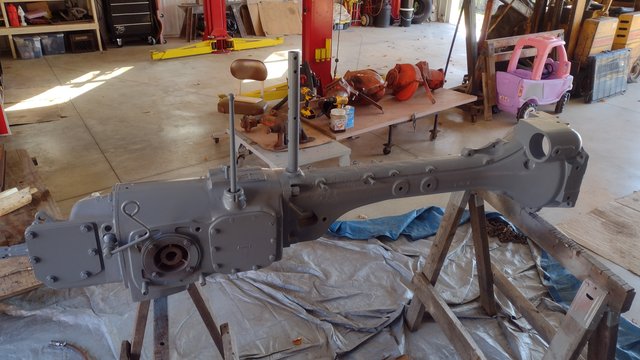

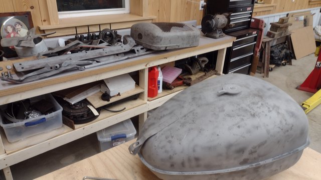

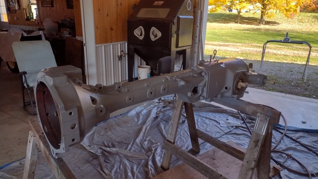

Allis Folks,
 Some items are coming together on the CA. Maybe we have turned the corner??

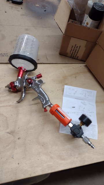

Things change, First gun I have had with the disposable paint cups. Just ordered a bunch of extra cups as this may stretch over several months or longer?

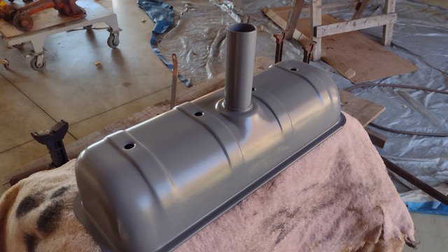

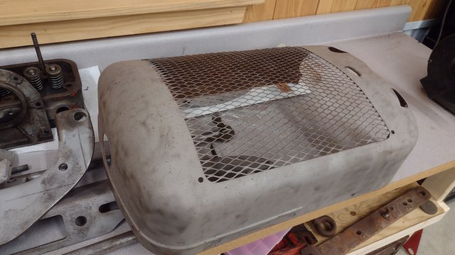

The tank has at least one dent that will need to be filled and sanded. It has been repaired once on the underside. I sandblasted it after it had been through the E tank.
I do have a bunch of parts that are pretty close to being painted.
Some body work will be required to the grill shell and the other sheet metal items.

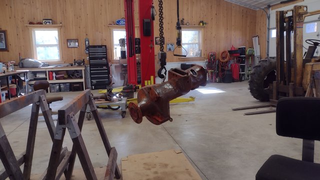

The torque tube, transmission, and the rear end have been setting in the middle of the shop for several weeks. I have kept going around it cleaning and more cleaning, chasing threads, and more cleaning.
I couldn't take it any more and mixed up some gray epoxy primer. Felt good to lay on some paint!
The cleaned valve cover got in the way and received some attention also.
Might as well try some PO#1
I hope these small steps get me going on the CA project again.

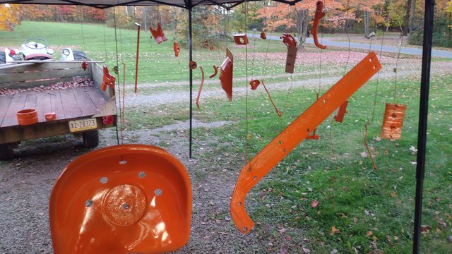

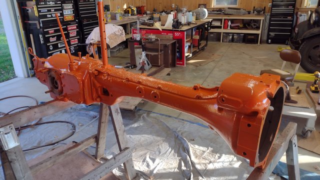

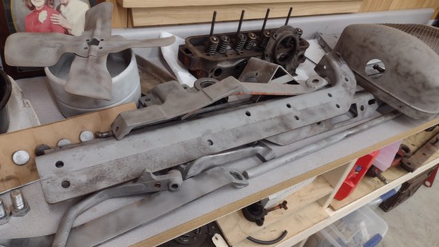

Allis guys,
 Thanks for checking in on me! Our weather has been great so I took advantage of it today and painted some of the small items. Using a single stage PPG paint system for the top coat. 4 parts paint, one part catalyst, one part reducer.
This was a sticking point in my mind about painting in the shop. I moved the important cars and trucks outside, put down a old tarp and just began painting. The HVLP guns seem to keep the over spray to a minimum. I did not have a 'tarp line' on the floor afterwards.
I really like these disposable paint gun cups. The soft liner collapses as the paint is used and there really is minimal clean up.

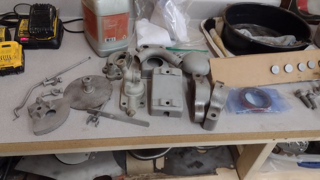

A lot of these CA parts had been cleaned ( blasted) for a while so there were about 40 items. I wanted to get some paint on them to avoid surface rust on the bare metal.
My make shift paint booth was set up outside the east door of the shop. The epoxy primer was applied and about 1/2 hour later I painted the orange. After it dried I see a lot of places that I did not get the coverage i needed in some spots. ( but it is probably better than from the factory!) These small irregular parts are not the easiest to cover. And I was probably rushing a little too. So they may stay that way? Will see how bad it bothers me. I did not see any runs or sags so maybe there wasn't as much paint going on as I thought?
A 10 x 10 easy up was the outside paint booth/ shelter. It made a great place to hang the smalls too. Yep the orange wind chimes!
A couple of the larger heavier rear hitch parts got some attention also. It doesn't look like much but I was whooped after setting all these up and trying to get paint on them.

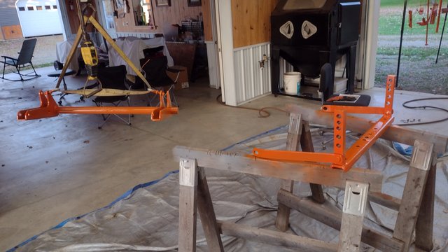

Allis folks,
 After reviewing the parts they needs more paint. I applied another coat to most of them today.
Ordered final drive pan gaskets from Sandy Lake today. Not looking forward to that project.

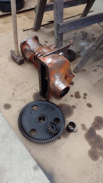

Post Options Post Options   Thanks (0) Thanks(0)   Quote Sugarmaker Quote  Post ReplyReply Direct Link To This Post Posted: 24 Oct 2024 at 7:43pm
Guys,

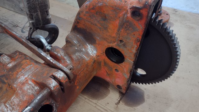

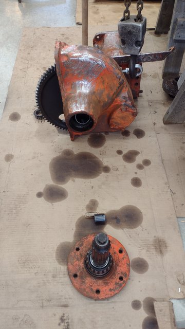

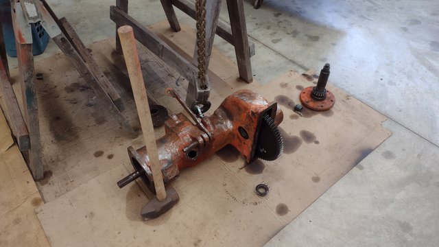

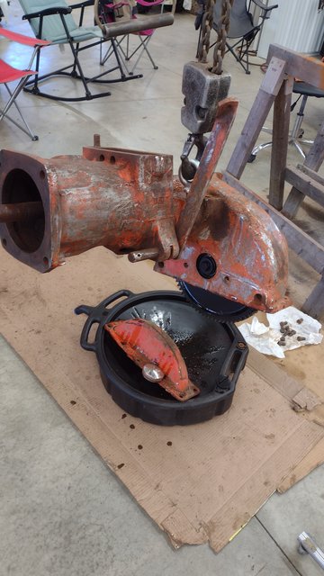

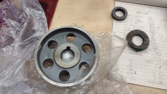

 Well John and I worked on the final drives and the front bolster. mostly cleanup. Moved a bunch of things in the shop to get some room and moved these heavy items under the jib crane. I removed a broken bolt by welding on a washer then a nut on one of their final drives. It will make a good balance picking point to install the drives to the rear end.

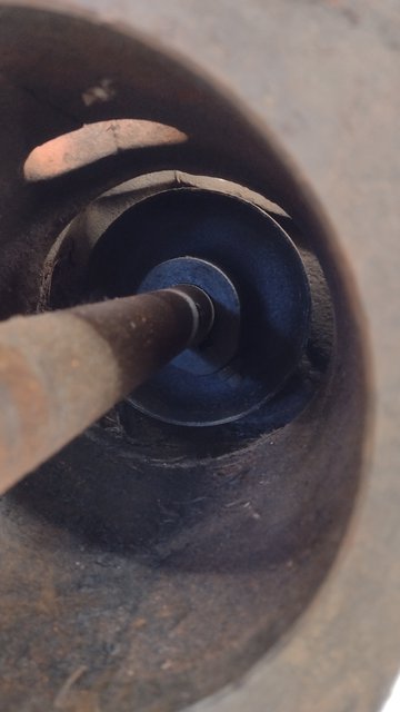

Ok couple of things. The brake drum that I did not change out is about 1/8 thick or less, compared to the new one that is a 1/4 in thick. I really don't want to replace that old one but now would be the time to do it. Suggestions? This one is a little ragged on the edges also. Do these drums hold up well when they are this thin??
I pulled off the pan and removed the cap and bolt holding the axle in place. But the axle would not budge I took the snap ring off the axle, I hate those and this one was no different. After smacking the bolt in the axle several times and repeat. it was a no go. Seemed the axle and one of the bearings had grown together?
 I put the snap ring back on with two screw drivers. Not a easy task.
So I guess I am not putting a new seal in that drive!

Points: 8647
Post Options Post Options   Thanks (0) Thanks(0)   Quote Sugarmaker Quote  Post ReplyReply Direct Link To This Post Posted: 25 Oct 2024 at 8:10pm

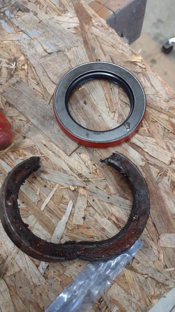

ACinSC, folks,
So today I reviewed several you tube segments on the Allis CA axle removal. With a new day and friend John over helping spur me on I decided to look at these axle seals again. The key was to use the 7/8 socket over the bolt to beat on the axle shaft with a BFH!
Before I got started on the bull gear axle I took a review of the brake drum that was not in great condition and quite thin in areas. Several hammer blows, breaking chunks out of the old brake drum, and I was on my way to install a new brake drum in the near future. While whacking on the old brake drum it moved on the shaft and damaged the seal behind the brake drum. So good and bad news. I then heated the hub of the old brake drum and was able to pry and move the broken hub off the shaft.
I ordered a new brake drum and upper inner seal from Sandy Lake.
Then turned to the axle, removed the snap ring again. set the unit on the floor and used a 8 lb sledge to move the axle out of the light press fit in the inner race of the smaller inside bearing. None of this is for the weak of heart! Brute force and awkwardness is the norm here.
The goal here was to change this outer most lower seal on the finale drive axles.
Once that axle is out the large bearing has to be removed before that seal can be installed. I used crude tooling to remove that bearing. Basically a small block of steel between the bearing race and the flange which the wheel bolts to. Then just hammer the block of steel till the bearing begins to move. Beat and repeat!! I did cut the old seal off the axle first. I found that there was a worn spot from the old seal. Humm. cleaned it up and hoping the new seal rides in a different spot on the axle!
Hope to spend some time on the other side of the tractor to be prepared to put in a new outer lower seal also.
By the way if you have been working the numbers on this project, this is how to take a $800 old tractor into a $3500 old tractor. Must be something wrong with me?

 Thanks! my phone is on the fritz, so no pictures. I did get the other final drive opened up.
Same thing, I had to use the sledge to tease the axle out of the smaller inside bearing race. Now there is a lot of clean up to do, then that side could be put back together.

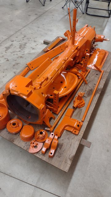

Guys,
I try to do just a little every day on the CA. Today the rear final drive pans went into the E-tank. I started stripping paint on the final drives. Chased the threads for the pan bolts. Removed more layers of orange and cleaned the old gasket off the bottom surface for the pan to fit up. Got side tracked with some Colorado Kool Aid, then a nap, and then took the wife for a ride in the 65 Comet.

 The CA is home and have done a few mods on a couple things. You know the new toy syndrome!:)
Exhaust was the first thing to come off. This may not be final:

Allis folks,
My friend John has been helping clean CA parts. He brings his cars over and uses my shop and lift.
So we got the finals up on a table and used paint stripper several times and just scraping and wire brushing to get these free of loose paint. Had about 2 coats.
Got the new brake drum today but the wrong seal next to the drum. So that wont be put together for a couple days.
Rolling these over several times to get all the nooks and crannies.
I did get the axle, bearings and final drive seal assembled on one side. I used the fine thread bolt to pull the axle into the bearings which are a light press fit. The axles were cleaned in the E tank then tough paint removed with an air grinder, then sandblasted for final clean up. Chased the threads for the pan bolts.   I still don't like the snap ring install. I was lucky a neighbor stopped by and helped me with lighting and screwdriver work to get that snap ring in place. I don't like those!
The weather is going to be nice, warmer. I hope to get these bigger parts painted in the next week or so.
Thanks for checking in on me.
 Chris and Cheryl
Edited by Sugarmaker - 28 Oct 2024 at 8:02pm
Points: 5266
Post Options Post Options   Thanks (0) Thanks(0)   Quote PaulB Quote  Post ReplyReply Direct Link To This Post Posted: 29 Oct 2024 at 7:36am
There is special type of snap ring pliers that makes removing and installing that type snap ring a breeze. I have a pair
