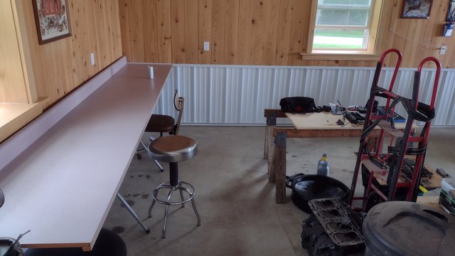

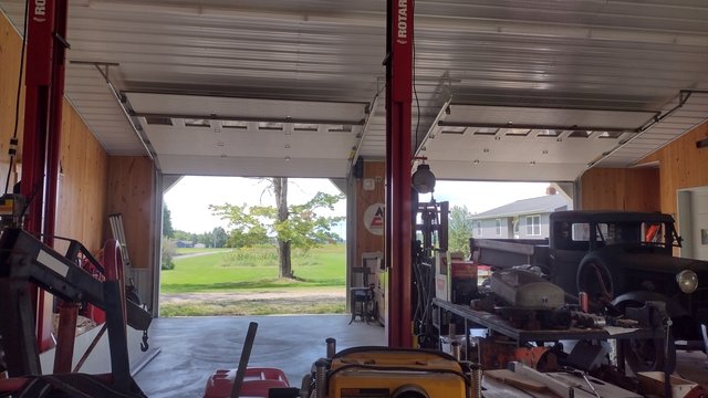

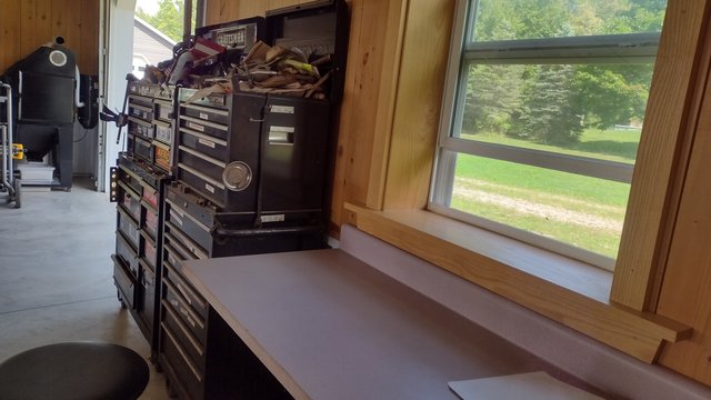

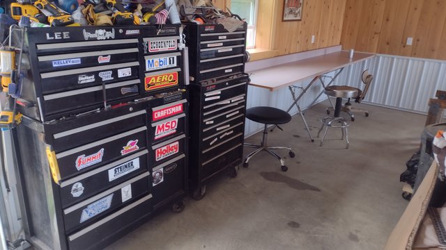

Also prototyping an area in the shop to finally set up some work benches, tool boxes, and storage areas. This should help get some projects moving along quicker, maybe?:) So I need to build support structures for the 24 feet of new old work benchs. Also brought my old craftsman tool box from the house garage to compliment the larger craftsman box given to me by my grandson Mike. So my cost so far is about zero. I will have to buy some lumber for the legs.
Yesterday I had the sandblaster where the toolboxes were. I had to relocate the dust collector on the sandblaster to the back allow it to go back to the other side of the garage door. Just another minor job to keep moving forward. No I didn't clean the top of the tool boxes off as I moved them! It's my trademark.
My view from the new bench, work area. I plan to wrap around the corner with another 12 feet of bench along the south wall also. Planning for just some shelving under the work surfaces too. Then I should be able to move my 4 x 7 foot work table into this corner as an island. Will this help me move along on the CA? Well its is a good diversion and much needed in the shop. Like any horizontal surface my areas get filled quickly with stuff! All kinds of stuff!

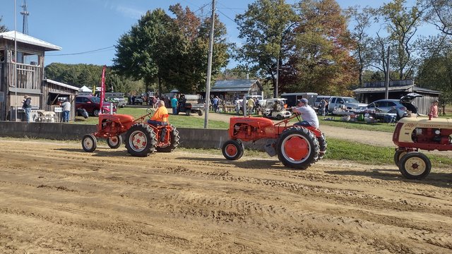

We spent most of the week at the Albion fair about 2 miles from home. I took 3 tractors, and a neighbors. All WD series tractors. We pulled Friday on the cement. Neighbor won the 3500 lb class. Grandson Mike pulled the WZ in the 3500 but the right rear spun out way early. I pulled the 45 in 5000 lb and was smoking the clutch when it moved the boat and I spun most of the way to a full pull. More weight and I only pulled 1 inch and then 4 inches. class was won at 8 inches.
We pulled on the dirt track Friday night with lots of good competitors. Non of us placed in this "farm Stock pull. Lots of pretty warm tractors!
Saturday was antique pulling. I placed 4th in 4000 with the WZ. Friend Matt pulled my 45 and was second out of 19 tractors. Not too bad.

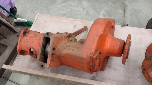

I have a short arm gearbox arm if you need it. I purchased the wron part from EBay and can’t return. With a short arm on the gearbox and long on the steering sector it steeers real easy just can only turn about 20 degrees.
Points: 8646
Post Options Post Options   Thanks (0) Thanks(0)   Quote Sugarmaker Quote  Post ReplyReply Direct Link To This Post Posted: 27 Sep 2024 at 7:07pm
Dave,
 I have a short arm on the front and long arm on the gear box. So that should work as you mentioned.  Thank you for the offer.

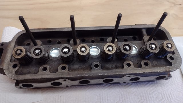

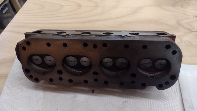

Got a call from the machine shop and the CA head is done. Will pick that up in next day or so. Have most of the parts to get the engine together in a week or so.

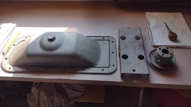

Have just a ton of cleaning to do! Almost forgot body work on every thing, primer (a lot) and then paint! Then some assembly required! Yikes!

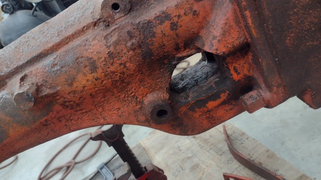

Have the rest of the big parts uncovered. I see some oil at the rear seal areas. Probably need to tear into that also?

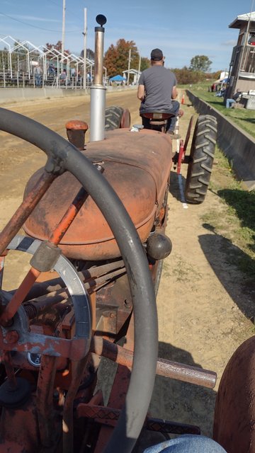

Well I played hookie and played in the big sandbopx yesterday at our local tractor pulls. Cheryl was with her sister so I was able to pull in 3500, 3750 and 4000 lb class with the WZ. After several pulls this year the WZ is not preforming as well as I expected. First class I went off to the right on some unused track area and end up 9 place out of 12 pullers.
 3750 I lowered the speed stayed in the used part of the track and came in 6 out of 11.
4000 Stayed at medium speed in the used portion of the track and finished 4th out of 11.
My friend Jim on the Cockshutt 20 in the 3000 lb class. He has a 40 in the 6000 lb class also,
I think my balance is heavy on the front of the WZ. Seems to do better as OI load up the rear. So I may need to rethink the classes for this unit.

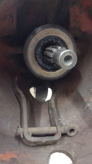

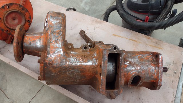

I am new to these. Is the throw out bearing pressed on to the sliding part? It looks like it

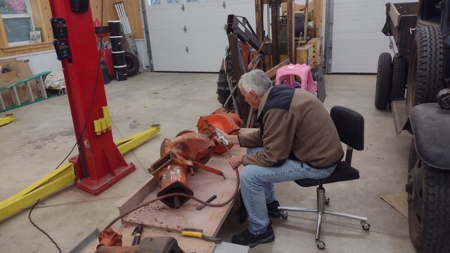

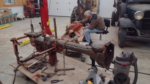

Friend John helped clean on the CA.

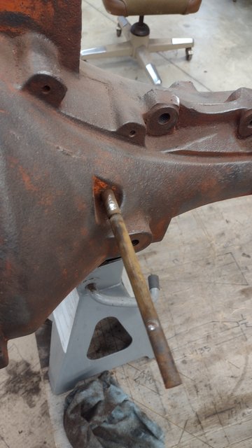

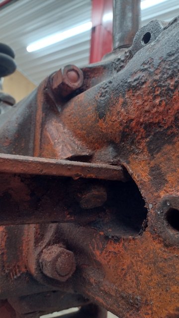

I pulled more parts off the skeleton of the CA:
Clutch pedal is very worn this tractor was used hard:

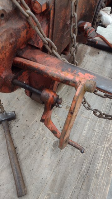

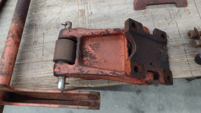

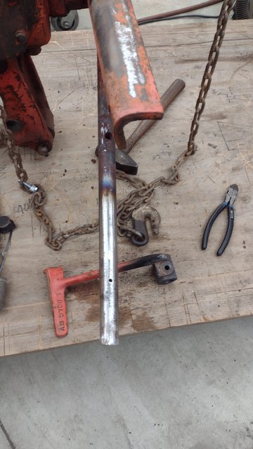

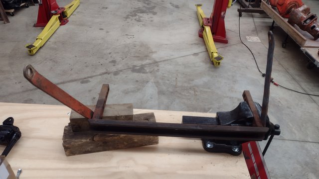

This is the cross bar that I plan to pull from. That's where the d-ring was attached before.
It's in the vice because the bar (black) on the right was bent like a pretzel. I did some crude blacksmithing to make it much straighter. Maybe not perfect. But it is a puller so it's going to have some blems.
Thinking of eliminating this swinging hitch and just come off the rear end down to the cross bar and mount the new d-ring right on the cross bar.

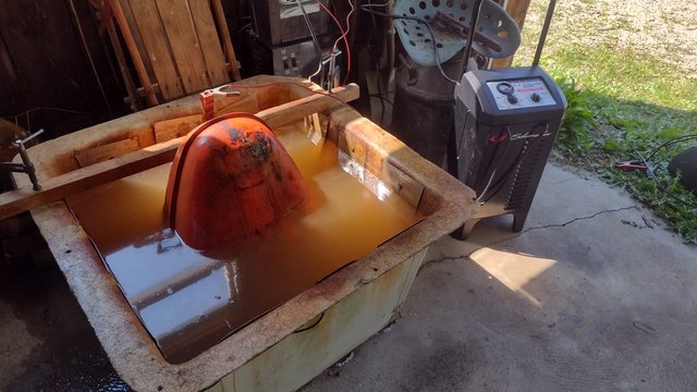

Will be nice to clean up this area through the torque tube. Just a bunch of monkeying around to get these apart. Some heat required to get the brake pedal off the cross shaft:
So the E-tank is running and cleaning up several items: I would like to have some paint on this even if it is parts in primer by Christmas this year.

Still picking and cleaning on the old CA parts:
Ordered new axle seals for the rear end. Probably the time to get in there and tidy those up as I do see some leaks on one side.
I helped John Kelley work on his 42 Ford rear shocks today, Then retrieved some parts from the E-tank bath. Those are ready to go into the sandblast cabinet.
I want to open up the Ross steering box and do an exam on that too.
Should have the new oil ring for piston #1 to be installed soon.
