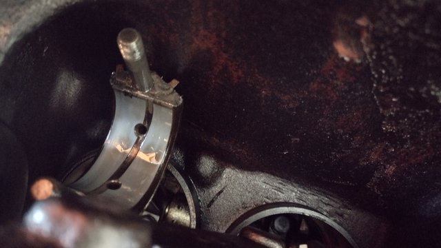

Thanks for the info on those pockets. I rooted around more in the pockets in the crank rod journals. and found they were just blind pockets. No oil holes. So I came to the same conclusion about the no pressure to the rods. Seemed strange, but I am not a CA guy and the old WD series does have passages to the rods. I cleaned all the junk out of those pockets to allow some oil to reside in there.
The plot thickens on the old CA engine. Cheryl and I traveled to Sandy Lake to return the puck clutch, and get some parts this morning.
When I got home I decided to check the thrust clearance on the crank. Way more than spec so I need to do some additional research as to options to bring that back closer to spec. It was .017 inches, the spec is .001 to .005 inches. yikes!

You could probably get away with just replacing the 1/2 main bearing that is the thrust half. I've done that many times with a NOS bearing that I had on hand.

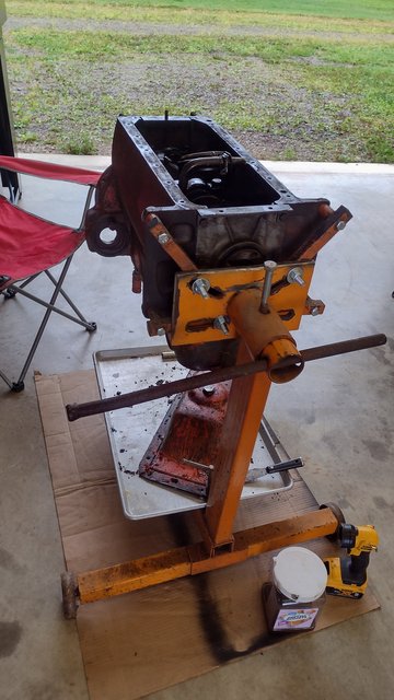

I am going to clean the block or take it to be cleaned. All the tapped holes in the block have been chased and cleaned out.
The electrolysis tank needs to get set up again to help clean some of the engine items, like the pan and the front cover. I did get the new stud installed in the front of the engine, replacing the bent one (from when the block fell on the floor).

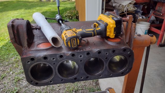

I did get the CA cylinders honed, Much better. Also did some cleaning on the block. Cleaning pistons, thinking about cams. I did fire up the E-tank and have the CA oil pan in there for cleaning.

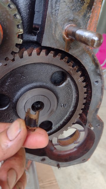

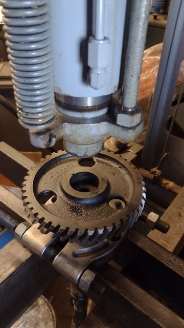

Cheryl and I took a ride to the machine shop working on some of the CA parts. I had him remove the old cam gear and install it on the reground cam. So I can start to learn more about degreeing a cam in an old CA engine. So we keep trying to move forward a little bit on the CA (Cheryl Ann) tractor project.

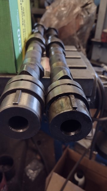

 A couple minor setbacks in the area of CA parts. The bearings are re- ordered. They came as incorrect components. A new set of rings were ordered as one of the oil rings was only 1/2 there, the broken portion was missing. I still have many moves to make, so this is not going to really hold up the project much. I have several full days of cleaning parts and nuts and bolts!
Some cam shots:
Pretty exciting stuff here!:)

Allis folks,
We received the new main bearing set for the CA. I measured across the new thrust bearing and got almost the same readings as the old bearing 1.620 inches. When I set the old bearing and cap on the crank I can get about .014 inch of feeler gage between the bearing and crank faces. So I am going to take the crank and bearings to the machine shop and have him inspect them too. I know he can remove the crank gear and remove maybe .010 from the crank shoulder and replace the gear this would bring the thrust back into tolerance of .001 to .005 inches. That's the plan for now.
Hoping to turn the corner on this tractor build soon, it's been dragging on for a while! Doesn't feel like I have anything completed on the CA. I did move around a lot of the parts today trying to get a work area set up in the corner of the shop. I sandblasted the band for the gas tank.
