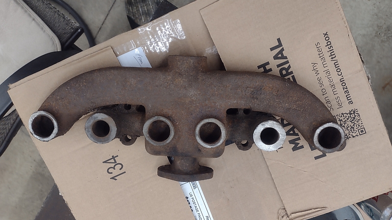

 I got a pretty nice manifold form a AC parts guy in NY. The ears on mine are broke

Looks like progress! Going to get the manifold resurfaced or is it pretty flat?

I need ot check the flatness, and probably take the manifold to a machine shop and have it surfaced. That would be the right thing to do!

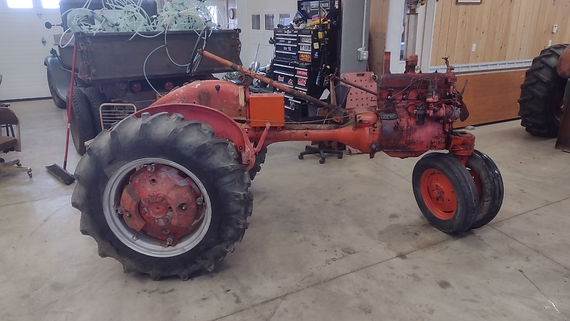

Worked on the CA toget it back on its feet today.
As I looked throught the AC book on the VA I found that the manifold that I got was not the gasoline version? Not sure if this new manifold would work??
Removed the remaining inside race of the lower front spindle bearing. Cut most of the way through it then it was able to be tapped off. Added new lower seal.
Inserted the outer race. I did not have new upper seals. So we are just going with what ever remains in there. Greased up the bearing really good.
Short arm was used for this test:
A couple iterations on the shims under the bolt for the gear. (I did set the timing marks correctly)
Well the goal was to have it steer better. It does, but not sure its as good as new? Still not extremely smooth. Tractor steers same distance in both directions.
I can now move the tractor around in the shop and begin to think about the brake drum replacement on the left side of the tractor.

Looking good. On the manifold, I'm not sure that the CA ever had the version with the data plate on it (that's what would mount in that sort of rectangular opening on the side). The B for sure and probably the C had that one. I don't think it would be an issue... Check the carb flange size and make sure it matches up but I bet it'll work.

 The book shows a shield going over that arfea of the manifold for the non gas version. Maybe building up more heat?? I will check the carb hole spacing next. Paul should be along soon to answer this manifold issue?:)

Now that you ask: The early manifold that you have works on any BE/CE head. Yes on the kerosene engines it should have an extra shield for more heat, it would also help if you wish to run E85. Those early manifold should have the same carburetor  bolt spacing, no big deal to widen them if needed. However the ports and passage up from the carburetor may be somewhat smaller than the later manifolds. Also easily taken care of.
  I suppose that you got the early manifold because it was cheaper than a NEW one. I'd still be tempted to get a NEW one and sell the early manifold to a B/C restorer looking to appease the correct police. Those early manifolds in perfect condition are worth more than the NEW ones cost.
