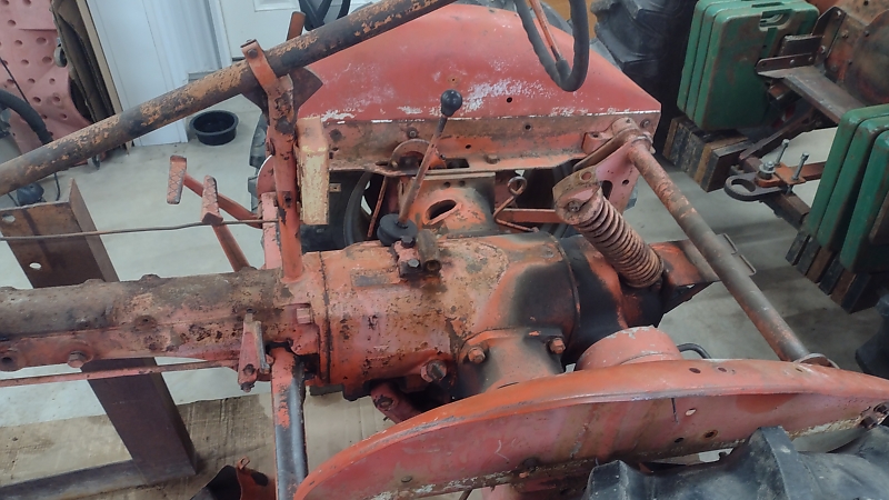

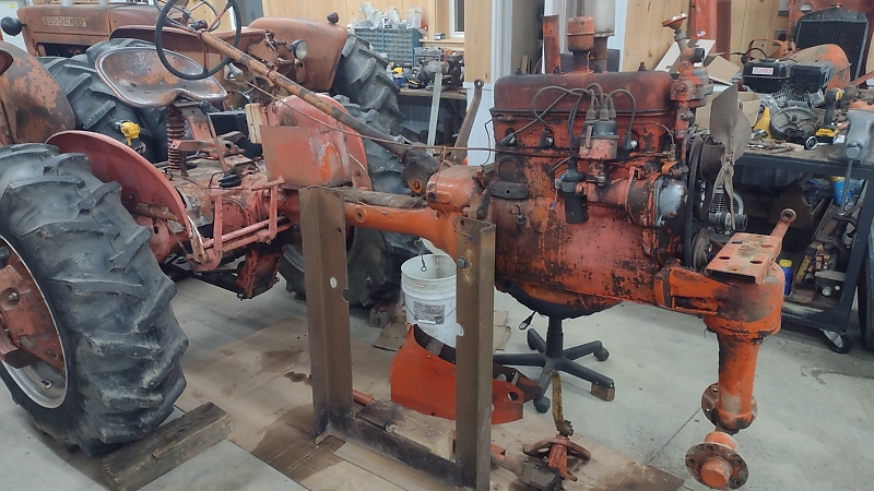

Worked a little more on the front end on the CA. Its just screaming to be cleaned up and painted!
Drag link is almost ready. Need a couple 9/16-18 castleated nuts. It is way better than the old one. Threads are boogered a little on one end.
I installed the new Ross box and everything seems to fit OK. It is also a lot better than the one with the yellow arm:
Pulled rad and the rad support, then dropped the front vertical spindle:
It was jammed with old dried grease. Removed the gear and popped out the shaft:
The lower bearing was intact (for a while) but had some slop and was pretty dry. Not helping the steering since the tractor rests on this bearing. It then decided to come apart. I believe I should try to get a new bearing! This may be a load type bearing. I have not started any research for it. Outher race has a Timken number on it.
Still debating this front casting. I could take the short arm out and replace with the long  arm out of the other casting. This would allow me to keep the casting in place with the ears and the holes. These might be usefull at some point to secure weights?? Are the ears for the Allis CA side weights?? Or I could use them as attackment points to chain the front down to the trailer??

Yes the ears are for the side weights, Bs and Cs are interchangeable, CAs are a little longer. You have to be careful putting them on and off, if one gets away from you and falls it will break the casting on the bolster,not to mention what it would do to your foot

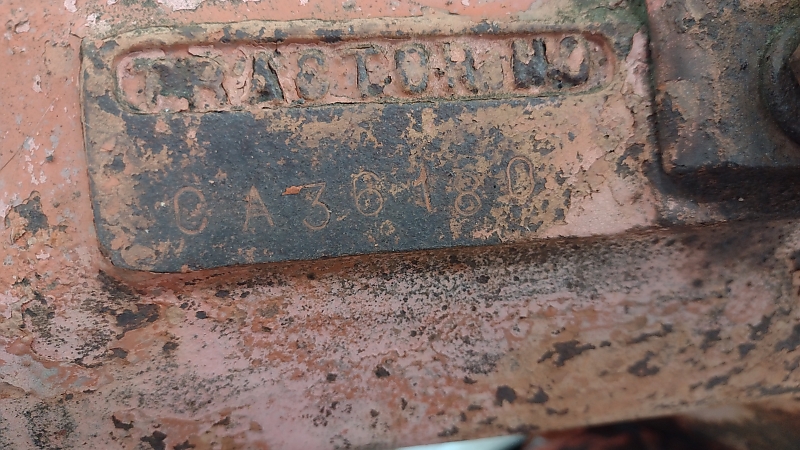

The serial number for the CA:

From the serial number it should be a 1955 , as far as the brake pins, I believe originally the hole for the brake pin was a blind hole mine has a hole on both sides of the casting so you can drive the pin out and change the brakes out without doing major surgery.If they were a one way blind hole in the casting I can see where if it went in a shop for brake work at sometime the shop drilled the hole to make life ever so much easier.

Thanks guys,
I did find more problems! Not a big suprise! Left brake drum in almost gone. Looks like this is the way you take a medium cost tractor and make it into a expensive tractor!:) Not going pulling with out some brake action. So I ordered a brake drum and other items yesterday. May get to tear into this once I get the front end back together. Then I can move it under the jib crane to move the tire and the axle housing easier.
New battery box and brake bands came yesterday. Look great!
