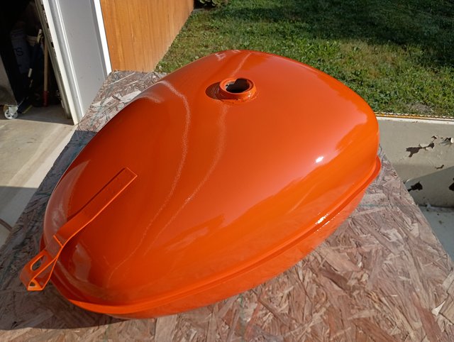

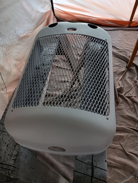

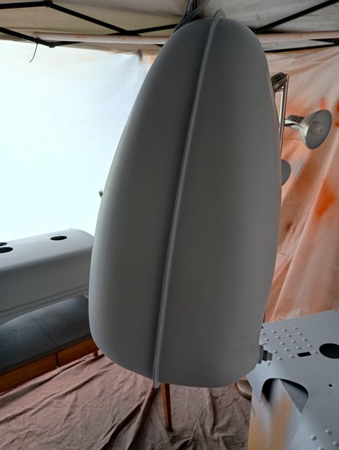

Guys,
First some bling for the old CA.
Back to Bondo on Bondo off:
I will not make this tractor look so good that we wont pull it.
These Allis hoods, if you have ever tried to improve one, are a challenge. At least to me.
These next pictures are pieces that are ready for the next coats of primer:
More tweaking of the sides of the hood.

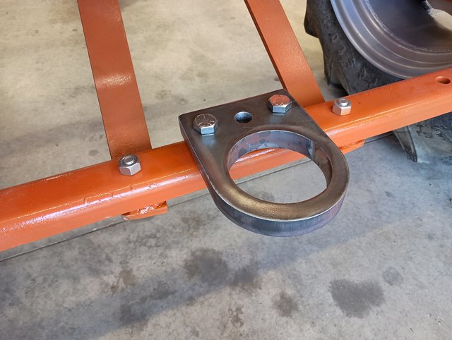

not too exciting stuff. I did get a temp gage installed. Also ordered a pulling ring/ hitch for pulling.
 Chris and Cheryl
Edited by Sugarmaker - 09 Aug 2025 at 8:45pm

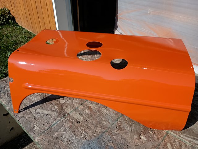

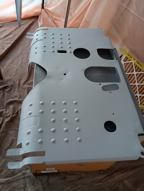

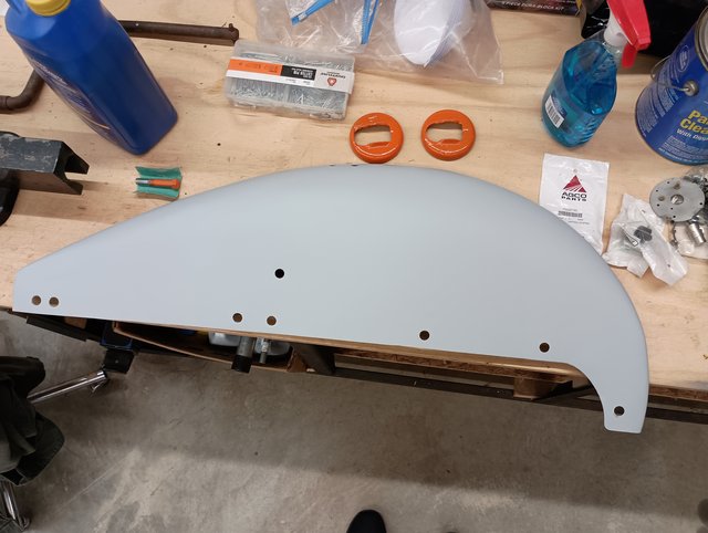

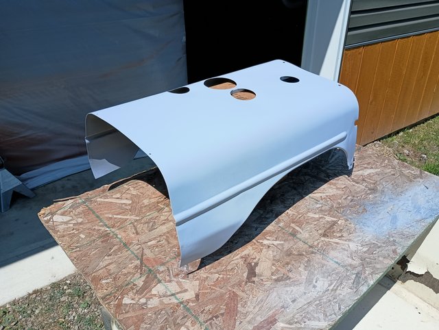

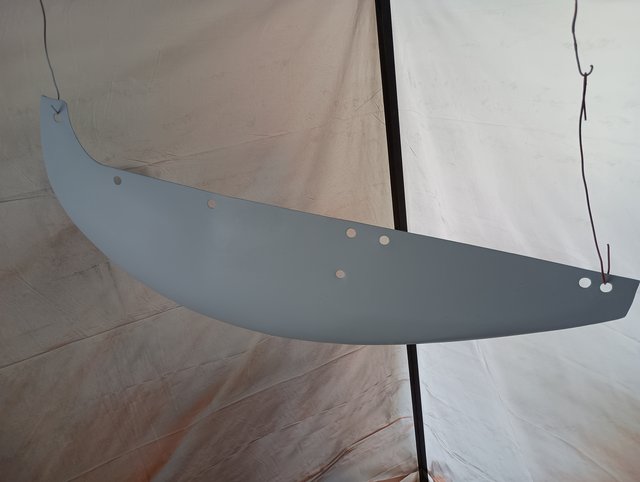

Guys,

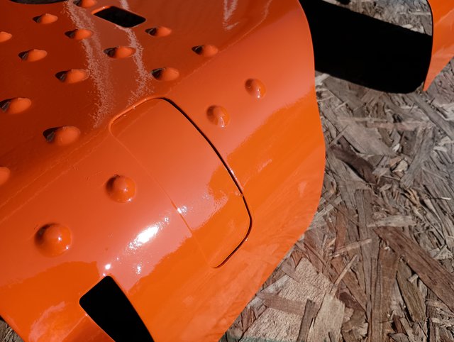

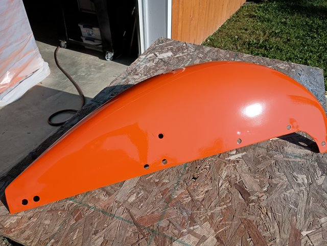

So today we sanded the primer with 220 to level the surface a little more, and remove a few runs. I was able to prime all the parts again. The hood needs a little more attention, so I may be able to get it in primer tomorrow.
Here is the left fender just out of the crude paint booth. I think the parts are going to be ready for Persian Orange number 1 soon. Getting tired of sanding. But I have continued to try to improve my skills in body work over the years.
I plan to scuff the parts with scotchbrite, tack them off and prep for finished paint.
 Chris and Cheryl
Edited by Sugarmaker - 14 Aug 2025 at 5:53pm

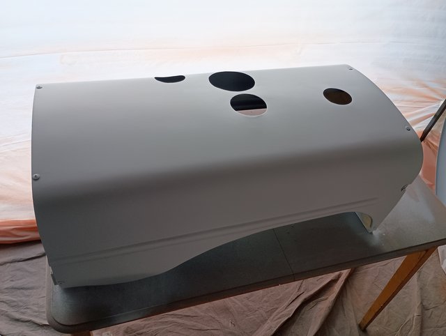

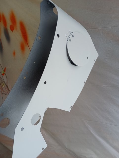

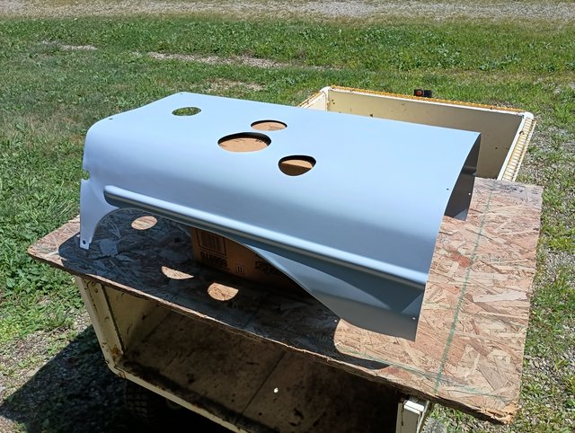

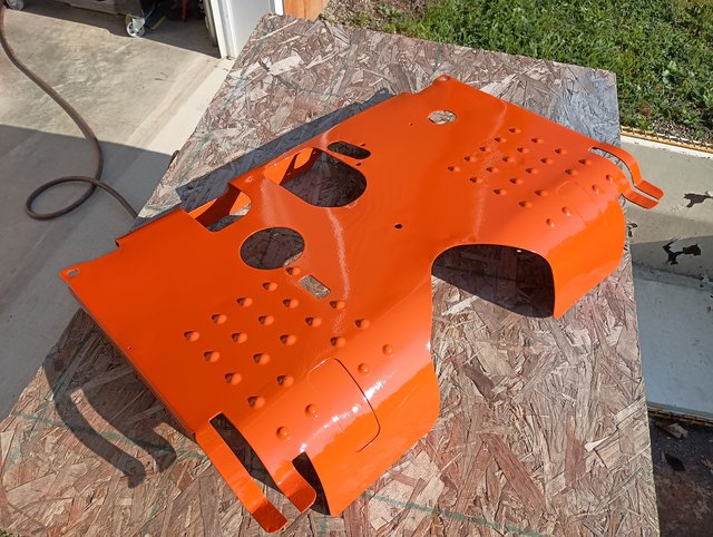

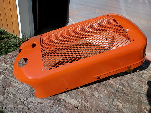

tadams and Allis folks,
 Well I finished priming the hood prepped all sheet metal parts and got them positioned in the paint booth. IF I was going to do this again I need 4, 4 foot LED lights to be able to see. Anyway I mixed up the orange and covered all the parts. Had some runs on inside of the fenders. Also on the tool box. So I will have some sanding and touch up. I put on two coats. Pretty happy with most of it. Poor vision, poor lighting makes it all look acceptable!
 Will get some pictures soon. Probably tomorrow. As it needs several hours to cure. the top coat is single stage omni PPG. I think the color is darn close to original!
I released the hood from the buck to sand the attachment points and get full paint coverage. This morning as I used scotch Brite to scuff it.
I hung the hood vertical in the paint booth and when I walked out I did not see any runs. There always seems to be touch up needed or some spot I missed.
Dang I am going to need a wiring harness! Wonder what Steve (B&B) is up too?
Pesky carb and distributor are on the list to get back together also.
Ok This is way overkill for a old pulling tractor in the 2500 or 3000 lb 3.5 mph class.
 Chris and Cheryl

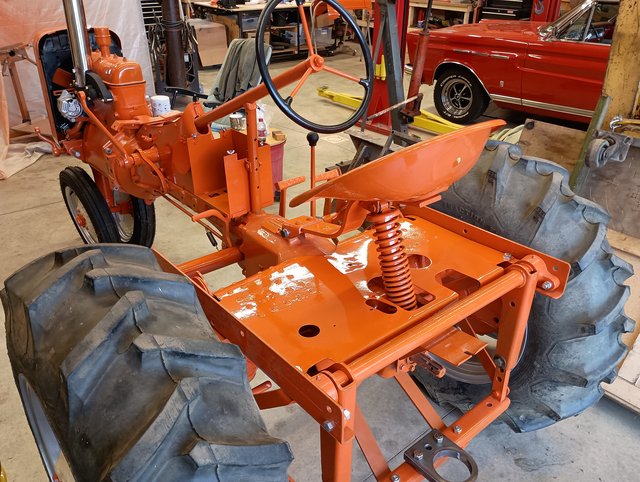

Aiils folks,
My painting leaves a lot to be desired! Its orange!
Some assembly required.
 Chris and Cheryl

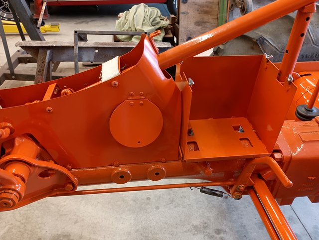

Points: 8622
Post Options Post Options   Thanks (0) Thanks(0)   Quote Sugarmaker Quote  Post ReplyReply Direct Link To This Post Posted: 16 Aug 2025 at 3:10pm

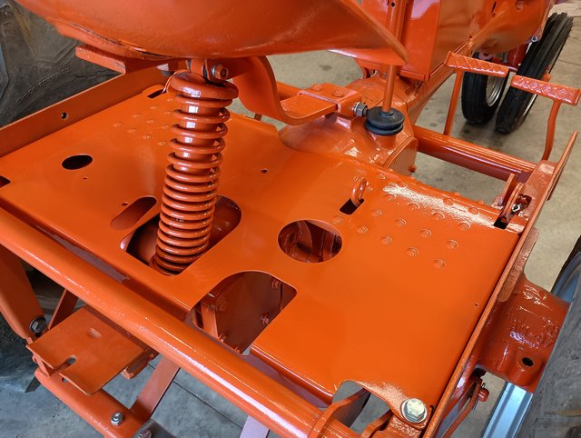

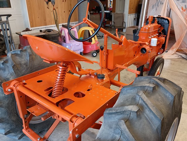

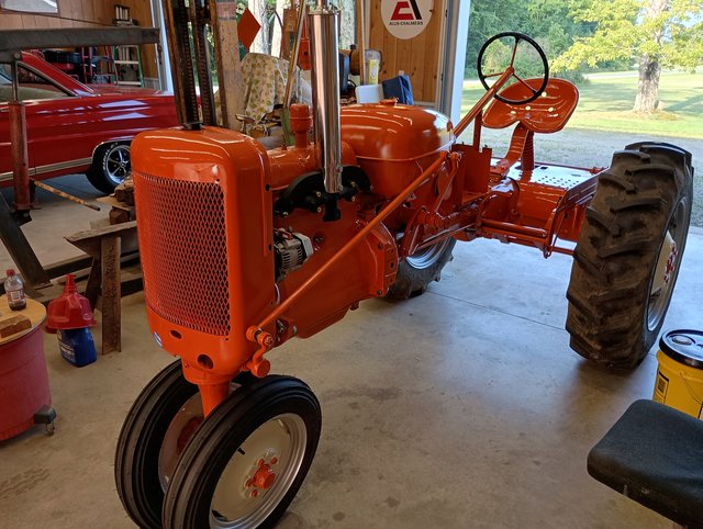

Guys,
 Like when I was a kid putting models together. Just cant stop if the parts are ready to assemble.
Almost back to normal!
 Chris and Cheryl

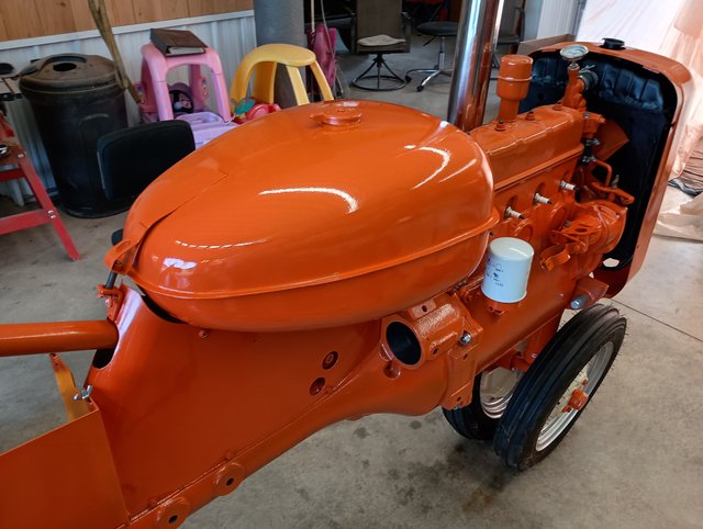

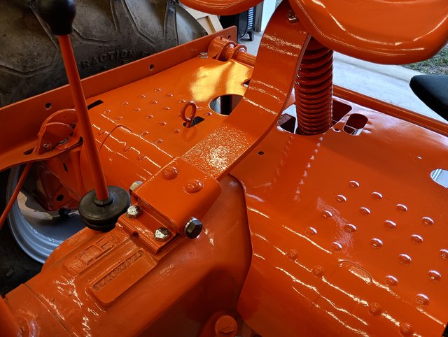

Guys a few more details of the old CA project.
This has been 3 years. I haven't worked very fast on this tractor!
Some of the first parts I painted did not get enough paint. Like the side rails where the fenders bolt on. And yes I added my special orange peel affect in the paint too. I mean it is orange right? Gotta have the orange peel!!  And don't forget the custom over spray to provide extra texture and grip at certain areas of the sheet metal! I hope the decals hide some portion of that too! It just may have to be this way, and let the next guy worry about it 70 year from now:)
Really hoping this old CA becomes a family tractor for one of the great grand kids. Kolten is 13 and will be able to pull at the local fair this year. He has 3 more year before he can pull at some of the other local events. Am hoping one of the 6 develops an interest in this old orange iron, I cant pull them all! :)
