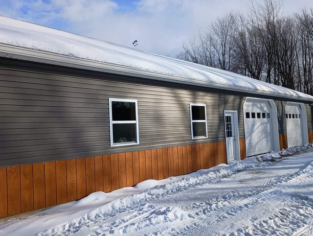

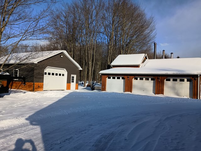

Not a lot going on here, which is pretty much the norm anymore. Temps are around zero. That D14 with the blade really works well to get some of the snow moved around in the drive area.
Tractor shop on the left, Sugar house on the right.
Going through fuel (propane) like crazy. But the shop is comfortable.

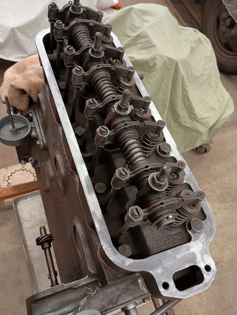

I did get the valve cover surface cleaned up. Will mask the valves and the bottom end.

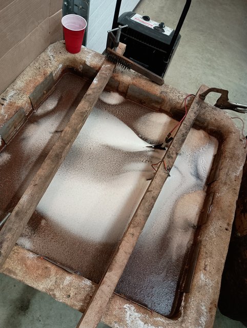

Have the tool box steering cover in the E-tank to clean the inside of some of the rust.

Beautiful shop Chris, what size is it? I’m still shopping around, metal building or stick built. Metal buildings certainly are less expensive and go up in 3 days. I’m looking at a 30’x70’ with a 30’ lean two off of it. 3- 10x10 garage doors, 12 ft ceiling. Enough to get the biggest tractor, my XT, inside. Will see how much more a 14’ ceiling cost, 1-12x12 door so I don’t have to cut off any of the straight pipe. Right now all my stuff is at the farm in a open face building which is fine but I would like to get it out of the afternoon sunlight.

The shop is 40 deep x 64 long. As mentioned when I started a thread on the shop build on this forum (Shop Talk thread) They are never big enough. Sounds like you have a good design that will fit your needs. I would recommend 12 foot wide doors. I really like that width. My grandson is having a post type building put up with steel roof and siding. It's taken since the middle of Sept and not close to being done. He has a contractor friend working on it when they can. It is 40 x 60 with a 14 x 60 lean to, on the south side.

I did get the CA engine block masked off for primer and top coat.

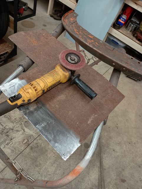

Some sheet metal to repair the rusted fender. Found this scrap in the corner. Rough, but should work.

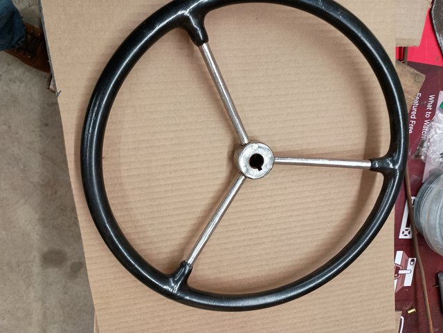

Sanded the spokes of the steering wheel

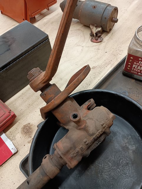

The Ross steering box. opened drained of sludge and old black lube. Will clean it up, new gaskets, and fresh lube.
The E tank working on the tool box rust.

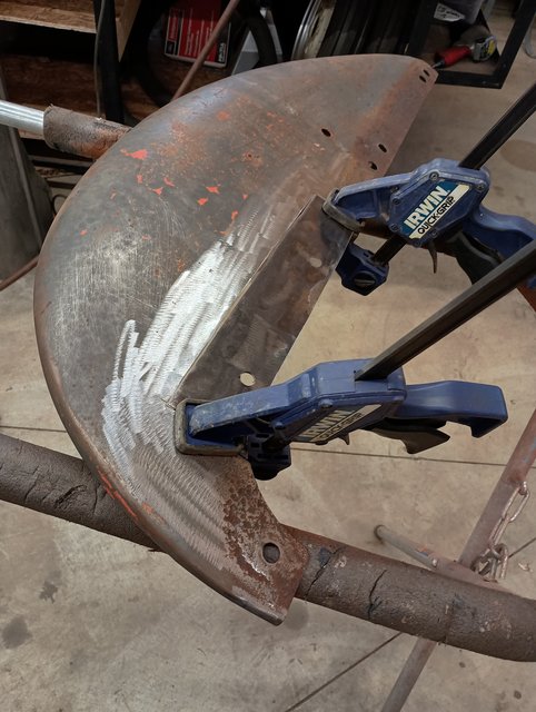

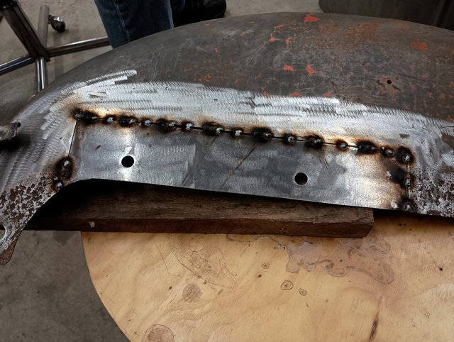

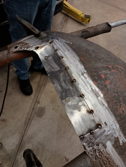

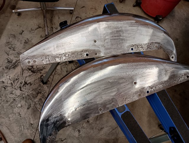

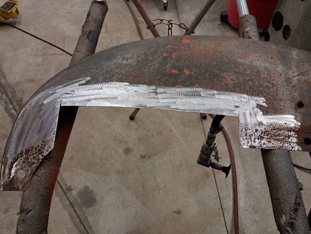

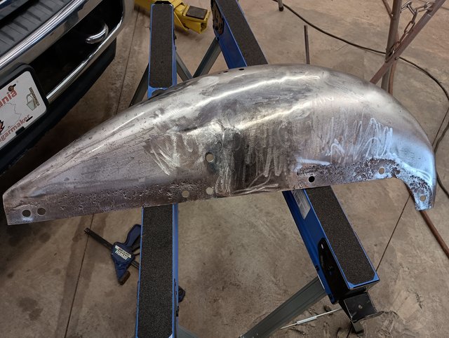

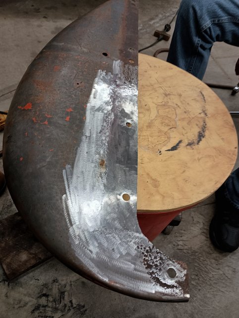

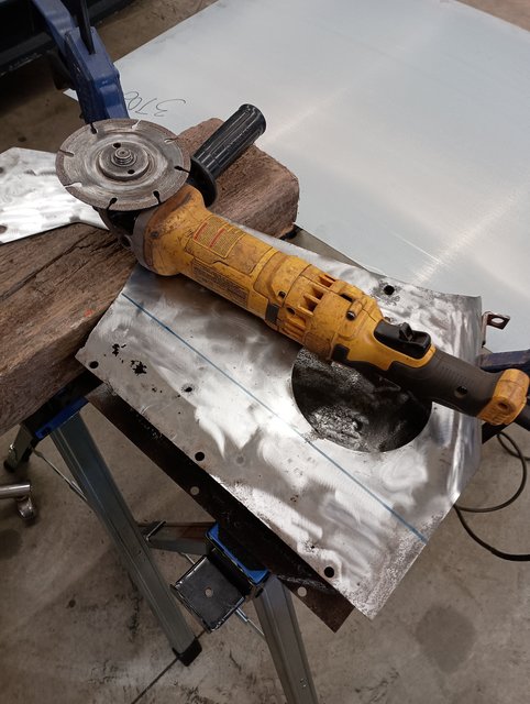

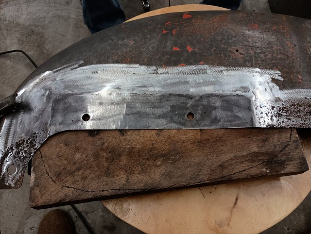

Today John and I worked on an old rusted CA fender.
This had rust in the area where it bolts for the tractor.

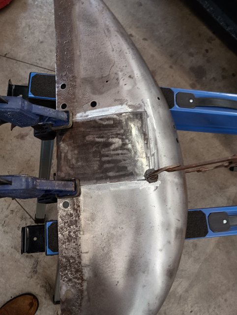

An old hunk of scrap to fill the void:
A little shaping to help the patch match up at the seam.
The old Mig is all I have to stick this together:
Spot, cool, repeat:
A grinder here and there:
A few taps with hammer and dolly. This is where we can primer and smooth with a few coats of filler.
The other fender will be on the agenda for another day.

Guys,

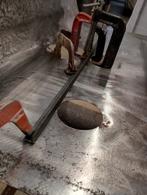

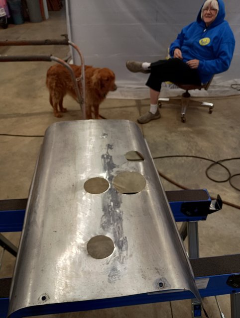

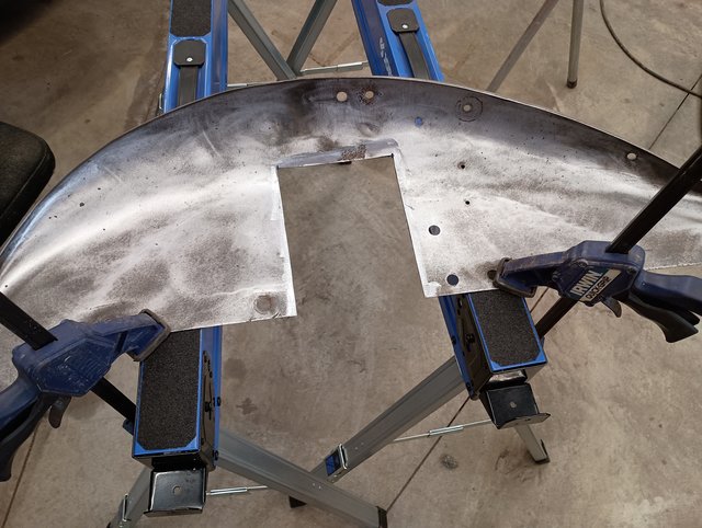

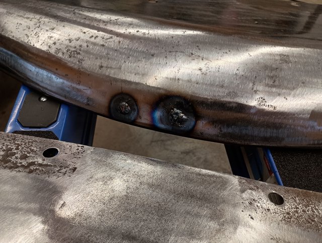

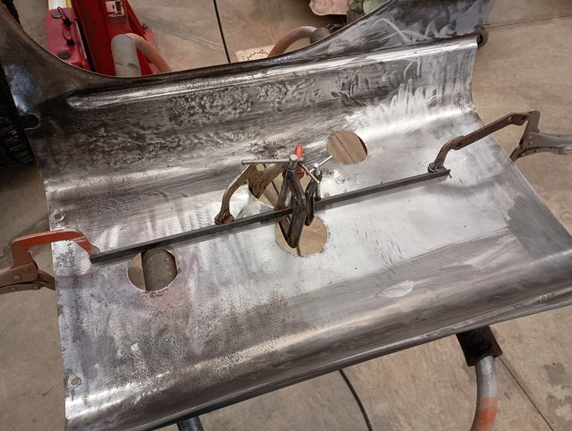

Cut out the less than clean brazed section of the fender:
Fit a patch into the hole:
Welded up some of the extra holes in the fenders
Ready for some primer then finish with some filler.

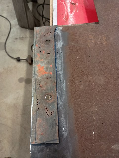

Steering support is rusted out so that needs repairs with thinner material.

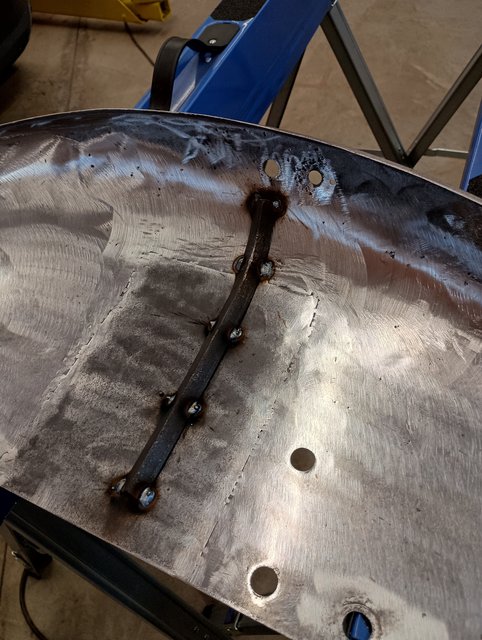

Back to the body work:
I have added a stiffener under the hood to help reduce oil canning of the hood sheet metal. This should help with the final forming.

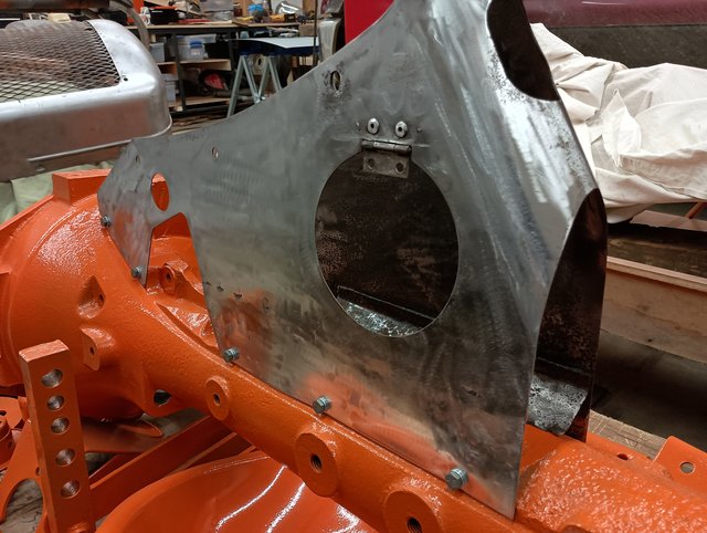

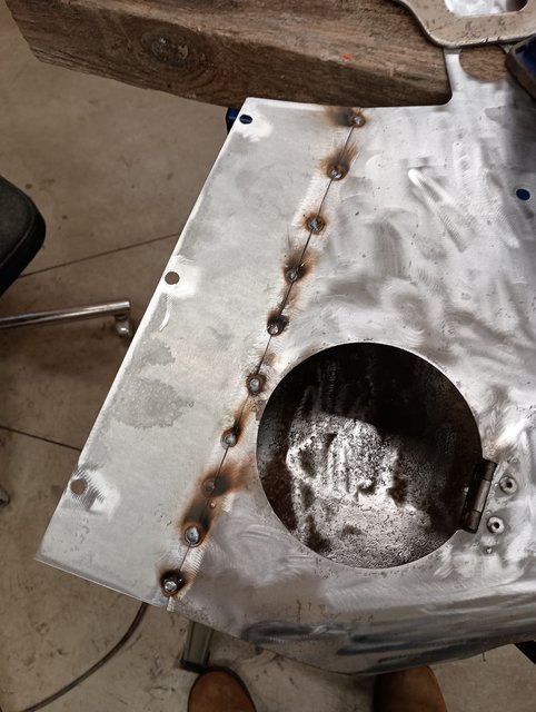

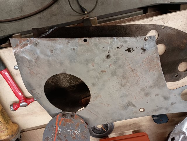

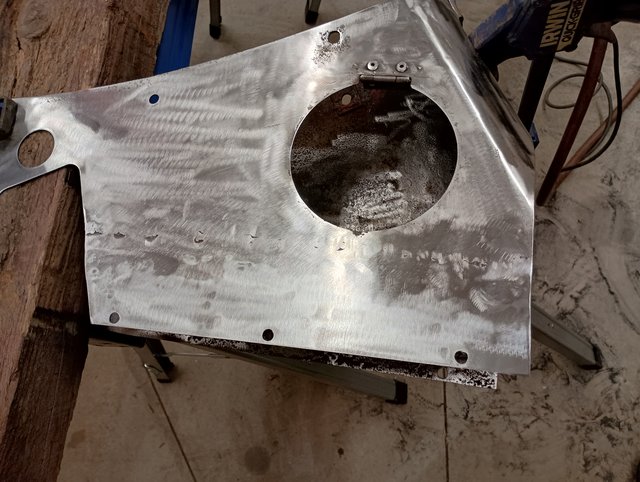

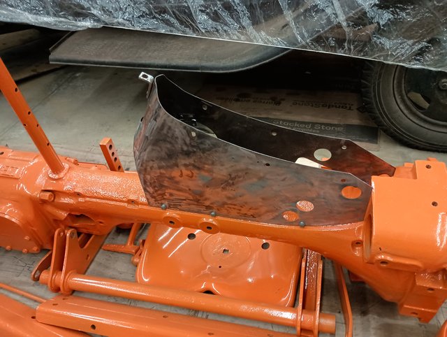

Next, friend John helped clean up the steering support sheet metal:

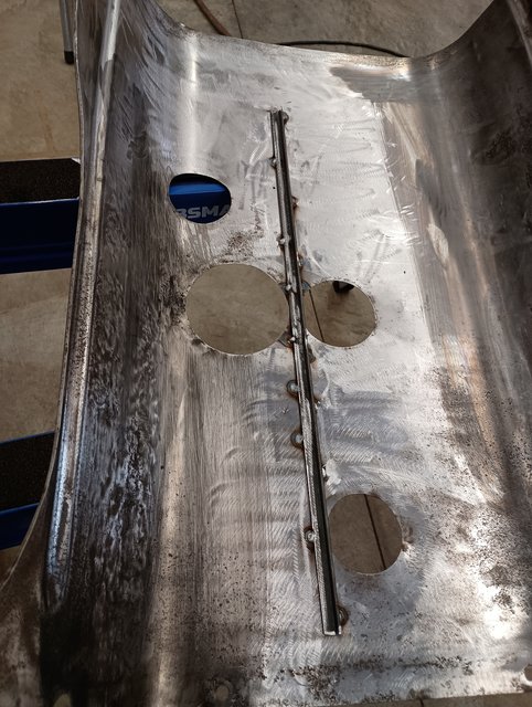

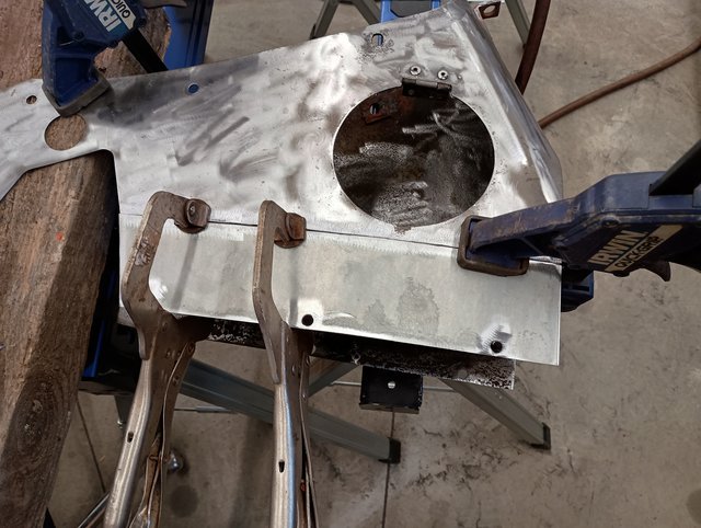

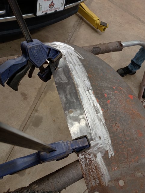

We cut 3 inches off the bottom on the left side below the tool box lid area. Transfered the holes.
After priming this will need a light coat of filler.
A trial fit after repairing the rusted out area.
I also added a wire chase for the inside of the fender with the tail light. I used a piece of small angle iron shaped to fit.

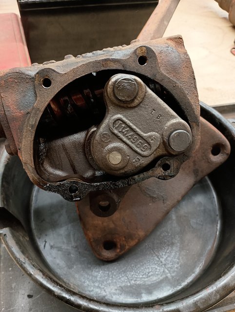

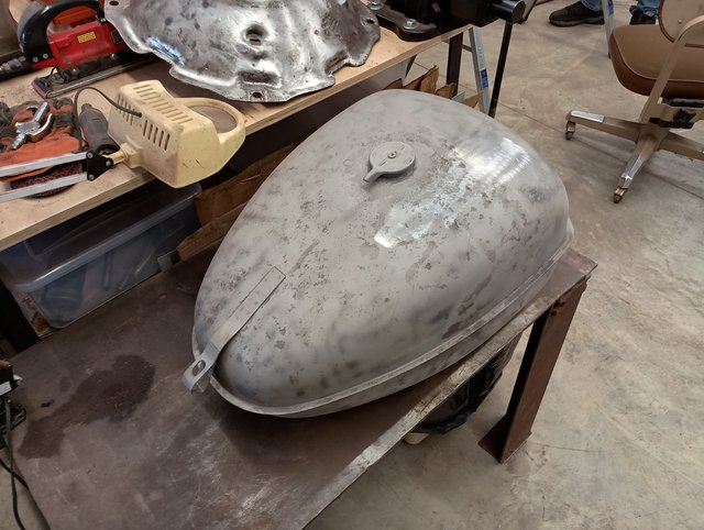

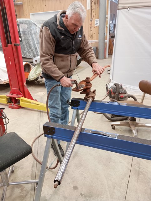

John and I started to clean up the Ross steering box and column. And I did install the new gasket.
The gas tank will be next to clean up the outside some more prior to primer:

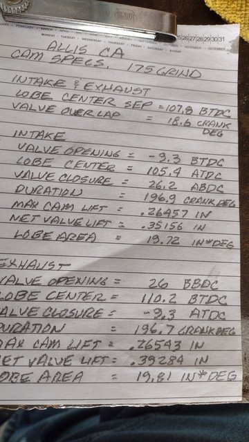

I have been learning about degreeing the cam. (7000 you tube videos for small block Chevys) I typically learn by doing, so this will be a small project. Of course I should have done that with the head off. A couple steps back but I will keep you upto date on the cam checking and or adjusting process.
I did order a degree wheel today. Also talked to a local machine shop and they are willing to build some tooling for me to mount the degree wheel to the crank snout.
Oh yeah will need some new gaskets too.
I did find the cam specs:

Quote
Chris, awesome cam details. All the opening and closing degrees, with the overlap and lift takes me back 40 years when we picked a Lunati cam for my 68 Pontiac Lemans. Was a high RPM cam, with a big lift and overlap and had a really nice "loping" idle at a 1,000 RPM's! However, terrible gas mileage in combo with a heavy foot!
Great work.

It seems your comments on the cam specs are positive. I am definitely not in any position to even comment on the cam specs. I will be really lucky to get it degreed properly. Also no clue if it will help the old CA get down the dirt track a little farther than some other pullers? The old cam had some wear for sure. Several lobes were worn down smaller than the others. A couple of friends on the sidelines to help me with the cam degreeing process.

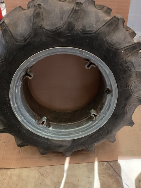

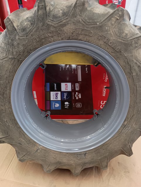

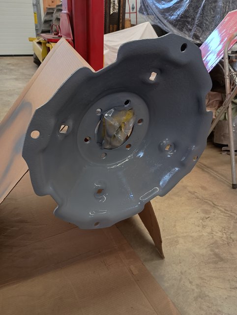

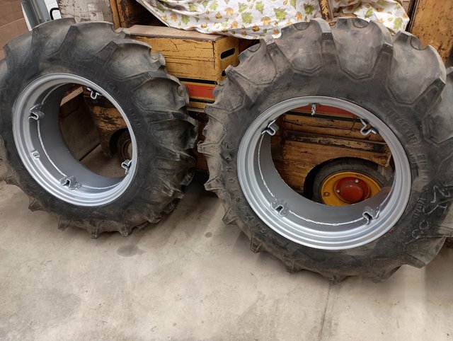

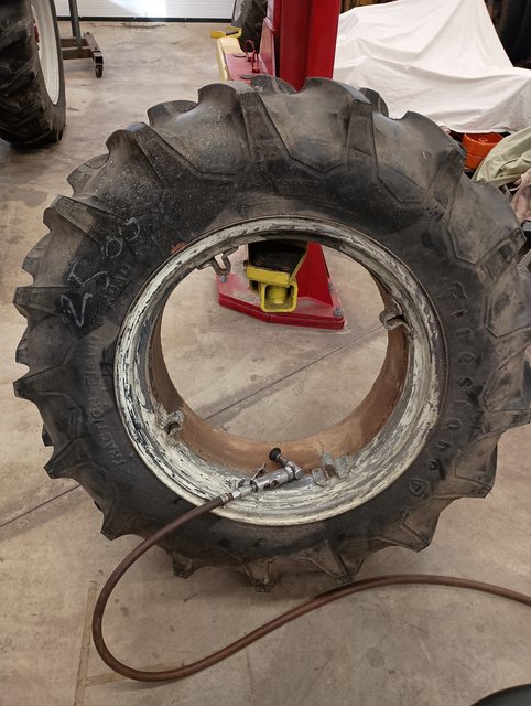

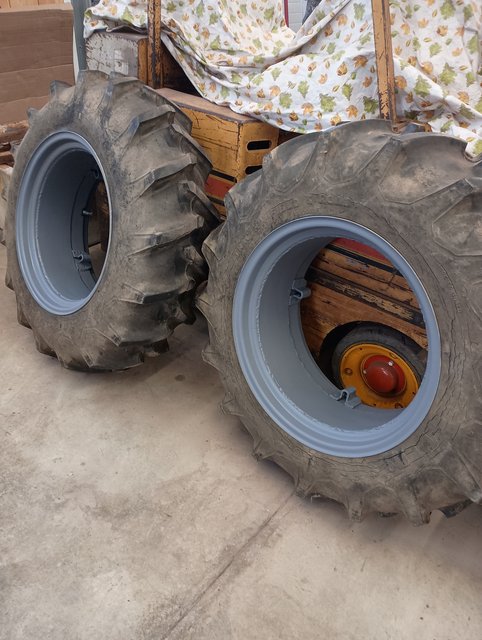

I did some wire brushing on the rear rims today. Got these rims into primer. I used a simple card board mask that matched the rim radius as I primered them. Also picked up some rattle cans of Rust-oleum hammered silver. Might look a little more like galvanized.

Guys,
The silver hammer paint on the rims. Turned out fine for the old CA.
Decided that I am going to use the mismatched and pitted centers for the rears. You can only look at one side of the tractor at a time anyway!:)
