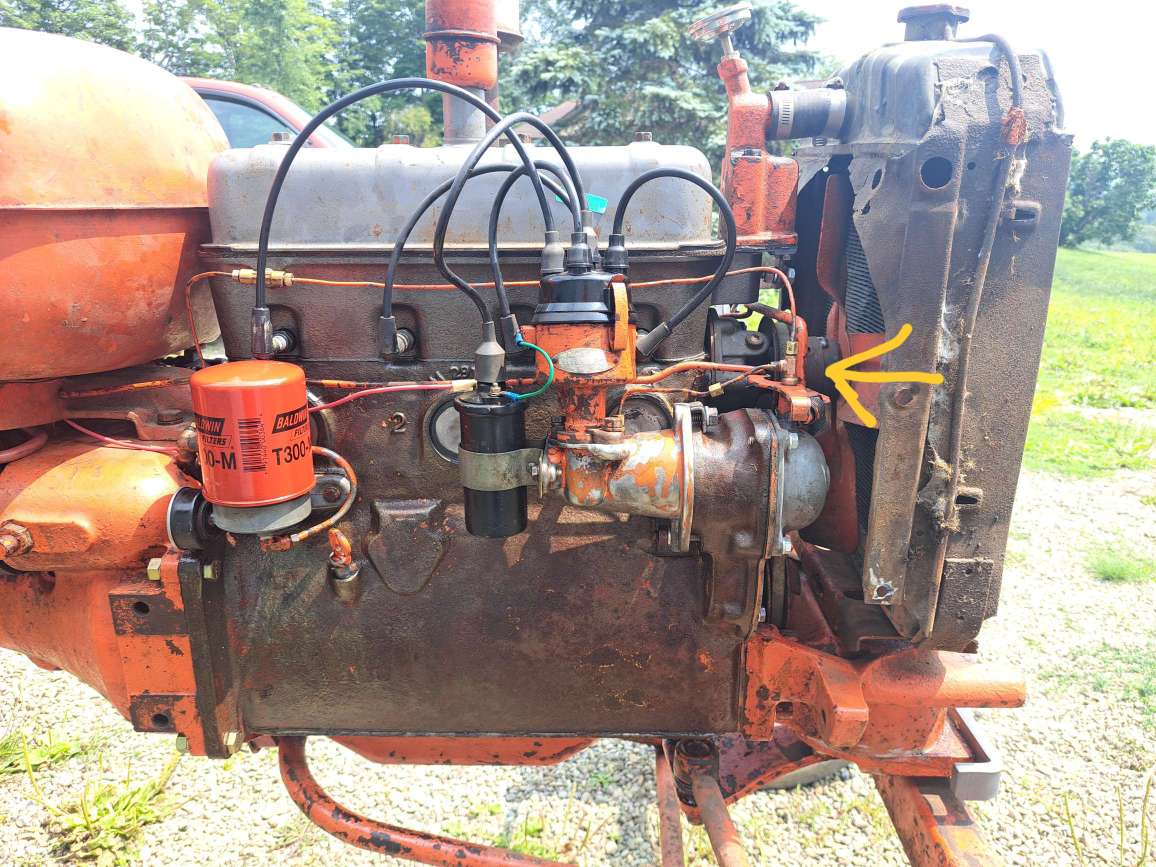

T760Allis: Your motor looks like mine. I rebuilt it about 10 years ago. Cleaned the head, block, pan, and valve cover of all grease and paint. I was in too big of hurry to paint it. It still isn't painted.

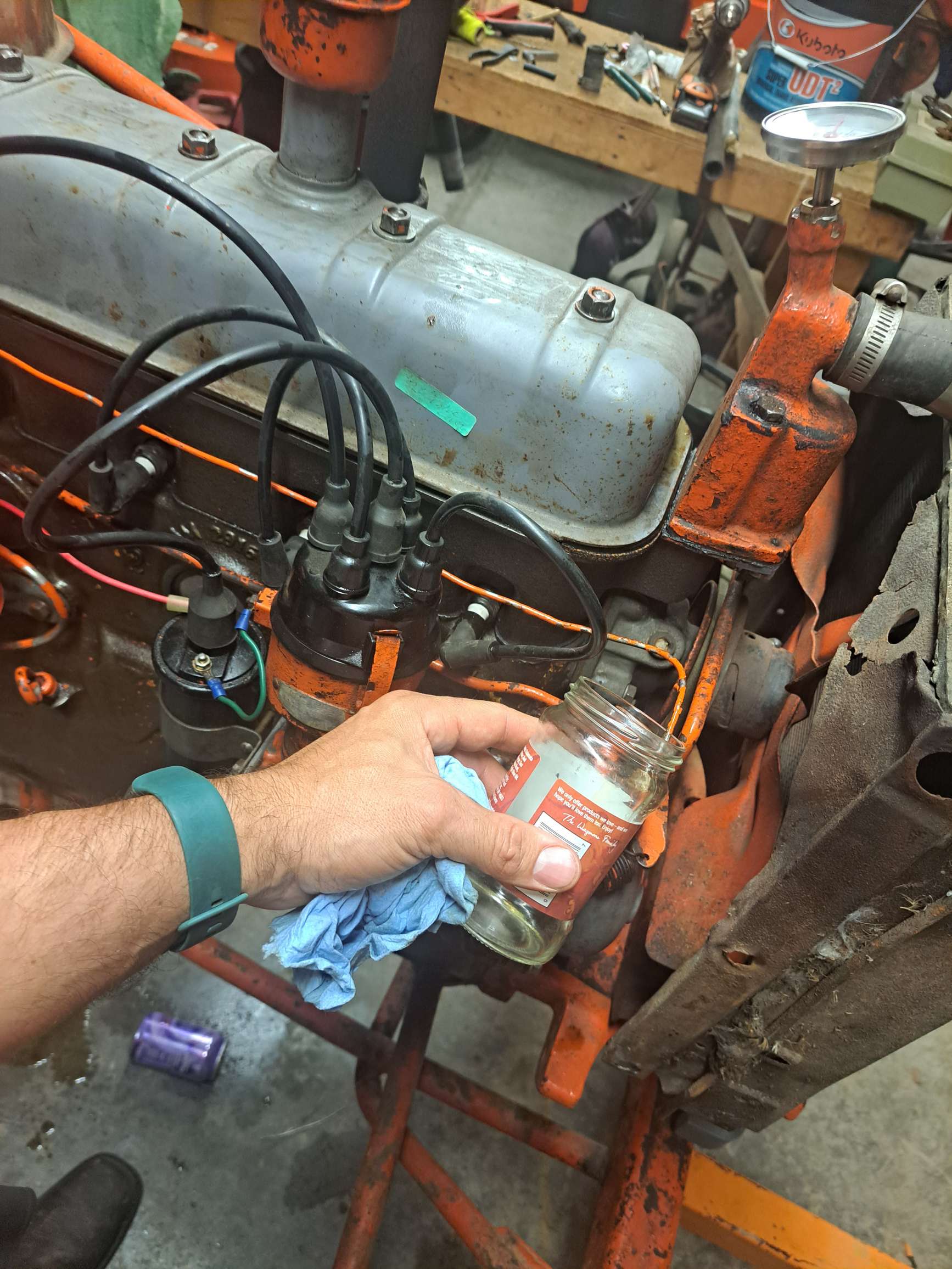

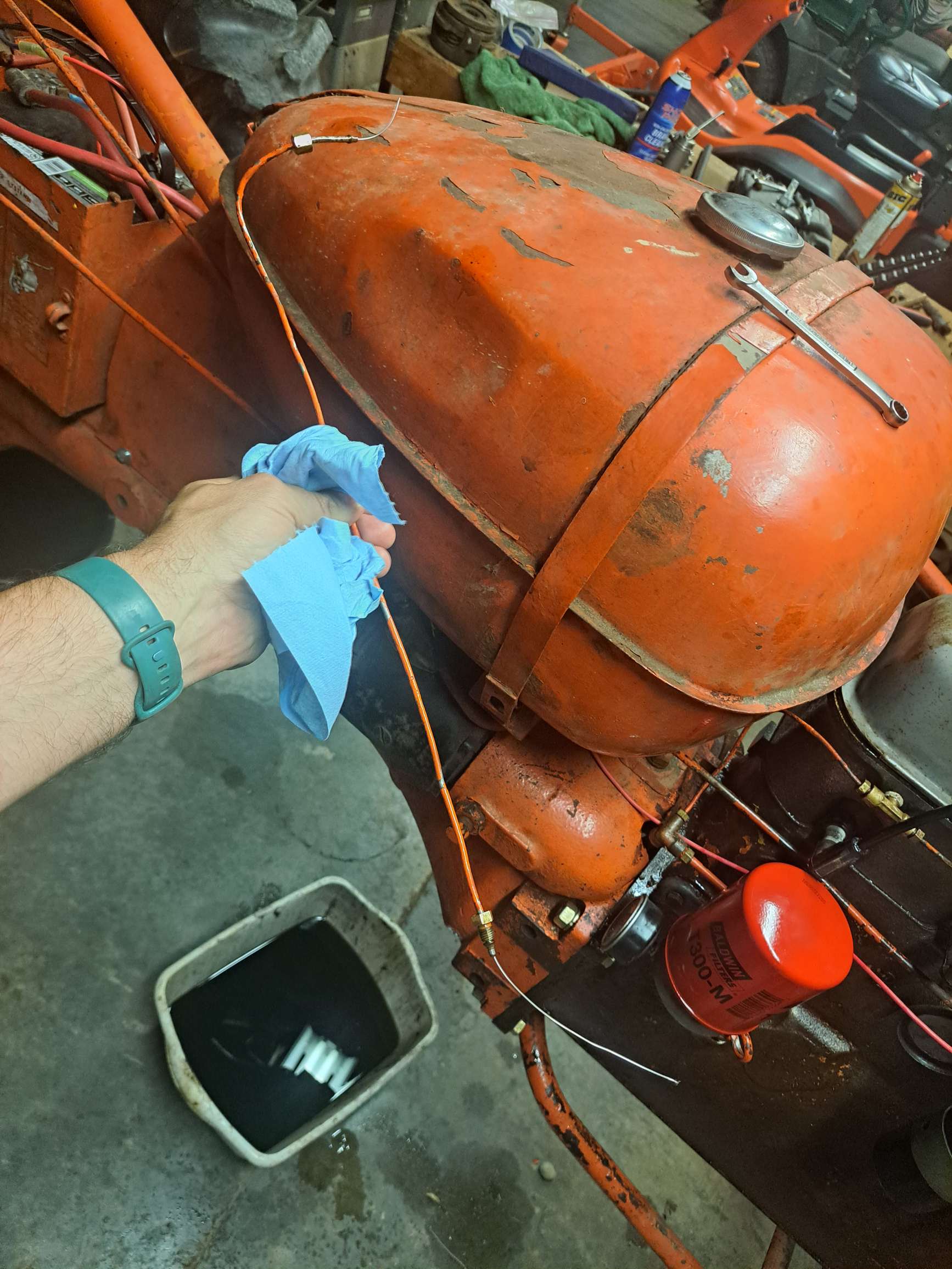

Post Options Post Options   Thanks (0) Thanks(0)   Quote T760Allis Quote  Post ReplyReply Direct Link To This Post Posted: 02 Aug 2023 at 9:03pm
I pulled the line off and blew air through it. Then I fished a piece of wire through it and ran some cleaner.
Then I cut a little bit off each end past the ferrule and cleaned it up. I then connected one end to the head and ran the other into a jar. Still only getting a slow steady drip.
Picture is for demo only, I checked this while engine running
Next step is to try a brand new line... just need to find some tubing
Edited by T760Allis - 02 Aug 2023 at 9:05pm
