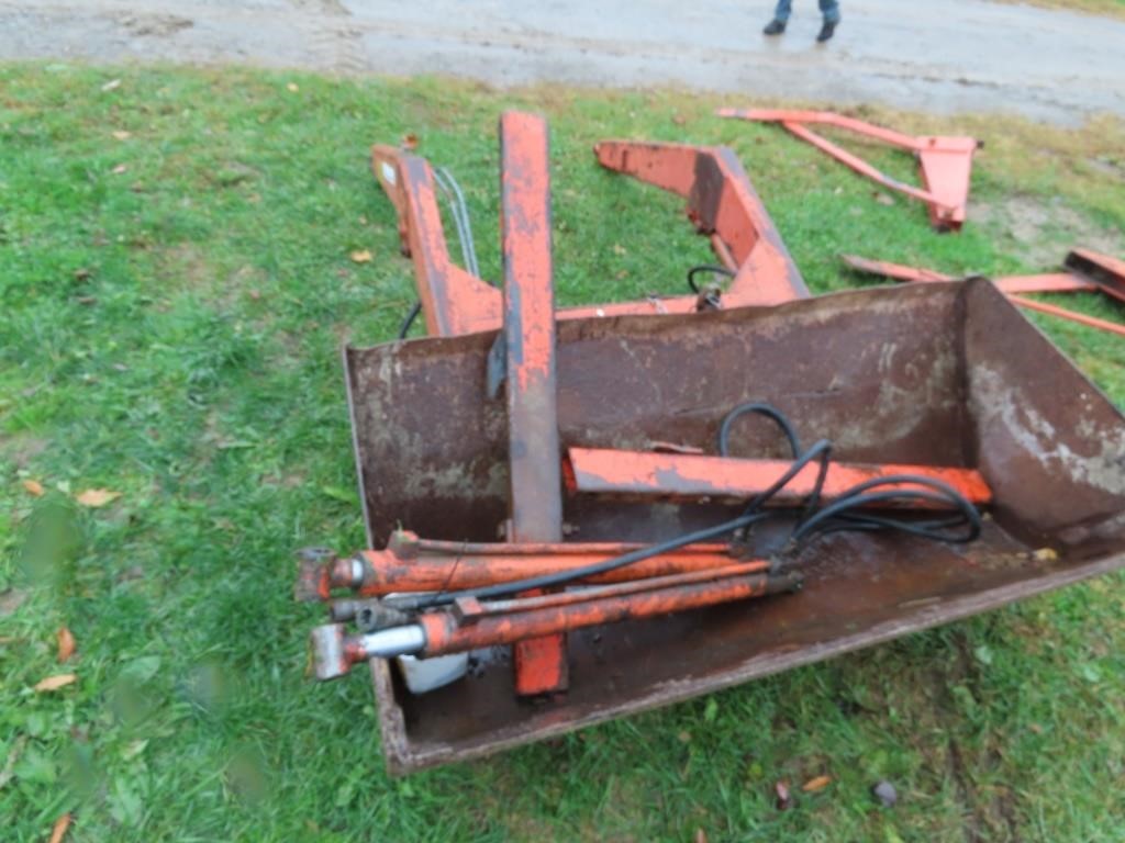

im looking at this loader could you tell me what I should spend.. it does not have the pump... has everything else I think... also will it fit a d15? or d17 thanks

Mike, I paid 450.00 for one this year and it had a pump, I mounted it on a wd45 and think it would work on a D-15 but not on a D-17 without changing the mounting brackets that goes to the rear axles (need to be longer) But I'm by far no expert.

Personally, I wouldn't be interested in it for a D-17 (unless it was a Series 4) without a front mount pump.

I needed a loader for the 175 about 5 plus years ago. I bought a TS 500 that was supposed to be off a D17, this was too small, paid 500$, then I bought a New Idea loader (think it was a 504?) for about the same $$. The NI loader would not clear my wide front correctly. After much driving around looking at loaders of all sorts, most were broke up and missing parts like brackets, cylinders, valves ect.... I then ran across a complete AC400 loader for I believe about 1200$. The AC 400 loader is now on the 175 and I am happy that I went that route. I sold the other loaders for what I paid to a junk dealer near me so I wasn’t off that far. Just my 2 cents worth.

Need more pics. That isn't s 400 or 500 ldr to fit a D-17. I'm wondering if it fits a 5040/5050 ?? axle tubes are separate from the towers...…..

Dr Allis is correct— that is not the hardware to fit D17-175. It can be modified, but be aware. I have the same loader from a 5040 and that one in the picture is missing some of those brackets as well.
