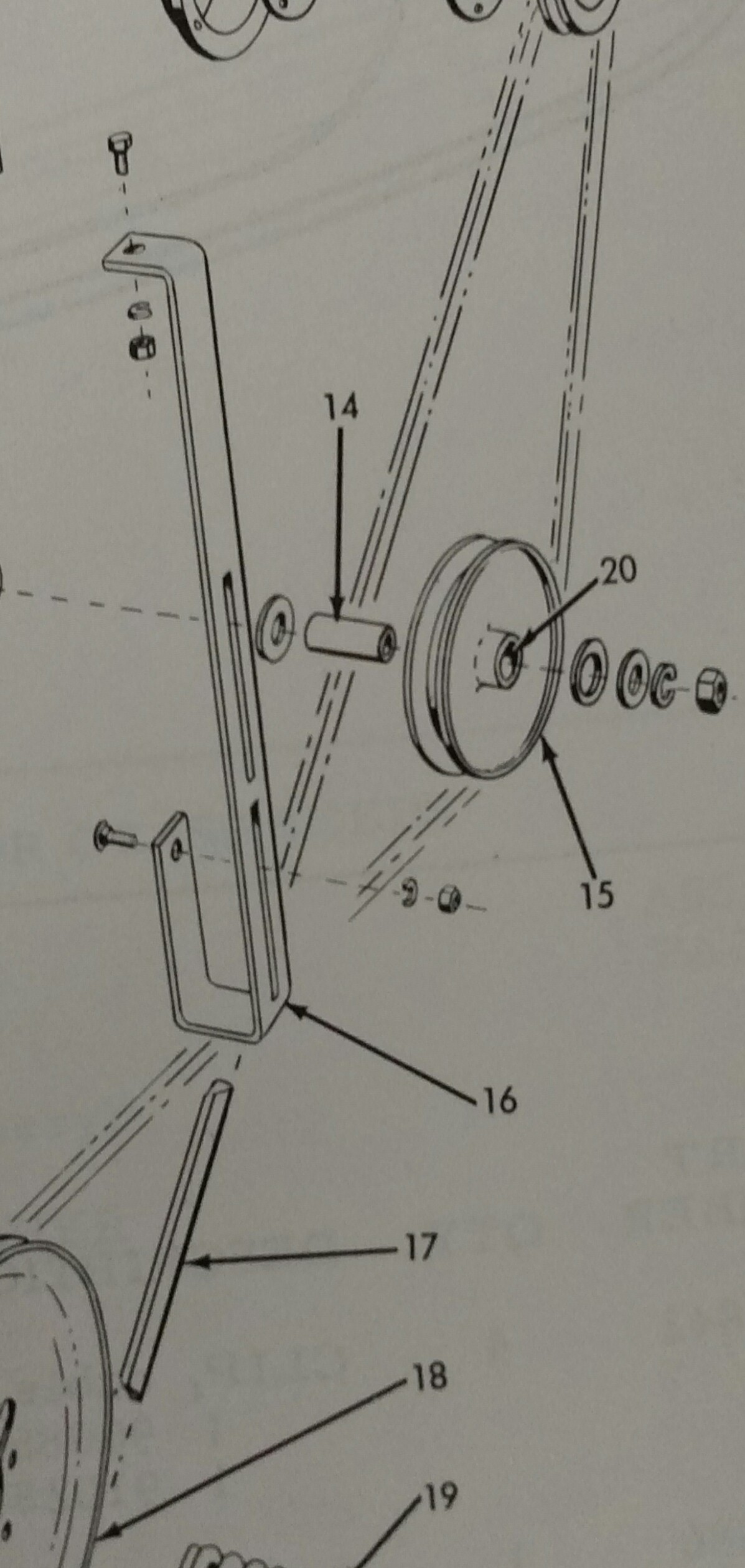

Post Options Post Options   Thanks (0) Thanks(0)   Quote combinechris Quote  Post ReplyReply Direct Link To This Post Posted: 29 Jun 2016 at 10:17am
heres a picture of the idler and bracket from the 60 Parts book. It's the same for the 66 & 72.

Post Options Post Options   Thanks (0) Thanks(0)   Quote Ryan Renko Quote  Post ReplyReply Direct Link To This Post Posted: 30 Jun 2016 at 8:11pm
Thank you for the pictures Mike!! I see the previous owner did add a second idler pulley. Maybe he had the key to the belt not rubbing on itself.  Ryan

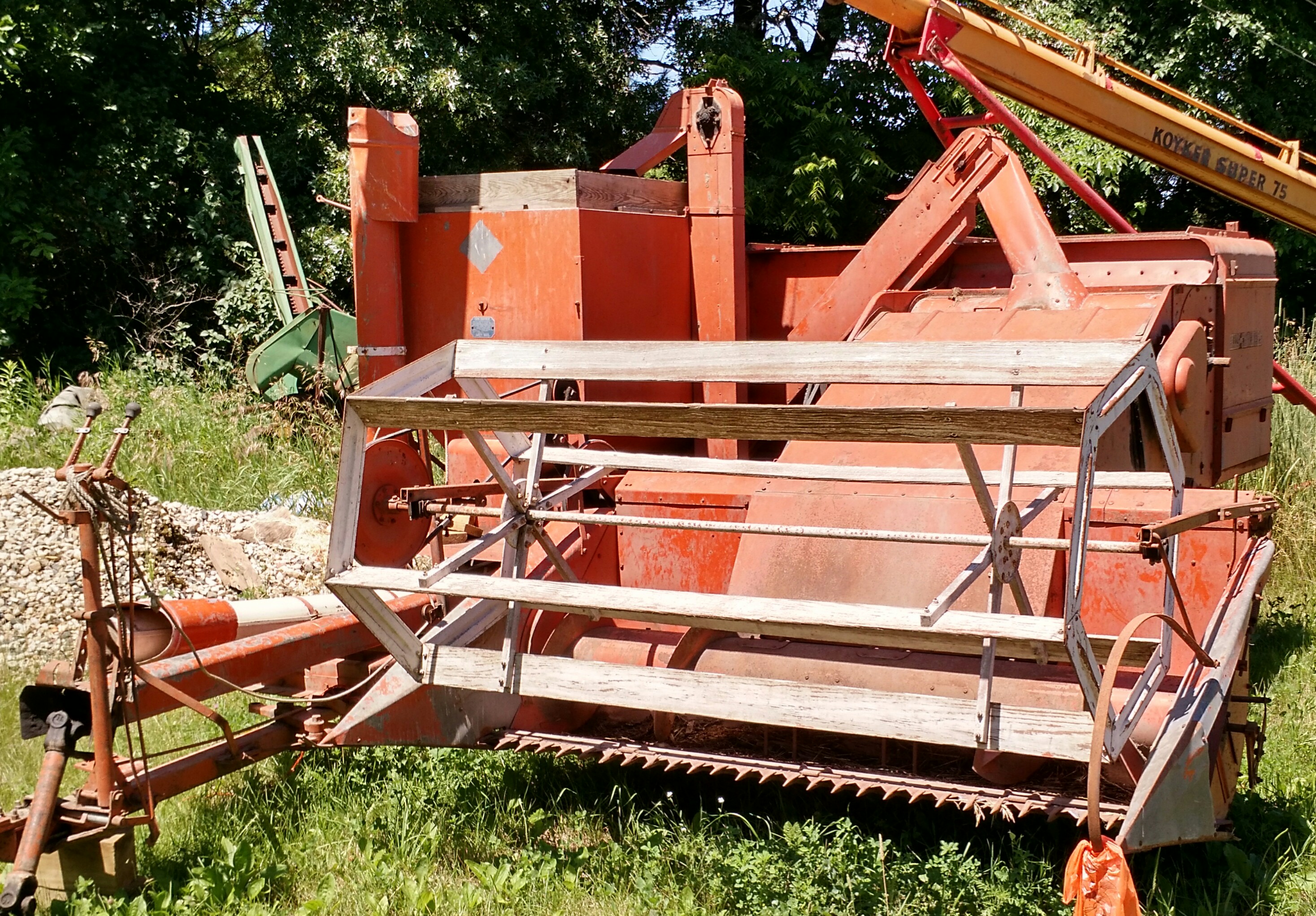

Post Options Post Options   Thanks (0) Thanks(0)   Quote combinechris Quote  Post ReplyReply Direct Link To This Post Posted: 01 Jul 2016 at 8:35pm
the 90 waiting patiently for work.

Post Options Post Options   Thanks (0) Thanks(0)   Quote TomYaz Quote  Post ReplyReply Direct Link To This Post Posted: 01 Jul 2016 at 8:37pm
I dunno, she actually looks impatient!

Post Options Post Options   Thanks (0) Thanks(0)   Quote CrestonM Quote  Post ReplyReply Direct Link To This Post Posted: 01 Jul 2016 at 11:37pm
How come there's 2 unloading augers on it? A creme one and the orange one?

Post Options Post Options   Thanks (0) Thanks(0)   Quote combinechris Quote  Post ReplyReply Direct Link To This Post Posted: 01 Jul 2016 at 11:59pm
Came with an extra one. Also has the flail spreader in the hood.
