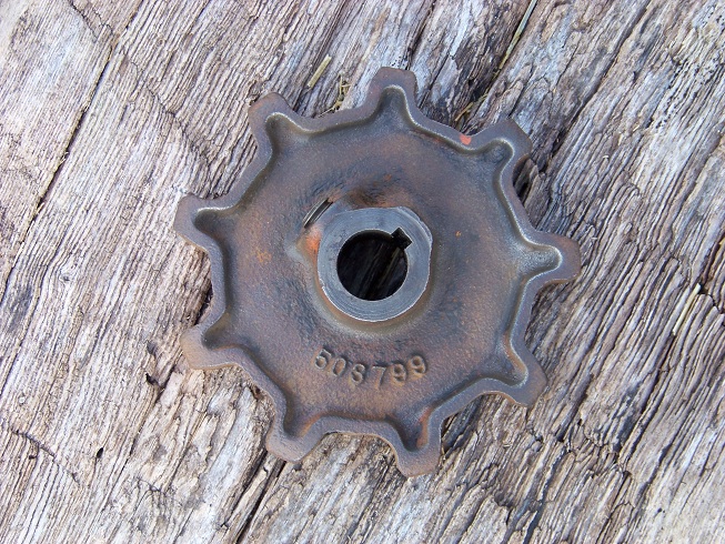

Flint23 View Drop Down
Joined: 31 Jan 2011
Location: New Haven In
Points: 429
Post Options Post Options   Thanks (0) Thanks(0)   Quote Flint23 Quote  Post ReplyReply Direct Link To This Post Posted: 31 Oct 2011 at 3:54pm
is this the one you need? If so you can have it .
been there done that, not doing it again...
nitehawk View Drop Down
Joined: 20 Jul 2010
Points: 6
Post Options Post Options   Thanks (0) Thanks(0)   Quote nitehawk Quote  Post ReplyReply Direct Link To This Post Posted: 31 Oct 2011 at 4:48pm
Thats the one.  Even though it looks wore pretty good I would be happy to get it from you for a spare.  Could you put it in a small priority mail carton and send it to me.
David
