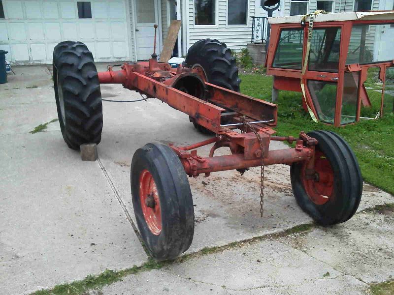

This is a Schwartz front end:But it's not installed the 'normal' way.
Normally, a Schwartz frontend of this flavor, would mount in such a way that the existing narrow-front steering pedestal was still in place, but with the wheels removed, and replaced with a steering arm that acts on rods to the steering knuckles.
The Schwartz company did NOT make front ends with the intention of being able to turn as tight as a factory WF.  They didn't even CONSIDER that as a concern... they built their front ends to make tractors strong enough to survive under the load of the Schwartz fully-hydraulic front-end loader... and be 'EASILY' installed and replaced from a NF farm tractor to change from wide-front manure-moving, to narrow-front picking corn... which AC, and virtually any other manufacturer, could NOT do.
While the factory wide front and narrow front may turn tighter, turning radius is a moot point when the nose of the tractor is on the ground with a broken steering knuckle, and a bucket of wet pooh  holding it down...  but I can assure anyone with no doubt, that the Schwartz (the one I own, at least) is substantially stronger than ANY of the OEM wide fronts prior to the D17...
