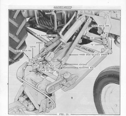

Brian G. NY View Drop Down
Location: 12194
Points: 2262
Post Options Post Options   Thanks (0) Thanks(0)   Quote Brian G.  NY Quote  Post ReplyReply Direct Link To This Post Posted: 11 Feb 2020 at 11:21am
Believe me, they can be "tweaked" to do it.
I don't know whether or not they are supposed to do it....I messed with the chain lengths
a bit to make it happen. Where I mow, it makes life a lot easier and you can 'trim" the small limbs on trees while you're mowing.
I don't even have a support rod on mine.
I cut my bar down to 5-1/2' to get around the scrub apple trees easier which probably makes it pop up a bit easier.

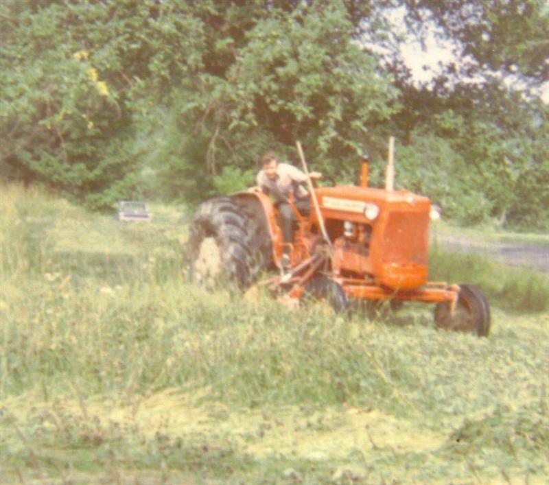

Neighbor farmer used to loan me a mower tractor every year to clean up around the property before I had a tractor of my own. The first one was an 8N with a side mounted Dearborn sickle mower that also raised vertical with hydraulics. Then, he got this nice D-17 with an 82S mower which he also loaned me.
The one thing that always amazed me was how he cut straight corners without stopping.
I had always thought that was possible only with a rear mounted mower.
When he came to a corner, he would pull the PD into low, hit the right brake and give the wheel a quick turn and the bar would come around and make a perfect corner without leaving a stalk of hay. Power steering was a big help in making this possible. This picture of me on the borrowed tractor was taken in 1965.
