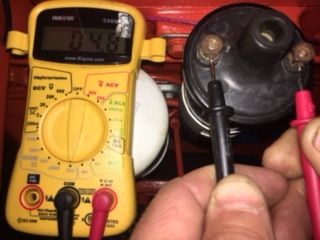

OK, just went out and checked. Tractor is currently setup with negative from battery to ground. Negative side of coil is on the left and has yellow wire from ignition on it, positive side of coil is on right with wire going to side of distributor. With no wires on coil, and meter attached with black lead to - side of coil and red lead to + side of coil, and meter set at 200 ohms I get a reading of 04.8. Set at 2000 I get 005. Set at Arrow+ sign on meter I get 003. I'll try to post those pictures later.
