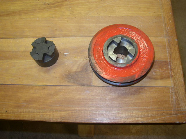

Joose, I used a lovejoy coupling. I don't know what a rag joint is. I machined the crank pulley to accept a coupling for a 3/4" shaft. The pump mount incorporates a larger tube in which the lovejoy resides.
If you're interested in specifics and pics PM me and we won't have to bother the rest of the world with our blather.
I have a "next generation" improvement that involves machining the crank pulley to become part of the Lovejoy coupling like this.

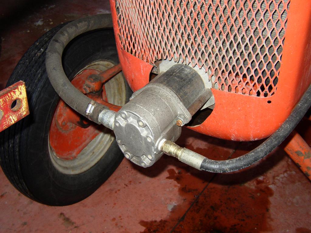

Joose, didn't get a pm from you so I decided to post a shot of the pump mount.
the large black pipe is sort of an extension of the pump mount ( the alu. plate mounted to the rad. mount) the lovejoy coupling is inside the short section of black pipe because there's not enough room in the rad. mount.
