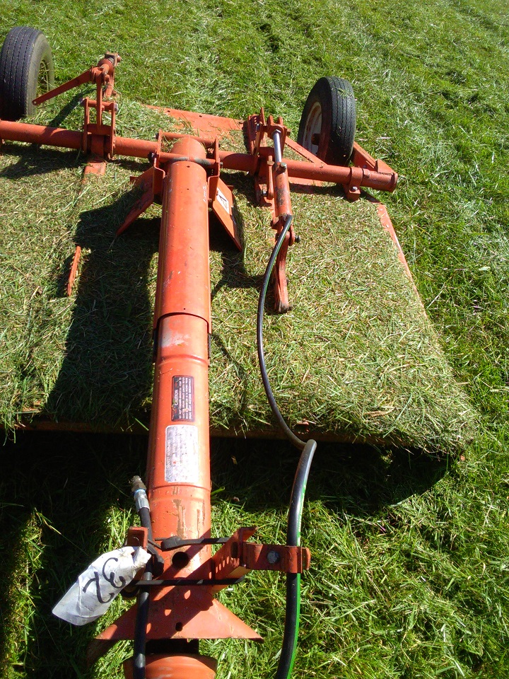

Opened up the fields with series 3 and the model 307.Then went to the A/C 172 on the 45d after some preventative maintenance on the mower,sharpening, greasing,checking gear box ,etc.Wow was I surprised how well these A/C mowers cut.A fun day listening to that old buda hum all afternoon.This is the mower from the Bill Mishler sale.A fun day with the new to me mower!!

Any reason the height adjuster is set to the rear bracket?  Mine was connected to the front, I never thought anything about that, and have just left it.

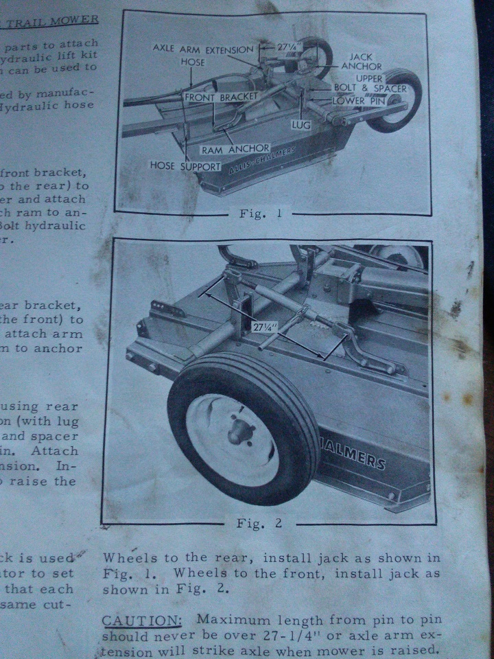

Which way are your wheels,to the front or the rear?The jack gets attached to the rear bracket with wheels in the rear position and to the front if wheels are to the front according to the operators manual,that's all I know.

My wheels are set behind the mower.  So, I guess, the jack should connect to the rear bracket.  Maybe that is better for keeping it level, as I noticed the front is lower than the rear of the mower deck.  Dave

Couple advantages to having the wheels to the rear,can cut closer and the weight of the cutter is on the rear of the tractor giving better traction.

Nice mower. Why isn't the hydraulic cylinder attached to the axle arm extension? I'm having one of those as well as an anchor being made right now so I can put a hydraulic cylinder on one. What's the serial number on yours?
I don't think the cylinder would raise it much if hooked to the long lever. They only travel 8in.

  Jim I pulled the pin on the cylinder to use the manual jack for the day.The hydraulics on the 45 diesel aren't working at this time so I was going old school for the day.The cylinder works great,just didn't have hydraulics for this run.I haven't been able to find the serial number.Where is it located?

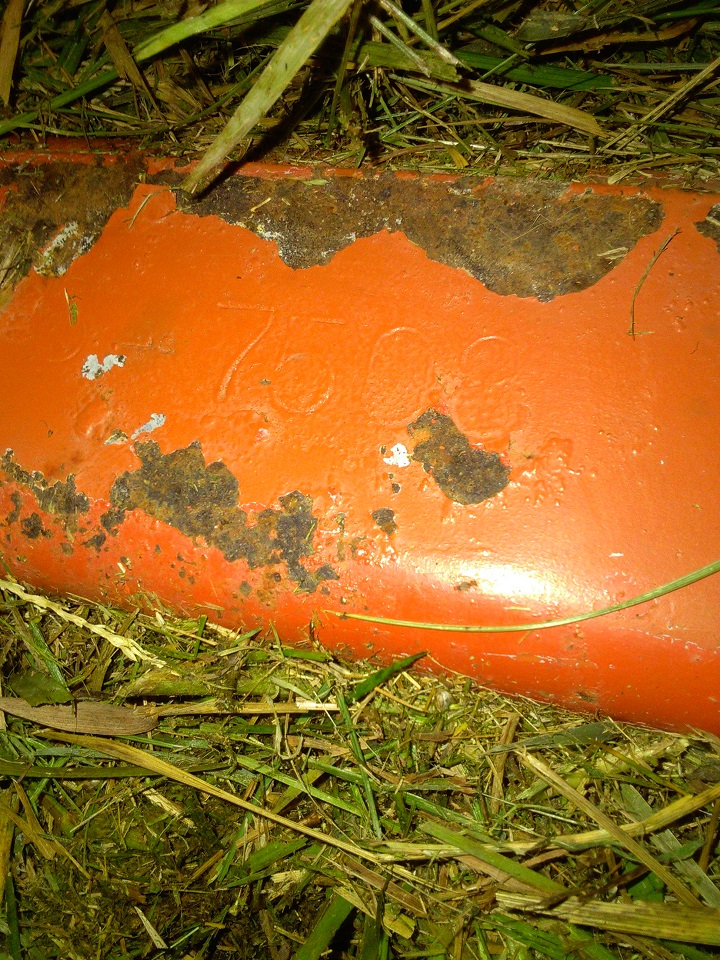

Jim, after looking at the manual again I found the location of the serial number.The info was in the "how to order parts" section at the beginning of the parts section of the book.Serial # is 6-7508.Here's pic  of inside the front cover of the manual and the number on the mower.Looks like original owner was Dick Koons.I guess Bill Mishler got the original manual when he bought it back in the day.This is the second piece of allis equipment that I have acquired with the original manual in the last eleven months.Don't see that too often.

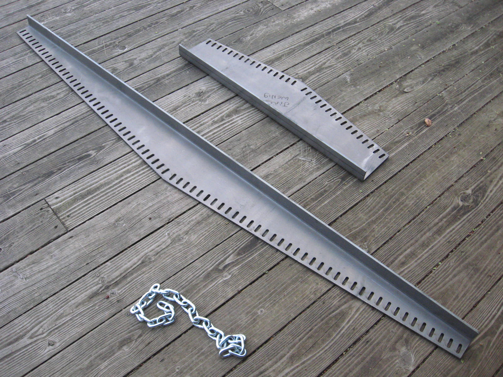

The shields were made by Schmidt Machine Co. near Upper Sandusky, OH. If you're interested, give Konner Holloway a call at 866-368-3814. He has these saved in his system. The only thing I'd change is to have the chain holes enlarged a bit. The chain fits in ok when unpainted, but needs some nudging when painted. Other than that they are perfect. You drill the holes.

Jim, WOW those look spot on the originals.Just might have to give those folks a call.Did you have the dimensions off the originals for them to work from?

Any idea of a rough cost for those brackets? Kind of tempting to get a set for my 172.

G_G, I"m in the process of checking my options for these.I'll let you know what I come up with.
