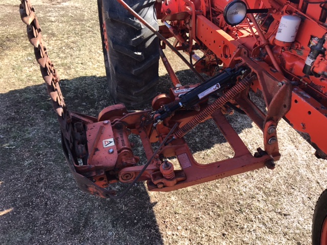

I just bought a side mount sickle mower for my WD 45. it missing a few parts. Does anybody know how long and the size of the lift hydraulic ram i need? Im also missing the pulley attachment for the pto shaft that goes on back of the tractor, and missing the belt guard for the drive pulley set up on the back. I know very little about this set up and any help would be great! Thank you!

8" stroke and I think mine has a 1-1/2" or 2" diameter.

I have a 82 S on my WD. I can get you some measurements tomorrow. I also my know of someone that may reproduce the rear shield for you.

Pulley at mower pto shaft is 5-3/8"x1-1/8" wide.
Pto shaft pulley on tractor is 7"x-1-1/8" wide.
Belt is 7/8"x 52" if I remember correctly.

Sorry for the double pic, and have no idea why it’s sideways
