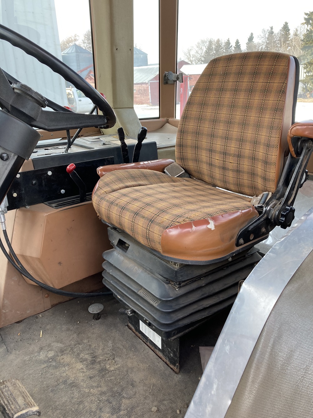

So,  I think I'm going to pull the trigger on a low hour 8070 that needs a full restoration and I'm putting together a list everything I'll need.  Does anyone know where I could source basically every knob on the right hand console,  throttle and all?
The range shifter knob is missing and the remainder are faded really bad.  Alternately,  does anyone know of a way to get the color back in the knobs?

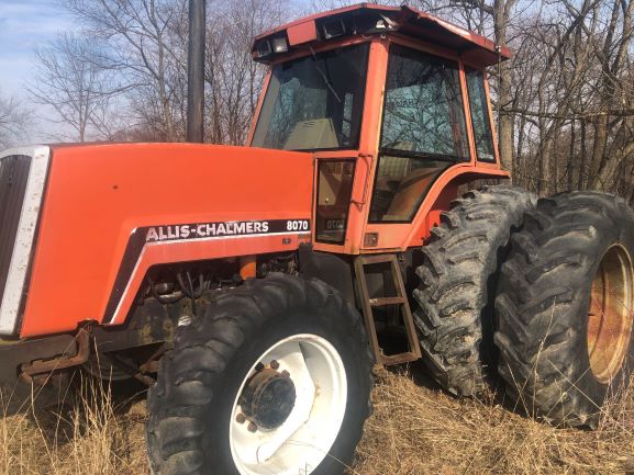

Well,  it's officially done.  I own the 8070 and I'm going to get it home tomorrow.  Here's a photo.  Will start on the resto this weekend.

Personally, I can't wait to see how this poor ol gal looks when your done. I have done 2 of our 8050 cab interiors but not in the factory sense.

Thanks, Leon.  I'll be sure to post pictures along the way.  With my family working on it with me,  I hope to have it field ready for second crop hay in June.  But,  as they say the best laid plans of mice and men.  It'll be a good addition to our fleet of AC iron and will help keep the hours down on our 8010 which can officially retire to a hay making tractor now!

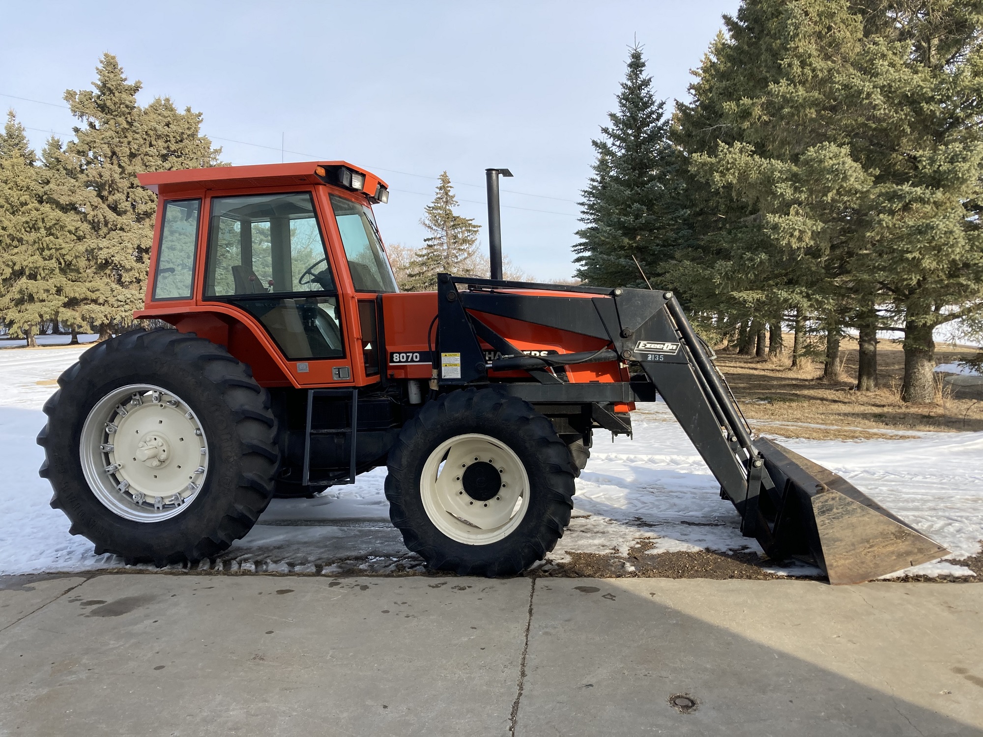

Thanks Steve. I will try posting my restored 8070 just for fun. This computer stuff is about as clear as mud! Sorry, can't get it sized right.[
