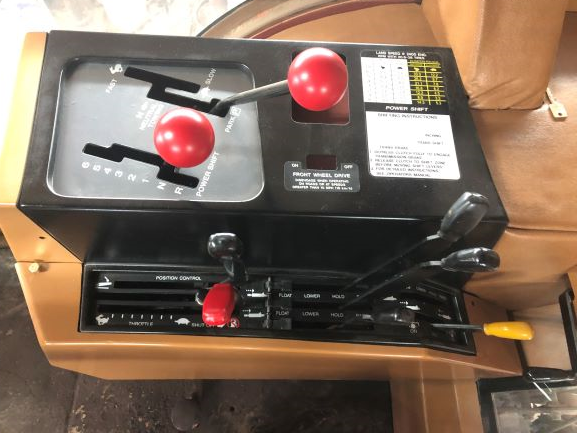

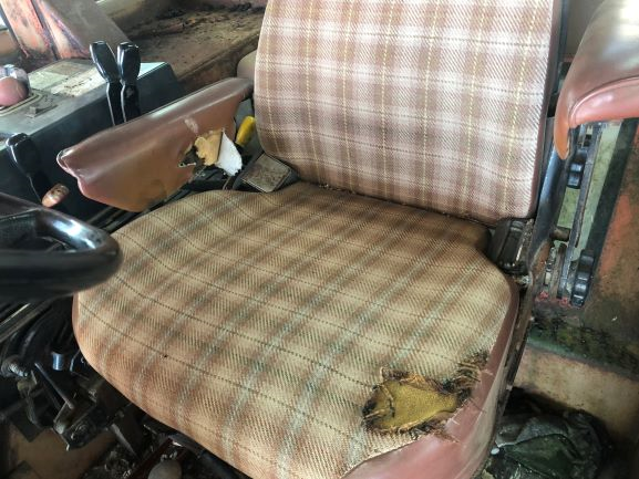

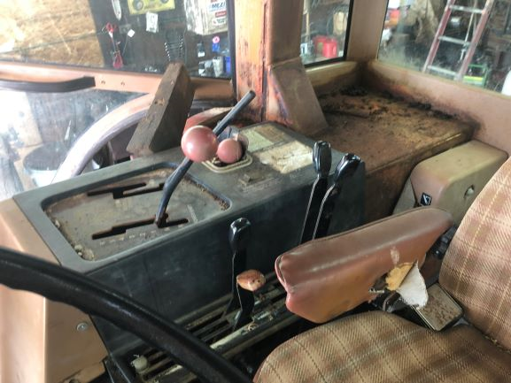

So,  I think I'm going to pull the trigger on a low hour 8070 that needs a full restoration and I'm putting together a list everything I'll need.  Does anyone know where I could source basically every knob on the right hand console,  throttle and all?
The range shifter knob is missing and the remainder are faded really bad.  Alternately,  does anyone know of a way to get the color back in the knobs?
Also,  anyone have a 8000 series temp and fuel gauge in good shape they want to part with?
Thanks!!

So,  basically the only things available from Agco are the shifter knobs and the shift gate.  This 8070 has no wear on the shift gate,  but I want to replace the one on our 8010.  It's wore pretty bad.
Guess I'll be trying to dye or paint the other knobs.

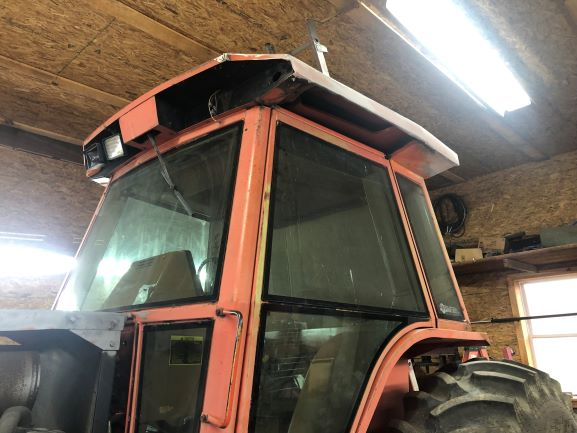

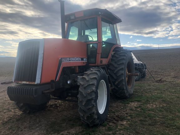

Well,  it's officially done.  I own the 8070 and I'm going to get it home tomorrow.  Here's a photo.  Will start on the resto this weekend.

Thanks, Leon.  I'll be sure to post pictures along the way.  With my family working on it with me,  I hope to have it field ready for second crop hay in June.  But,  as they say the best laid plans of mice and men.  It'll be a good addition to our fleet of AC iron and will help keep the hours down on our 8010 which can officially retire to a hay making tractor now!

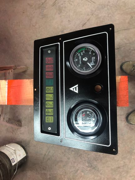

Posted By: xbk9576
Date Posted: 24 Mar 2021 at 10:21am
gauge you still can get from agoc 70277453v $173.00

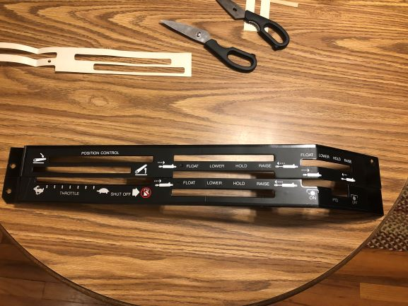

One thing I can't seem to track down is the decal that goes around the hydraulic, throttle, PTO, etc.  Other than finding one laying around NOS at a dealer, would anyone know where I could source one?
Posted By: Daehler
Date Posted: 24 Mar 2021 at 12:22pm
I have decal shop that does excellent work. I'm going to have a complete set of decals for 8000s made up this spring. I'll get pictures of the speed charts they've done for me.

Posted By: Transaxial
Date Posted: 24 Mar 2021 at 3:45pm
I did what Daehler did and it works out very well. If you get a good straight on picture of what you want in a decal a decal shop can make new ones almost as good as OEM. If you get a good side to side and up/down measurement of the actual decal you want made, they can scale it to proper size

So I found the 70270999 and 70264914 NOS at an AGCO dealer.  So that's the last of my decal needs!  I got the speed/shift instructions decals from member Gary(WI) on here and they are excellent.  While I was at it,  I had him make me one for our 8010 as well.
The final things on my list are trying out a couple different paint options for the tan color on the interior and then deciding what paint to use for the exterior.  I've been told to use Durathane from PPG.  Does anyone have any suggestions?

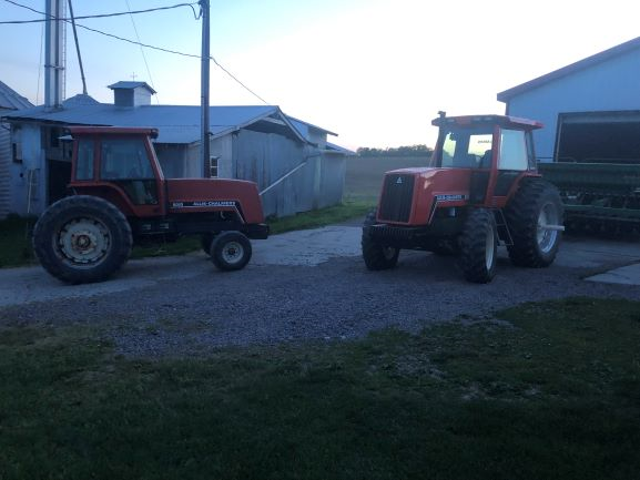

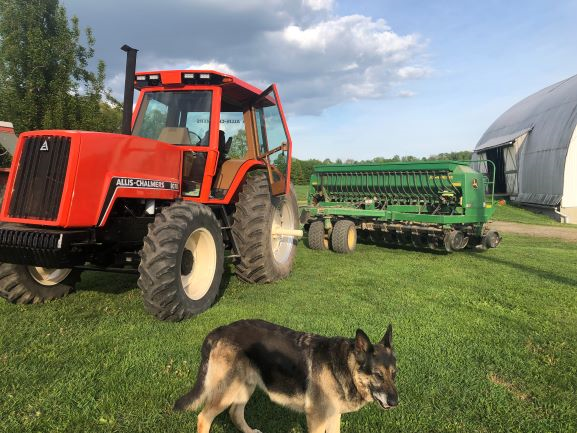

Thanks Steve. I will try posting my restored 8070 just for fun. This computer stuff is about as clear as mud! Sorry, can't get it sized right.[

Looks sharp!  What kind of paint did you use on the exterior?
Date Posted: 26 Mar 2021 at 10:54am
We have Cloverdale Paint in Canada and they have been very good at mixing a color that works for old Allis 8070, 8550 and IH 1206. The hood on my 1206 is original paint and decals and the paint on the rest of the tractor matches that very well. I could get you number codes if you can use them.

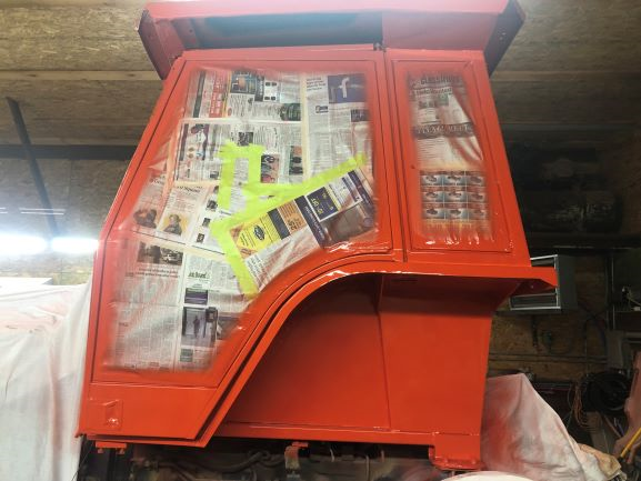

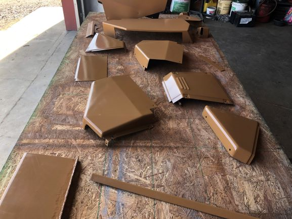

Posted By: PAFarmer
Date Posted: 30 Mar 2021 at 10:50pm

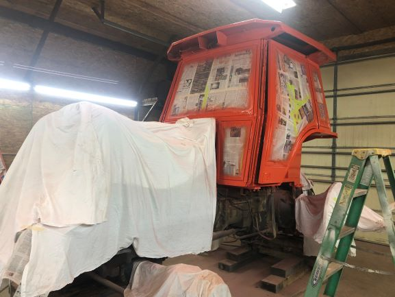

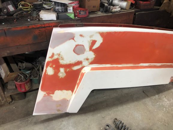

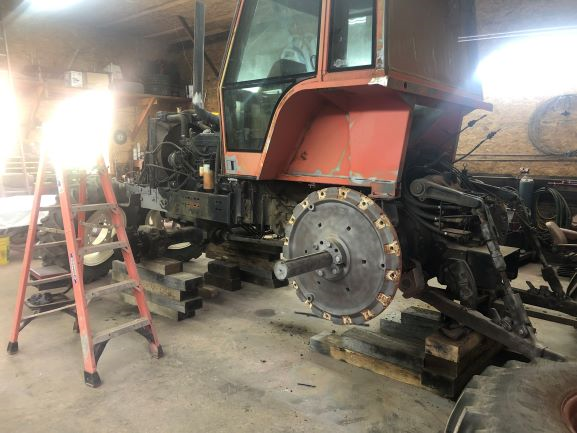

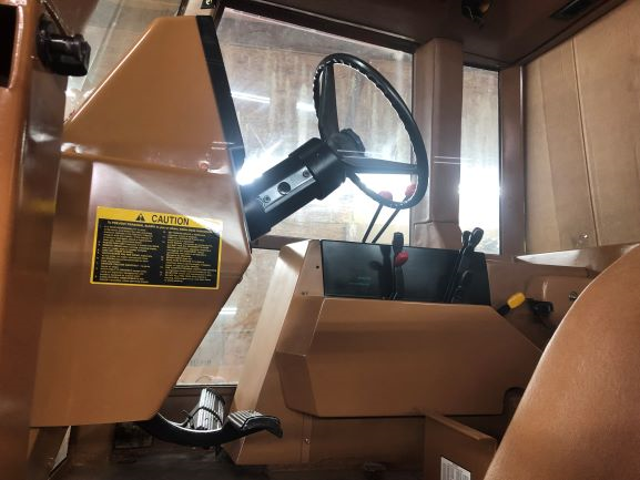

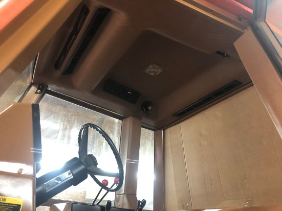

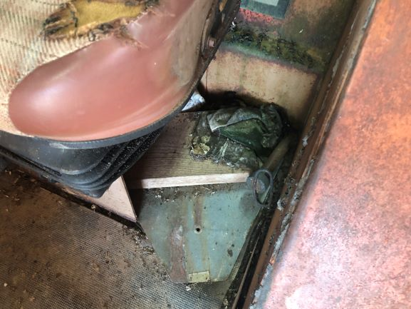

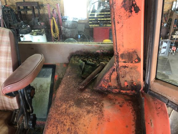

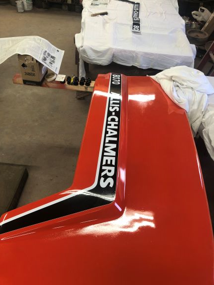

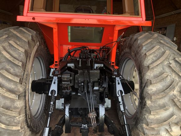

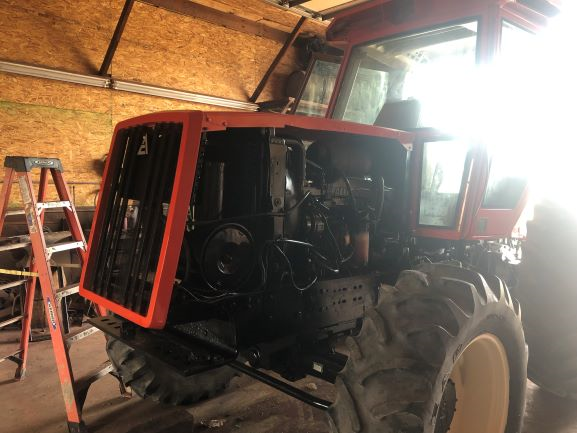

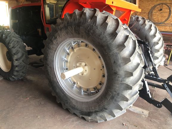

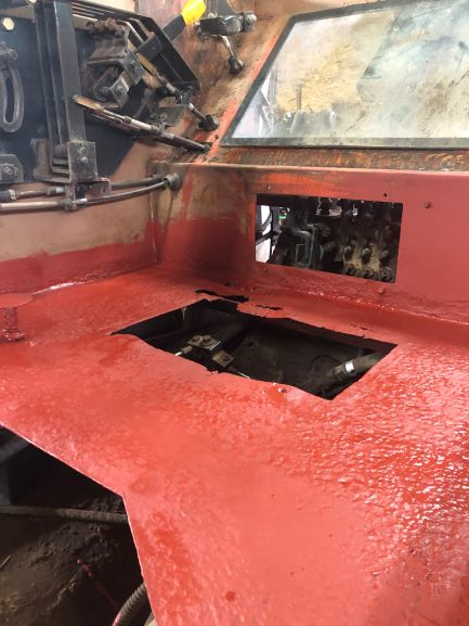

So,  update on the 8070 restoration progress.  It's been steady progress. First step was to take those ugly duals off.  I hate they way the look,  its a matter of personal preference.  More practically, they take up way too much room in the shop.

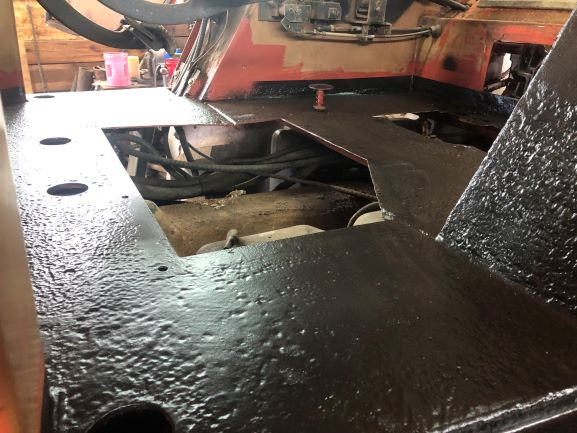

I've totally stripped the interior out at this point.  Man,  was the floor crispy.  Super rusted and pitted with a hole rusted thru in the back under the remote flow adjustment panel.  Here are some before shots of the interior.
So after several hours of work and about half a dozen flap wheels on the grinder,  I got the floor and most of the interior cleaned up.  Then I put down a thick layer of Rustoleum red oxide primer.  I hate applying that stuff, but you could pave a road with it and it does produce nice results.  After the primer,  I put down a good coat of rubberized truck bed liner to try and keep the moisture away from the floor.

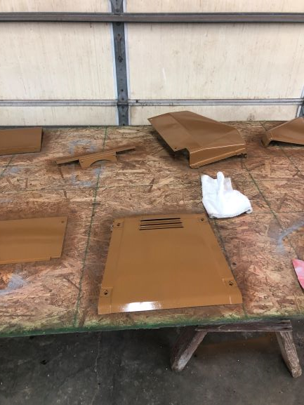

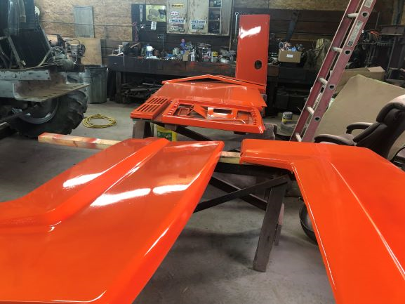

Next step was to track down a paint to repaint the saddle brown.  I decided the easiest way to do this was to borrow the traction booster cover from our 8010,  which isn't faded at all, and take it to the local Car Quest.  They scanned the inside of the cover with their color matching tool.  They mixed me several spray cans of SEM acrylic enamel so today I prepped and primed the interior parts that I could remove from the cab.  I used adhesion promoter before applying to the plastic parts.  I'm really, really pleased with the way it turned out!

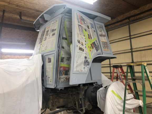

Tonight I took the rear glass out and took the doors off then masked the glass in the cab.  Next step is to prep and paint the interior of the cab.  The plan is to paint the non-visible stuff with POR-15 and the visible stuff with the same paint as the others.
I've managed to amass all the decals, upholstery, headliner and floor mat.  I also took the seat to a local shop to get re-covered.   I'll post more once I've finished the interior.  Hope to have that done by no later than mid next week.

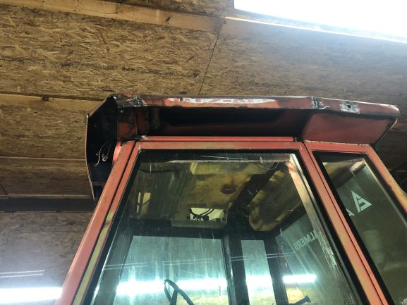

On an exterior note,  my dad fixed up the corner of the cab that had been accidently used by the previous owner to support the roof of an old barn in a wind storm.  For what my dad had to work with,  it turned out really great.  To get it much better,  we would have ended up cutting the side of the roof off of the cab and fabricating all new and that's just not an option for this project.  I'll do some smoothing with a very thin layer of bondo and it will look really good when shiny orange again.

Posted By: PAFarmer
Date Posted: 01 Apr 2021 at 8:31am

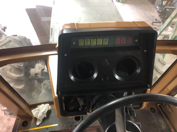

Thanks!  I'm going to get it as close to "factory" as reasonable for a working tractor! I wanted to pull the cab,  but time is not gonna permit that I don't think.  My biggest concern is the back of the cab behind the remote valves and things.  I think I can paint it reasonably well with a detail gun though.
Spent a solid 4 hours last night sanding the interior and that job is mostly complete.  There's still some hand work to get done in the corners and things.  Also have to hit some places with the handheld sand blaster.
I need to pull the steering column today, get it prepped and painted.  I've been putting that off incase I needed to move the tractor out of the shop,  but it's time to bite that bullet.

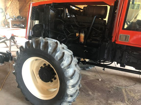

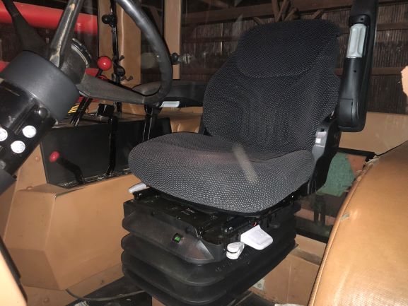

So it's been a few days since I've posted an update.  Progress has been slow but steady.  Trying to squeeze the 8070 restoration in between getting planters and hay equipment ready.  But we've finally got everything field ready and I spent the day putting the interior back together!  It's turning out better than I hoped.  Still waiting on a few odds and ends,  the black screw caps, the decal for around the head light and turn switch and the new fuel/temp gauge cluster.  Also waiting on some new speakers and a stereo.  Have to hand paint the silver trim on the dash also that goes around the gauges and the AC logo.
The cables aren't hooked up in the right hand console either because it will make my life way easier to mask the outside of the cab with them removed.

Wow!!  Your seat turned out really nice.  Forgive my ignorance, but did the 7040 have that red insert from the factory?  It's really sharp looking.
I took the seat from the 8070 to a local shop to get recovered.  I found a post on here that had a link to an Etsy shop that has fabric with a really close pattern to the original.  It'll be awhile till I see it back though as they do a lot of work on boats and this is their busy season.
We treated ourselves to a Grammer air ride setup and new seat in our 8010,  so I have the old seat out of it that I'm going to use temporarily.  I cleaned up the stock suspension from the 8070,  but I'm thinking it's going to get a air ride as well.  Spent a few hours in the 8010 the other day and it's worth it!

can you put pictures of air ride seat on here. Thanks
Posted By: PAFarmer
Date Posted: 13 Apr 2021 at 9:16pm
Here you go Mike.  It's a Grammer seat and suspension.  We got if from Abilene Machine.  Not the right color, I know, but it looks ok.  We just installed it a month or so ago and I only have maybe 2 hours in it,  but so far I'm really impressed with it's comfort.

PAfarmer, Can’t go wrong with an air-ride seat.
The later years (77’-81’) 70xx tractor’s Acoustic Cab II offered an optional “Luxury” seat. Yes it’s red fabric insert for “cooler in summer & warmer in winter” was original. It also contained back support, weight, & swivel adjustments.
When completed, please share photos of your restored 8070’s plaid seat.

I spent a solid 5 hours last night sanding old orange paint off.  All that's left to sand are the corner posts and door jams.  Then I'll put down two coats of POR15 on the roof tonight after the sanding so it has time to dry.  We're going to shoot the base and clear orange this weekend.  Black and wheels to follow shortly.
I can see the finish line on this one which is good as we're getting close to planting and it'll look good in front of the 15' JD 1590.
Posted By: PAFarmer
Date Posted: 18 Apr 2021 at 5:57pm
Update time.  This week was spent prepping the tractor for paint.  Hood,  Side Hoods, Roof cover and everything else orange that I could get off the tractor was removed and prepped.  The cab is also prepped and doors removed for painting the door jams.
Yesterday we painted the parts that I took off the tractor and man,  did it turn out nice.  I used PPG Omni which I have mixed feelings about.  The outcome was good, but the application of the base coat was a real pain in the neck.  It doesn't cover for crap!!  I read that it's a known complaint about the base and some colors are worse than others.  With all that said,  the finished product is really good looking after the clear went on.  But,  if I had it to do over,  I'd have went with PPG Deltron.
I also finished the instrument cluster.  I'm really happy with the way it turned out.  I hand painted the silver trim and AC logo with some Chrysler "Bright Silver" touch up paint I had from a Dodge Avenger I used to own.
Next step is to paint the cab.  Tomorrow's objective is to mask the windows, door openings and back window opening, then paint on Tuesday.  After that we'll block it up and remove the wheels so the black can be painted and also the wheels.  Hope I have enough cribbing blocks!
Things are really coming together and I'm starting to get excited for the outcome.  If things keep up at this pace I hope to have it completely painted and reassembled by this time next week.  Just in time to hook to the grain drill.

Great job. The dash - Wow! Are you opting for replacement LED exterior lights?
Posted By: PAFarmer
Date Posted: 19 Apr 2021 at 8:09pm
Thanks!  It was really fun seeing that dash come back to life.

Posted By: PAFarmer
Date Posted: 26 Apr 2021 at 10:34am
More progress to report.  It's been transformed into a real redneck tractor.  No wheels and up on blocks.
I applied the decals to the side panels,  and I'm really happy with that way those turned out!

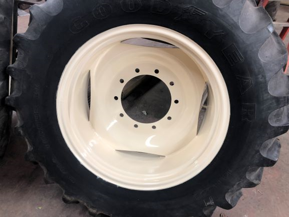

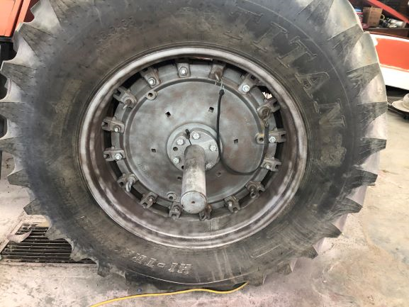

Painted the all wheels and such.  We made an executive decision and went with the cream color like the older 7000 series and such.  Never really thought the white was an improvement.
Also primed and painted the cab orange.
The final step is to paint the frame.  Just have to wait a few days for the cab to cure and then I can cover it,  wash it up and then prime and paint.  I'm a little over a week behind schedule,  but we're getting there!

Looking great, especially your painted wheels. I also agree about the cream paint versus white paint on the wheel rims, What do use to wipe overspray from tires or do you tape/cover tire with paper? I’ve had good results using paint thinner on an old rag(inside out tube socks) to clean/wipe tire of any paint overspray immediately following paint shoot so paint doesn’t dry on tire.
Posted By: PAFarmer
Date Posted: 27 Apr 2021 at 7:16am
I use tape and newspaper,  which takes forever.  The rears take twice as long!  I've tried the wipe off method, and it seems like no matter how hard I try I always end up getting fuzz in the paint or something like that.  So I bite the bullet and tape everything.

Been following your 8070 project. What did you use to repair your hood side panels? Have any suggestions on paint prep for the side panels and grill? My panels have a few cracks and corners rounded off. I am putting a D21 puller together with 8070 sheet metal. What do you suggest for paint and primer? Want to get away from van sickle pant and get something durable. Sounds like you have experience.
Posted By: PAFarmer
Date Posted: 03 May 2021 at 12:38pm
For the side panel repair,  we use Bondo fiberglass repair with the mat and resin.  Then we cover that with a thin layer of putty.  We've used it on several tractors in the past with good results,  it's held up well to field use on our 8010 and 6060 which had the same problems you were describing.
Regarding the prep,  we sand down the old paint nearly all the way off with an air DA sander.  I posted a picture of the panel ready for paint back on 4/11.  It's the same for the fiberglass grille ring,  but that tends to require some hand sanding cause of the nooks.  What grit sandpaper to finish with will depend on what primer your end up using.  It will say on the primer tech sheet.
As for paint,  we've tried several over the years.  My grandad painted our 8010 with Agco brand paint.  I don't know who makes it,  but it's just a single stage enamel.
They look good at first and then fade really quick.  It's also just not very durable at all.
We used a Nason two stage base/clear on our 7000 as our local car quest had a paint code for Persian Orange II.  It shot on OK and seems to be holding up, but I couldn't get a cross to Corp. Orange in Nason for the 8070.
I can tell you that for the 8070 I used PPG Omni line for the orange parts and the cream of the rims and wheel centers.  For the etch layer I used the Omni MP170 Epoxy primer covered with MP282 high build for the Surfacer layer.  Then Omni MBC for the base coat and Omni Quick Clear for the clear.  Talk to the folks at your local PPG dealer as they'll tell you exactly what to use as far as hardeners and things are concerned as it matters based on temperature and things.  For the black frame I used PPG Drathane which is supposedly a really tough paint.  For the silver rear wheels,  I used Rustoleum aluminum colored paint thinned with acetone and spayed on.  Then hit it with a layer of Rustoleum clear.  Couldn't bring myself to spend the money on the Omni for them.
I will say this about the Omni system,  I'm told it's durable but I do have to say I did not care for how the base covered.  While the finished product is nice,  it seemed to take a lot of paint.  If I had it to do over,  I'd have used the PPG Deltron line.  That would have been a small challenge as the PPG codes for the Corp. Orange don't cross into the Deltron line,  so it would require doing a spray card of the Omni or the Agco paint and then taking it to a PPG dealer so they could use the spectrophotometer to cross it into Deltron.  I'm told the Deltron is just a much nicer system to use,  but I can't speak to this myself.
With all that in mind,  I am amateur at all this body work stuff.  I've painted several cars and a few tractors with my Dad's help.  He did body work professionally for a decade.  But the paints and technologies have changed a lot so he's not up on all the new stuff.  So be sure to ask the pros at the PPG dealer what to use for sure!

It's been a productive week!  The 8070 is starting to look like a tractor again and the todo list is approaching manageable levels.  It's a rainy day here today and I should be able to make a good effort at getting the tractor done.
Paint is finished.  All that remains is reassembly, wiring for more lights, GPS and Auto Steer.  Change the oil in the transmission and rear end also.  I am planning to swap the tractor over to the dual 540/1000 PTO but I think that's going to wait until planting is done.  We'll see how much progress I make today.
Here's some pictures of the finished paint!
I am really pleased with how things are coming together.  I'm happy I went with the cream color on the front wheels and the rear centers!
Engine oil and all the filters on the tractor have been changed.  Changed the oil in the front end completely.  Unless some really unforeseen pops up,  it'll be field ready by the weekend for sure!  My dad and I are both working on putting it back together so things are moving fast.
With any luck,  my next update will be the finished product!

Posted By: PAFarmer
Date Posted: 21 May 2021 at 6:31am

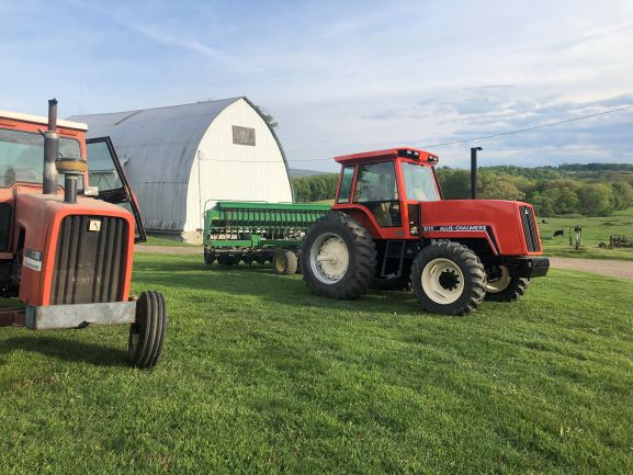

Final update time.  We've been busy with planting and I haven't had time to post.
The 8070 is back together and I've done a fair amount planting with it and the 15 foot drill.  Things seem fine other than the 2 up to 3 and 4 down to 3 shift is sluggish under load in high range.  It takes a few seconds to get into gear.  Especially the 4 to 3 down shift.  That's something I'll have to dig into cause it's a real pain in the neck on the road.
I'm really happy with how it turned out!  It's a really nice tractor to run.  It's more than enough tractor for the 15 foot drill but doesn't seem oversized.  In our hills,  the power and 4WD is nice.  Our other 4WDs are usually busy on the corn planter and other planting related tasks so the drill ended up on the 2WD 8010 and it was a real handful for it full of beans on the hills.
I'll put together a post will all the paint codes and different things once we wrap up planting.
The 8070 and 8010 hanging out.

Hey Soggy SEM paint is a paint brand all I can say.  I've used it for painting interior plastics and they carry a line of rattle can OEM matching colors.  It seems to be flexible as I understand certain SEM paints are made to be used on car seats and vinyl interior.
Robert
http://www.allischalmers.com/forum/forum_posts.asp?TID=82702&KW=structures&title=structures-1964-allis-d15-series-ii" rel="nofollow - 1964 D15 Series II
Posted By: soggybottomboy
Date Posted: 23 May 2021 at 4:46pm
Thanks for the clarification guys. PA farmer,your 8070 looks very nice. Hard to believe these tractors are almost 40 years old.
Posted By: PAFarmer
Date Posted: 28 Sep 2021 at 7:39am
Hi Soggybottom,
Sorry for not replying sooner!  It's been a busy year.
SEM is indeed a brand of paint.  I used their ColorMatch system for the interior because I was able to take some interior parts from our 8010 that isn't faded to our local SEM dealer and they matched the color for me.
I also used their ColorCoat product and related adhesion promoters to re-paint the black trim pieces and the various knobs and things on the interior.  I've used SEM products on some car interiors that I've redone in the past and was pretty please.  I'm happy with the way it turned out on the 8070 as well.
