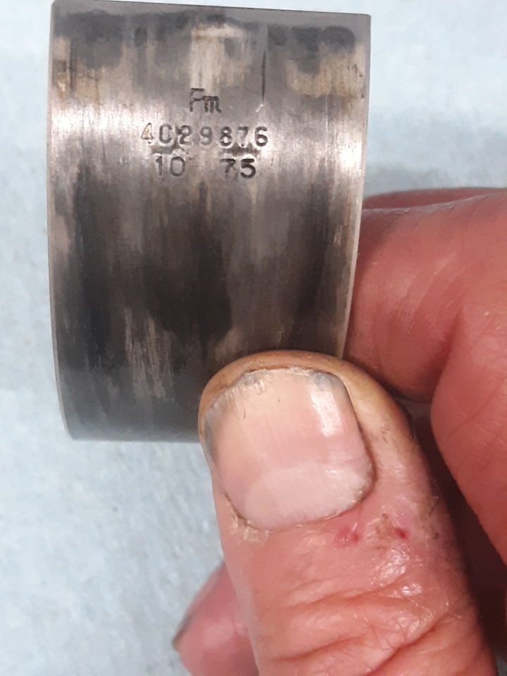

Very early in the tear down. Pulled #4 rod cap off
Anyone know what the numbers mean? .010 under? The rod bolts are 12 point heads. Is this original? I think ARP bolts are like that.
Points: 22861
Post Options Post Options   Thanks (0) Thanks(0)   Quote DrAllis Quote  Post ReplyReply Direct Link To This Post Posted: 09 Feb 2024 at 5:05am
October 1975...std size
Points: 9005
Post Options Post Options   Thanks (0) Thanks(0)   Quote SteveM C/IL Quote  Post ReplyReply Direct Link To This Post Posted: 09 Feb 2024 at 7:49am
There were 12 point bolts before ARP showed up. ARP is stamped in the head.
Points: 9005
Post Options Post Options   Thanks (0) Thanks(0)   Quote SteveM C/IL Quote  Post ReplyReply Direct Link To This Post Posted: 09 Feb 2024 at 7:52am
That brg appears to have no tin coating. Have seen car engines that way in 70's and 80's
Points: 22861
Post Options Post Options   Thanks (0) Thanks(0)   Quote DrAllis Quote  Post ReplyReply Direct Link To This Post Posted: 09 Feb 2024 at 8:27am
That's the way Federal Mogul bearings were. The Clevite brand bearings were 3-layer (tin-aluminum-brass). The 7080's were the first to get the Clevite bearings in the very late Fall of 1974. Kind of surpised this engine didn't have them instead of FM bearings.
Points: 9005
Post Options Post Options   Thanks (0) Thanks(0)   Quote SteveM C/IL Quote  Post ReplyReply Direct Link To This Post Posted: 09 Feb 2024 at 11:44am
Who knows...my 83 8070 still had an original front upper main shell which was FM and it was tin coated but the rods and other mains had been replaced with Clevite 112's

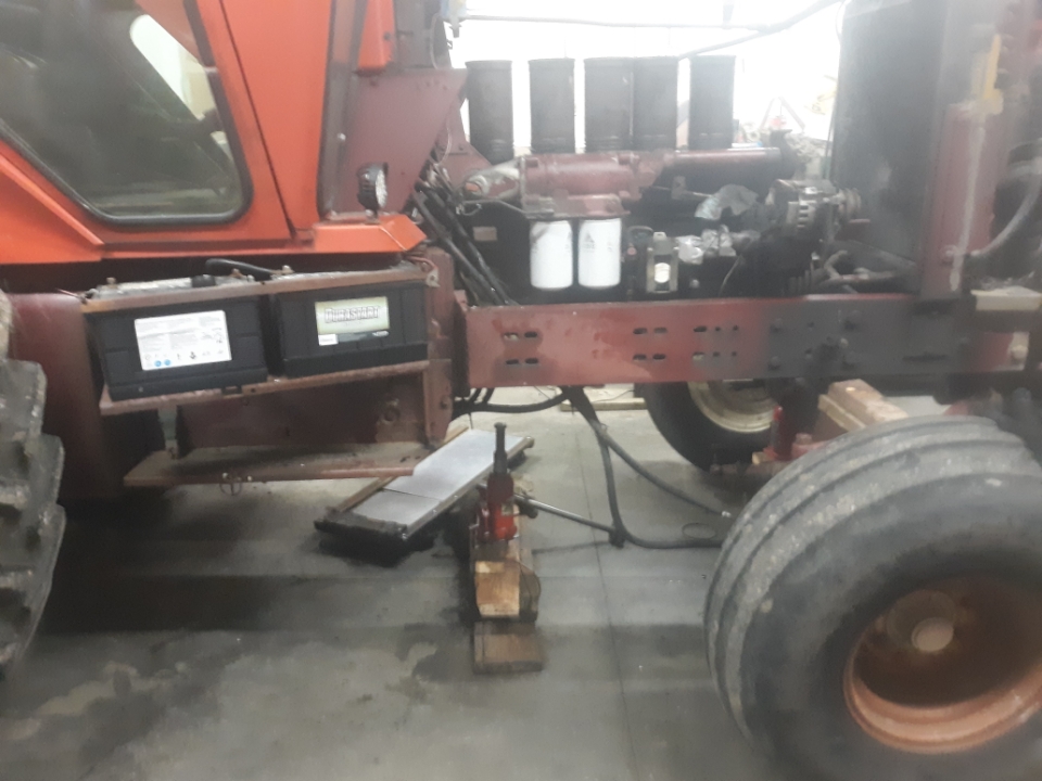

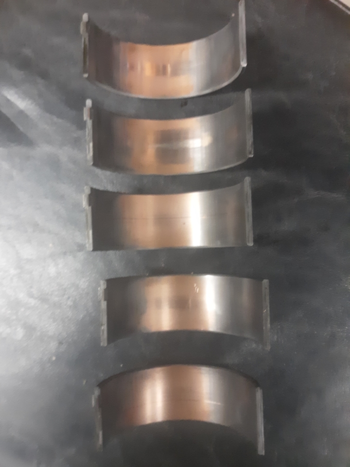

A solid 10 hrs today and am down to ready to pull sleeves
Pistons are scored on some, more than a half dozen broken rings
These are the top half of rod bearings

Couple of things. I use a hydraulic jack and a fairly big rod to push the sleeves out from below. It might be a good time to get the radiator checked out. Scored cylinders can certainly come from overheating. It looks like the tractor is still using the luber finer filter setup. Those things can leak when you least expect it and cause even more headaches. I would be looking for an 8000 series bypass filter or depending on the work load, just eliminate it.
