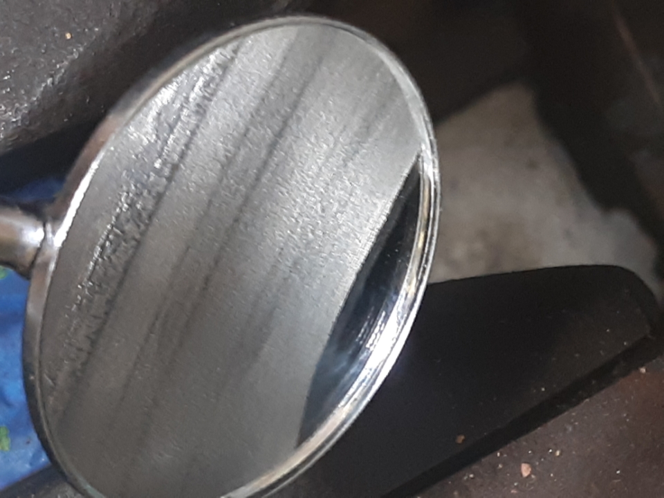

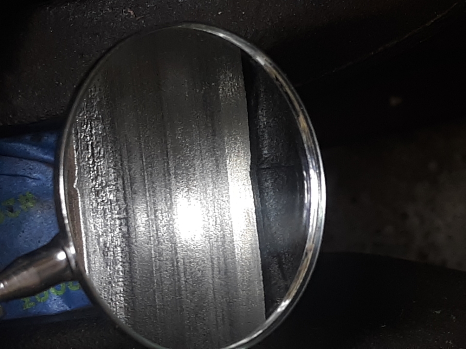

Posted By: plummerscarin
Date Posted: 10 Feb 2024 at 9:13pm
A solid 10 hrs today and am down to ready to pull sleeves
Pistons are scored on some, more than a half dozen broken rings
These are the top half of rod bearings
Posted By: Lynn Marshall
Date Posted: 10 Feb 2024 at 9:56pm
Couple of things. I use a hydraulic jack and a fairly big rod to push the sleeves out from below. It might be a good time to get the radiator checked out. Scored cylinders can certainly come from overheating. It looks like the tractor is still using the luber finer filter setup. Those things can leak when you least expect it and cause even more headaches. I would be looking for an 8000 series bypass filter or depending on the work load, just eliminate it.

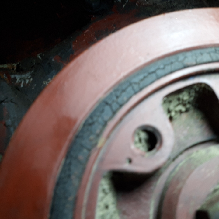

Date Posted: 23 Feb 2024 at 9:55pm
Since MrSnerdly asked, here's a shot of the dampener
That's probably not a good thing
Posted By: MrSnerdly
Date Posted: 23 Feb 2024 at 10:22pm
I would definitely replace it it it were mine.  I used to think that it was foolish but after selling the 4640 to the guys that rent most of my ground had the crank break, I think it is a wise investment.
Posted By: DrAllis
Date Posted: 24 Feb 2024 at 7:13am
I would bet the Deere had a "fluid/viscous" damper and that is what they are known for. It is recommended to replace them at a certain hour interval to prevent crankshaft breakage.  That 7060 damper is OK fine because it hasn't slipped/moved and is of the rubber type design, not the silicone fluid, which hardens or leaks out of the damper shell, making the damper useless and breaking crankshafts.
Date Posted: 25 Feb 2024 at 10:22am
There's nothing wrong with the pulley in the picture, as far as I'm concerned. The inner part of the pulley is secured with a key on a tapered shaft with a large bolt and washer. Really not much to go wrong there. The outer part can slide in or out,off of the rubber ring. Moving out can cause belts to come off. Moving in is more common and it can eventually start rubbing on the aluminum timing gear cover, creating a leak. All of pulleys,if original, are bound to have that weather cracking look in the rubber ring.
Posted By: DrAllis
Date Posted: 25 Feb 2024 at 10:56am
As with anything 40+ years old and 10K+ hrs on it, I would always keep a watchful eye on the damper and belt alignment. At least every oil change take a look, or daily if you're more inclined. I've seen them fail with half those hrs of service life, so you never know. But to just replace it because it's old ain't a good reason in my pocketbook.

The rough part measures out above the top O ring. All cylinders are similar though there does seem to be some staining I can't remove using a green scotch ball and drill
