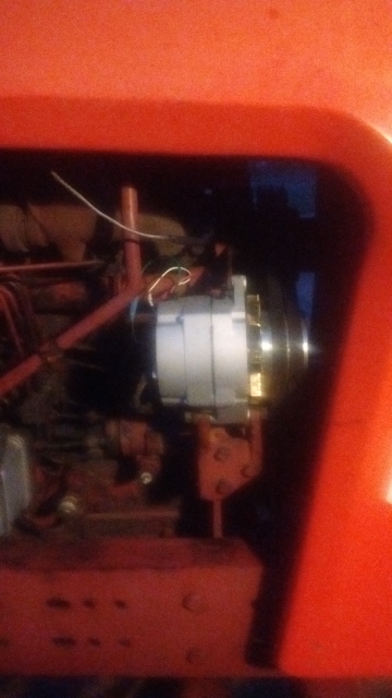

I got a new alternator from shoup, itsa delco replacement.$173.00, so all is good with the electric things
I'm gonna keep that darned Niehoff, I know theres got to be gold in it somewhere....

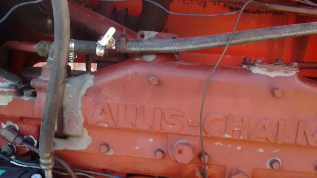

also got new heater hoses with a shut off at the engine

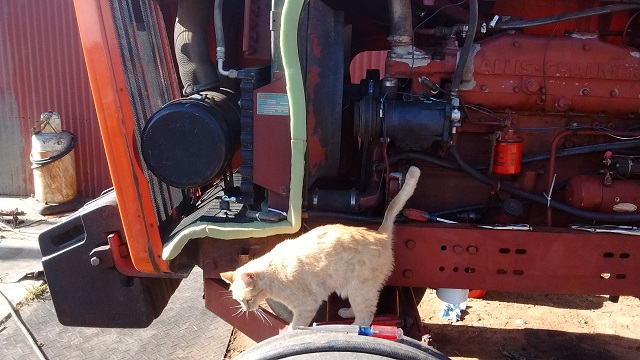

my helper Marley
as you can see new foam for the radiator, got a fresh oil change(had to get the bypass filter from AGCO, its been discontinued every where else I looked)new air filters

Nick, I got the shut off valve at local parts store, itsa just a generic heater shut off valve.. a ball valve would work also, and be nice, only 1/4 turn off/on,, but parts store didn't have one when I was there, ya can go with 1/2 or 3/8, jus get the barbs for whatever size hose, ya could hard mount the ball valve on one side..
