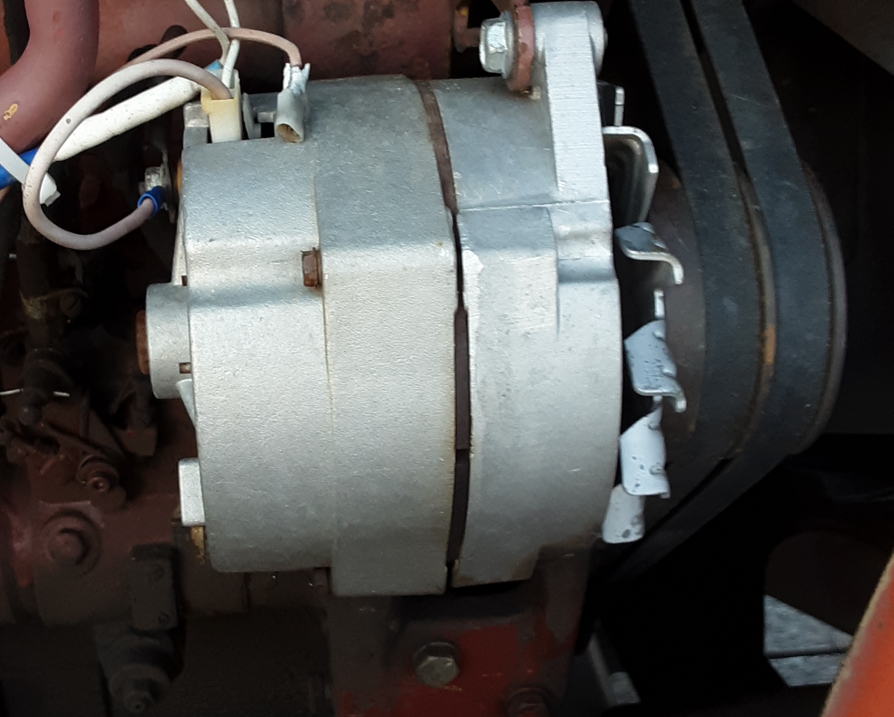

Thanks, didn't have to do much maintenance on the 7580, oil changes and a muffler, set the power adjust wheels out for the plow. So I really don't know much about these outside what I'm reading online.
Is this the expensive alternator?

The weep hole is supposed to be there, it tells you if your o rings start leaking.
The alternator in the picture is a "cheap" delco style.

Post Options Post Options   Thanks (0) Thanks(0)   Quote T in ne Quote  Post ReplyReply Direct Link To This Post Posted: 20 Aug 2019 at 11:24am
Thanks. Only getting 13 volts at idle, up to 13.5, so it probably needs replaced.
