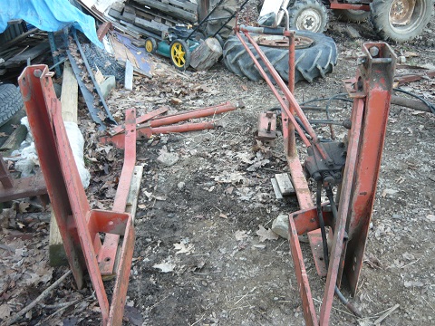

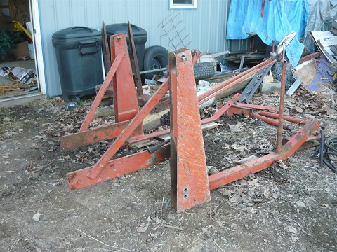

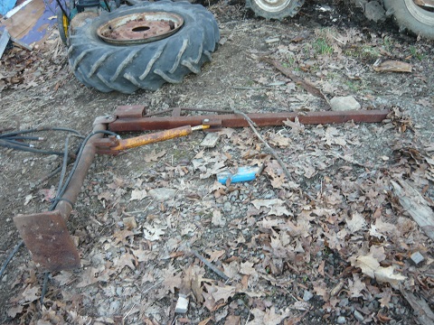

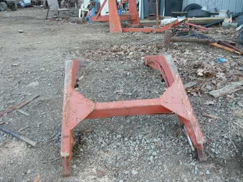

This was supposed to be the rest of the loader assembly for my d14.  But when Ed showed up to haul the tractor he immediately noticed that they are two different loaders, sure wish I had that type of knowledge.  He believes it's a model 500 (the one NOT on the tractor).  The one on the tractor has a tag that says 5214?  this last picture I have no idea what it's supposed to be, but it came with the tractor so, I figured what the heck. basically I need to know what I need to put the loader on the d14.

Bottm picture looks like a lift to mount in rear of pickup.

A 500 loader will not fit on a D14

Well you have some 500 loader parts to sell.What is the width center to center where the loader arms mount on the frame on your tractor? I have a loader front here off a D15
that might work,we can do some trading as I have a 500 loader on the gas 180.

that is a 445 loader

X2 to above. Mounting brackets for a 500 loader are different.

what ever model it is it seems to fit my d14.  both sides of the loader frame are on (gotta drill some new mounting holes) the braces that go from one side to the other and the rear portion u bolted to the rear axle.  The only thing we had to do is cut a piece of angle to bolt to the rear portion of the frame so the u bolt would go around the axle were there wasn't some sort of hump or bump in the way and make u bolts.
next I'll be hooking a pump to the front and running it off the crank shaft pulley for live hydro's.  I have a pump and fortunately the d14 has 2 holes in the front to mount a bracket.
