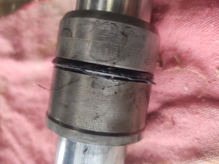

The first cylinder had a severe leak.  However, I think I am missing a flat rubber ring in the collar after reinstalling.  When I went to do the second cylinder, I found the flat rubber ring in the collar.  It was missing in the first collar.  I didn't see a flat rubber ring in my rebuild kit.  I also ended up with two extra parts.  I couldn't figure out where they would go.  My guess is that this rebuild kit is for other cylinders too?  See the pictures below.  I don't really want to take it apart at this stage but I rather be done with it so I might.  My guess is that the Oring will slip around in the groove and eventually have the same situation.
First collar.  Notice the badly mangled O ring.  Maybe because the flat rubber is missing?

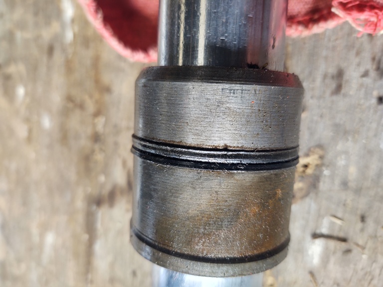

Here is second with flat rubber before i replaced the Oring.

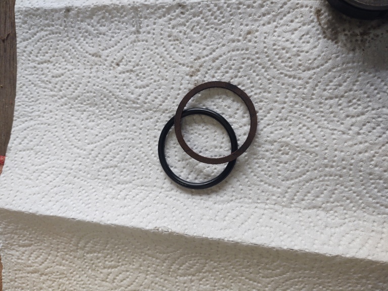

Here are the extra parts.  Made me nervous but when I disassembled there was nothing that matched.

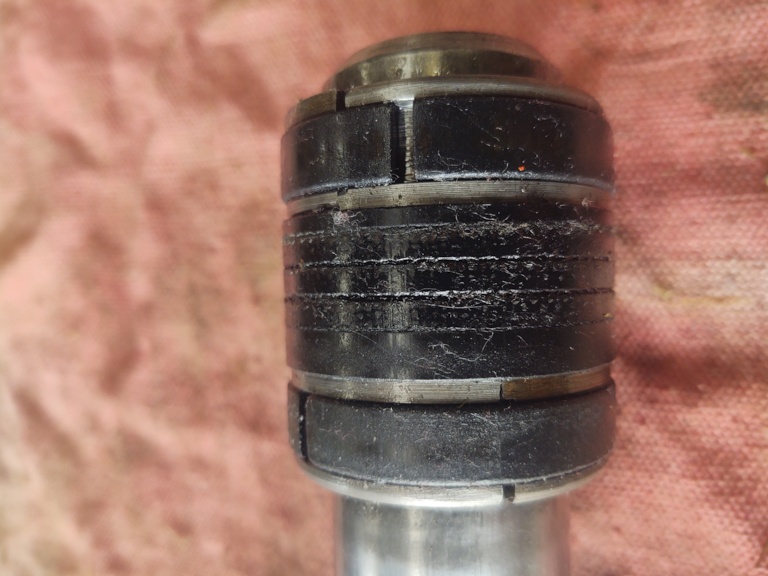

I could never wrap my head around how the bottom rings stay together until I pulled it apart.  This is what I started with in case others might not know what it looks like.

I called A&W and they said the extra parts are for the inside of the collar.  I didn't replace the inside because I didn't see a matching part.  They didn't look mangled either.  I guess the hard brown washer and the smaller Oring can be used in place of the hard plastic ring I saw.  See below picture on what I saw.  As well, A&W also said there is only one Oring on the outside of the collar so I shouldn't have to take it apart.  Now that this is clarified, I will take the tilt cylinders apart.

Looking at your pictures, the part you are referring to as the Collar is actually called the Bearing. It doesn't move and is held in place by the internal 'Retaining Nut'. The Outer O Ring seals the Bearing to the Cylinder Wall.
The smaller Internal O Ring seals the Bearing to the Piston Rod / Shaft.
This is where one of those flat Washers goes.
It is referred to as a 'Back-up Washer', and goes in the Bearing inside groove before the O Ring.
The Back-up Washer goes next to the O Ring on the side towards the Nut.
The Packing Set ( often called Chevron Seals because of their shape ), the 2 wide, flat 'Wear Strips', and the matched 'Bearing Halves - all get assembled to make up the 'Piston'.
Hope this helps you to better understand the terminology and assembly for overhauling the Lift and Tilt Cylinders used on 400 Series and 500 Series Loaders.

The top row centre would be the 'Back-up flat Washer' for the smaller inner O Ring inside the Bearing ( Re: Collar )
The top row right end would be the 'Wiper Seal', next to the Nut.
The centre row centre is the inner O ring and requires the 'Back-up flat Washer.
It's purpose is to squeeze the O Ring and force it to seal tighter against the shaft and to the Bearing Groove.

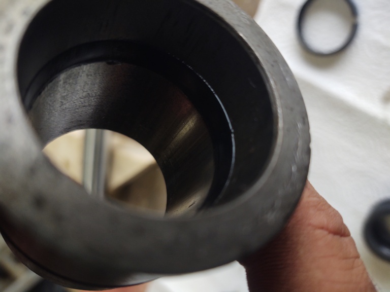

How would i feel way down into the cylinder for nicks?  Not sure my hand or arm can go very far into it?

No not way down in the orange cylinder, just the top 2 inches or so, where the 'outer O ring will travel "while you are installing the 'Bearing'.
Once you install the top Bearing and it is seated in the recess at the top of the Cylinder, the Nut holds it in place and the outer O Ring will never move.

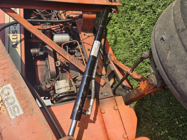

Another update on this issue.  After about 3 weeks the cylinder started leaking again.  So, I replaced the seal kit based upon Alex's A & W Tractor videos thinking I did something wrong.  After doing it twice, I decided to get some professional advice and it turns out that my rod has a slight bend in it.  I noticed that it did not leak when mostly retracted and did not leak when mostly extended but leaked in the middle.  Apparently, the cylinder didn't leak after I put the new seal kit in it because it needed to be used to wear the seal by the bend.  The consensus is that if I installed it incorrectly, it would have leaked immediately.  To replace the rod it was estimated to cost about $500 per cylinder.  One was way worse than the other.  So, I decided to look around for new ones.
I found Majister Hydraulics (that claimed to be made in Europe and not China) bought a 2 inch bore by 36 inch stroke cylinder and it fit perfectly as the lift cylinder.  The rod diameter is 1.25 inches versus 1.5 inches on the original cylinder but it seems to have plenty of power on lift.  It is way more controlled on up and down now.  No leaks either.  Best of all I got it for $209 and free shipping.  I am probably going to replace the tilt cylinders next.  I measured the maximum lift height and it is sitting at about 133 inches so very close to the original cylinder on a 190xt.
The only thing I miss is the metal line going to the top cylinder inlet like the original.  I had to zip tie the hose to keep it stationary.
Ignore the worn out tire, that is getting replaced too.  Driving on the road too much has worn it out.
Here it is installed:
