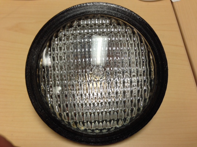

Have an abundant supply of sealed beam bulbs and need new lights on the WC I'm getting running. Nobody makes direct replacement sealed beams for the original housings. I have seen hose wrapped around sealed beams to take up the gap.

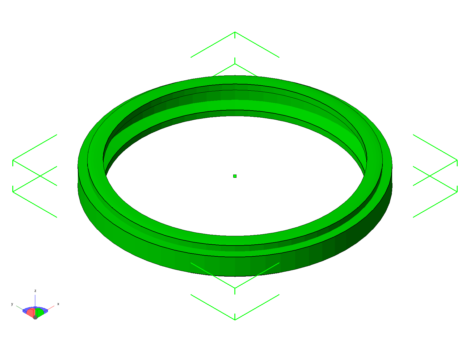

A little time on tinkercad and I drew up this adapter. I am 3D printing it now out of flexible black TPU filament. Will know Saturday if they fit when I'm back at the tractor.

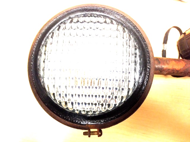

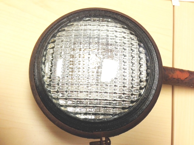

Here it is installed on the sealed beam. Took 4.5 hours to print it.

One more final tweak and I should have it. Need to fill in a slight gap on the clamp on the front of the ring. I am making it slightly thicker to take this gap up.

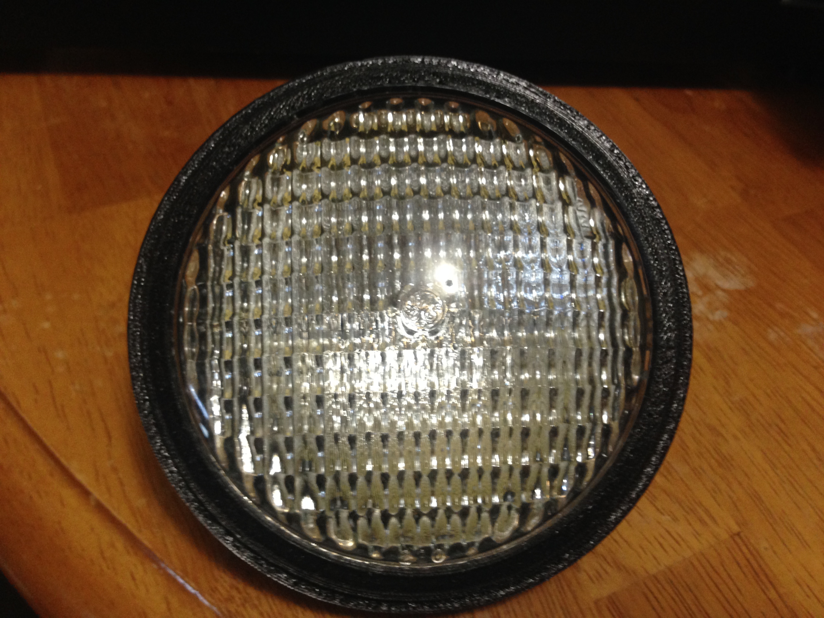

Final version complete. This version took 6 hours to print with the support material needed to create the inside groove. I lowered the print temp and increased the top am bottom layers to 3 to fill any holes that were showing on the first version.
