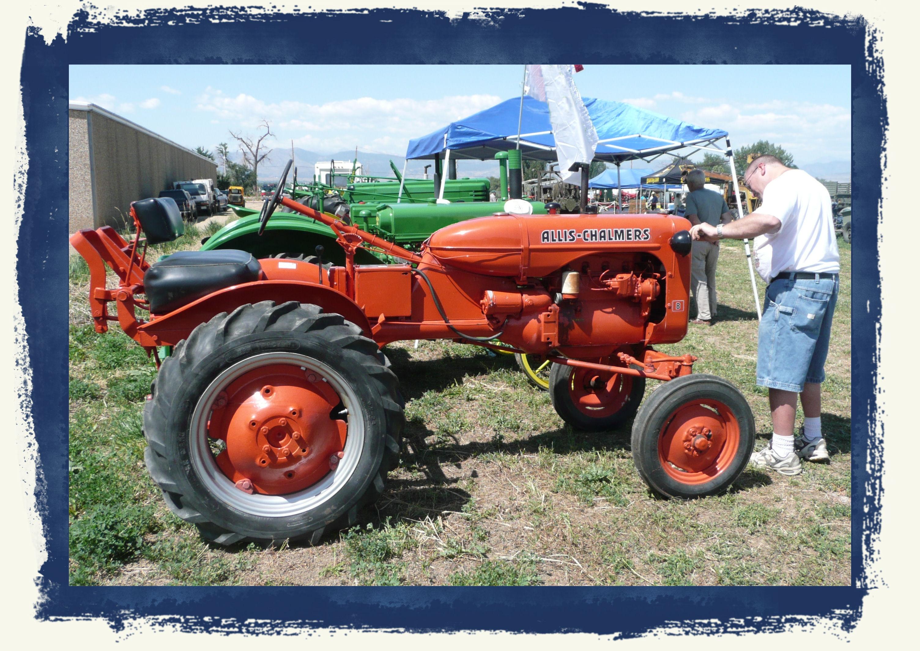

Mine has black short letters and the seat has been re-done, as has the whole tractor.
This is one of 2 that I own. The other was has been in my family since new, with original paint and the letters are also black, but it has the flat wheel centers hand brakes, and no electrics... I believe they also came with a Monroe Pan Seat, but not sure if it was original or aftermarket. Someone much smarter than me can answer that one!

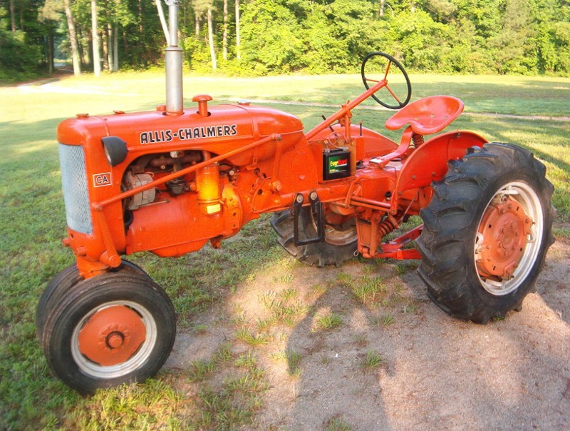

I believe the CA had the pan style and easily confused for a B. Particularly when it has the wide front.
