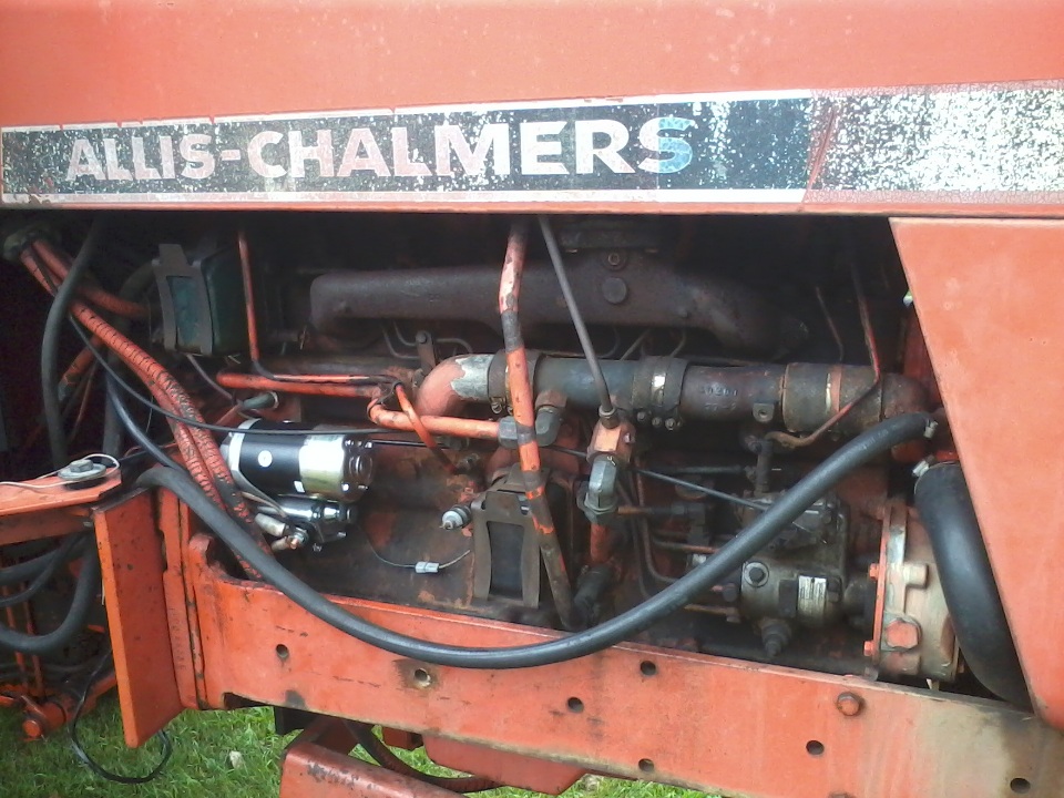

Post Options Post Options   Thanks (0) Thanks(0)   Quote JC-WI Quote  Post ReplyReply Direct Link To This Post Posted: 05 Aug 2018 at 11:12pm
Update...  After looking at that lucuss starter and one from another tractor, I figured out this one was one of them after market ones without the name stamped on it... acquired a gear reduction as was suggested by Mack and Ray and put that on, man it is slick... and you got the stud for the battery cables out in the open to use to grab juice from. So today as I walked by the tractor, I snapped a pic of it. Lots of room around it.
