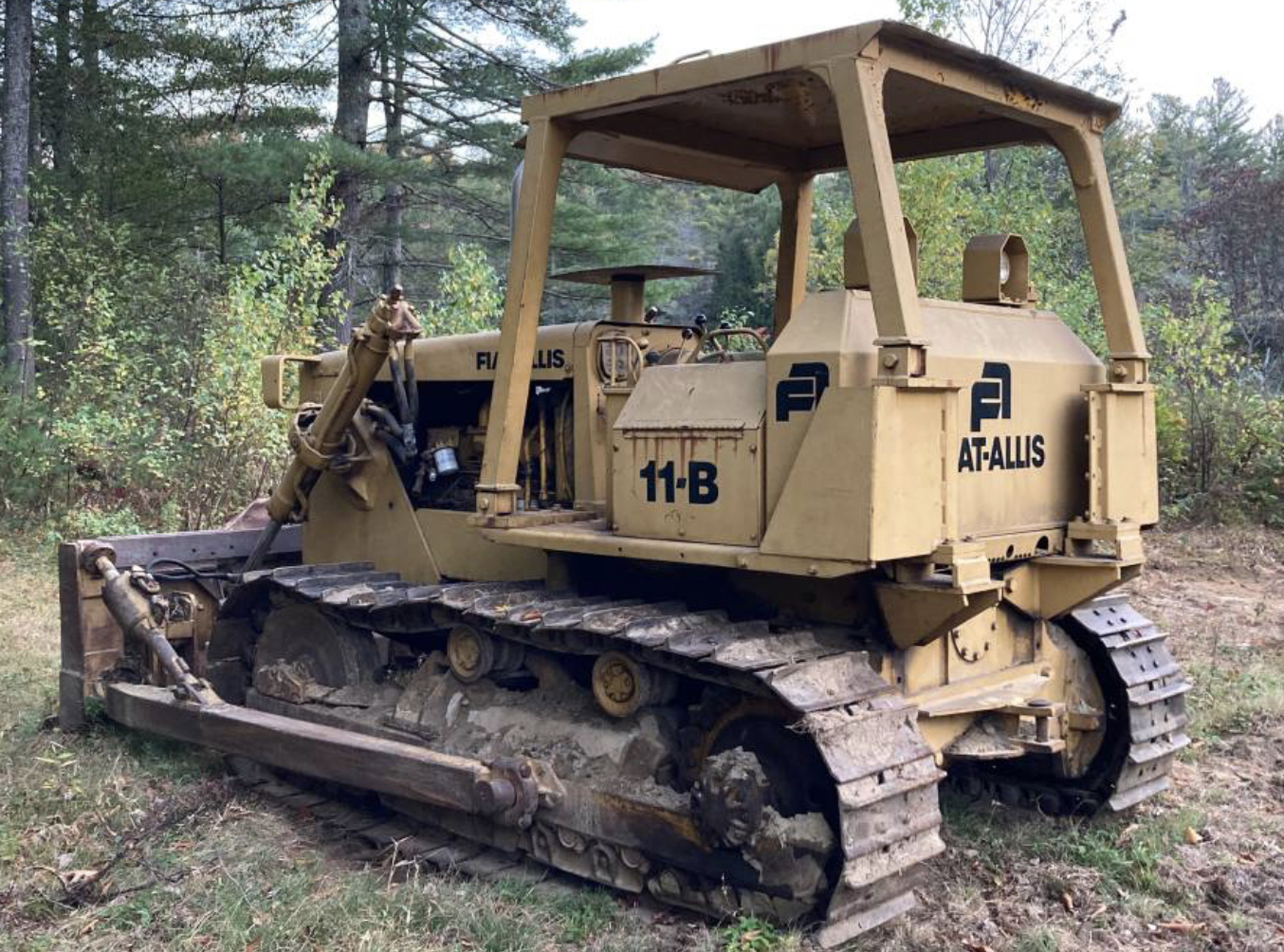

Ive seen how the old AC hd-11’s can be a parts hunt. How bout the 80’s FA 11b, i cant seem to find a good parts site. Can Case or CNH get parts for these? Should one avoid these dozer even if for a good price. Looking at one of these possible over a case 1450.

MINNPAR is about the best access to what is available, CNH dealers that will go thru the effort CAN access some residuals still in system but these tractors are now forty plus years old with parts sourcing depleting as we speak.  Rails and UC is Unobtanium USA now, can Mod it for Cat Rollers and 6.91 Pitch Cat rails but is a Job.  Engine parts trans parts, finals, just not much that has not been picked over.  If would have one and have to got to that level of modification would be better off buying a old Cat.

I appreciate that! Thank you for the insight and info! The problem im finding is a cat cost twice if not three times as much for a 40 year old 35k lbs machine. Like the finding something cheaper than that to use on our farm.

Been there done that and spent as much keeping it moving than had I bought a parts common machine in better shape to start.
Biggest concern became not the small parts I could interchange to industrial styles but the final drive gears, pumps that I had to convert the drive mechanisms, the fuel injection system no one would touch as no pieces and engine parts NLA beyond gaskets, for the subsystems that made it all functional.  My own is gone, had it really functional had a severe failure repaired that and sent it packing as had used up the last known repair part for the brakes.  Could have re-engineered replacement parts but expense was driving me away from that.  All too much was/is unique to Allis that is no longer made and would require a design change to repair.

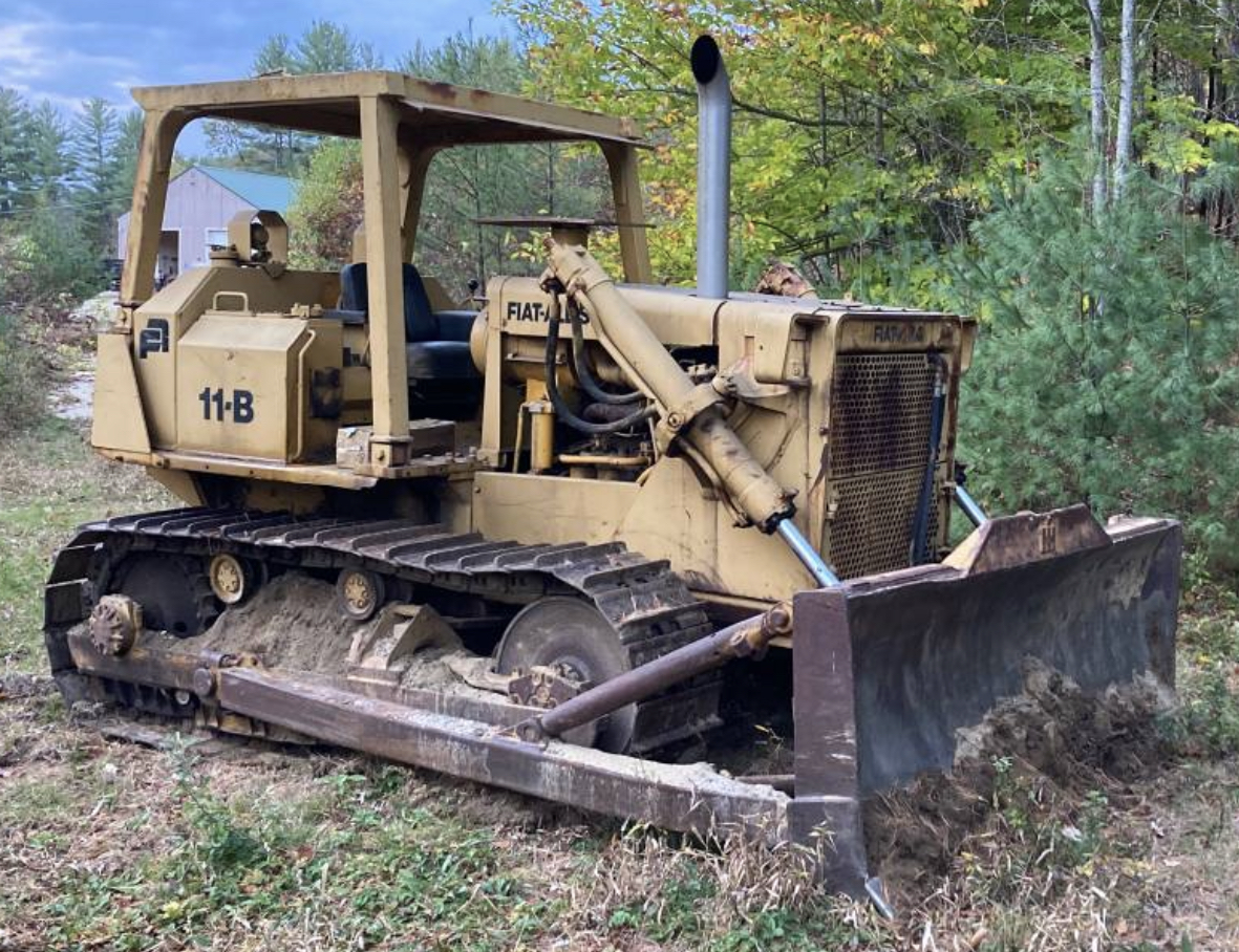

Might be able to pick this up less than $10k. Blade looks to be off a IH dozer. Been in a barn for 15 years. “Recent” drive rebuild. New batteries. Hour meter doesnt work. I can try and up load other pictures.

Already see a problem, Right Side upper rear roller is drooping, has a failed bearing, NLA for roller or internals.
The ONLY way I would buy another FA Construction series would be if all the UC was Newly installed, Unused and that will not happen.
Has a IH Blade on it, not certain why that had to be swapped as blades can be rebuilt.  Again these machines will have parts availability issues you may not be able to contend with.

i agree! Look at the left side how the blade is attached to the UC frame... looks like the IH blade is smaller on that pin.

Again, thank you for your input. Definitely dont need another headache at all. I dont mind old machine if parts are easy to get, but easter egg hunts are terrible with work is pilling up. What would a machine like this be worth to you?

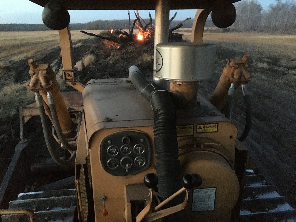

Now we are on my favorite topic- Allis Chalmers HD11 Series B.  This is a 100 percent Allis Chalmers product- no need to think about FIAT!  That one looks like a late 72 or early 73 model, judging by changes made to ROPS and front hardnose during that time.  Robert Bosch injection pump, 140 HP- competed directly with Cat D6C in that time period.  The best part about them has already been mentioned- extremely cheap horsepower, and if you aren't afraid to get your hands dirty, it's a match made in heaven.  Might want a parts machine though...

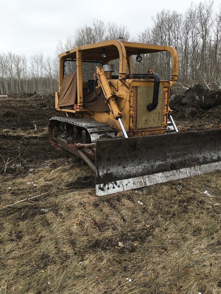

As to the carrier roller- these machines had a weakness there- shafts on the carrier rollers were too small and subject to bending in tough conditions, especially if there was mud or debris packing in the tracks to the point where the track release would be needed.  There have been various mods to deal with this problem, most commonly re-working the tower to take a Cat D5 roller (heavier shaft).  Sadly parts are getting scarce, but only makes it easier for the buyer to make a deal.

Is that your cab heater the black hose on the bonnet ?

The black hose is my "redneck heater"- made out of misc. plumbing parts
