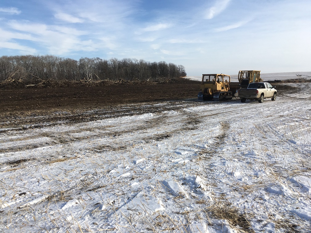

Posted By: Lazyts
Date Posted: 13 Nov 2020 at 8:25pm

Posted By: HOFarm
Date Posted: 16 Nov 2020 at 2:23am
looks like your using it for what id want to use it for!!

Date Posted: 16 Nov 2020 at 9:15pm
I saved that one from the scrapper- bought it in the fall of '17, it had spun a rod, undercarriage was completely shot, I rebuilt it with mostly used parts and put it to work the next summer.  Should turn over 900 hours tomorrow, all paid custom work for neighbors and friends- I don't have any land of my own.  Dad has a small farm, and has the exact same machine, we've put about 500 hours or less on that one in 8 years- his track chains still look like new.  Both of these machines have paid for themselves, I tore down another unit for parts, so we do have lots of extra parts.  I keep my eye out for NOS parts and buy the occasional piece I think I'll need.  If I use a part from my stock, I try to replace it.  I've re-powered two HD11s with N7 engines for other people.
It would be nice to have new parts available, but then again, with the price tags a guy would probably be looking used anyway...  I know guys running old Cats that mostly buy used too...

Posted By: HOFarm
Date Posted: 19 Nov 2020 at 11:54am
did yall clear all that with dozers? Very impressive. Will the keep those stumps windrowed like that or eventually burn?
Posted By: Lazyts
Date Posted: 19 Nov 2020 at 1:09pm
It will all burn eventually- sometimes the "locals" will go at the windrows with their chain saws for firewood.  It's probably not a good idea, with the price of carbon going up- maybe the new oil?  I just do what I'm told..Wink
