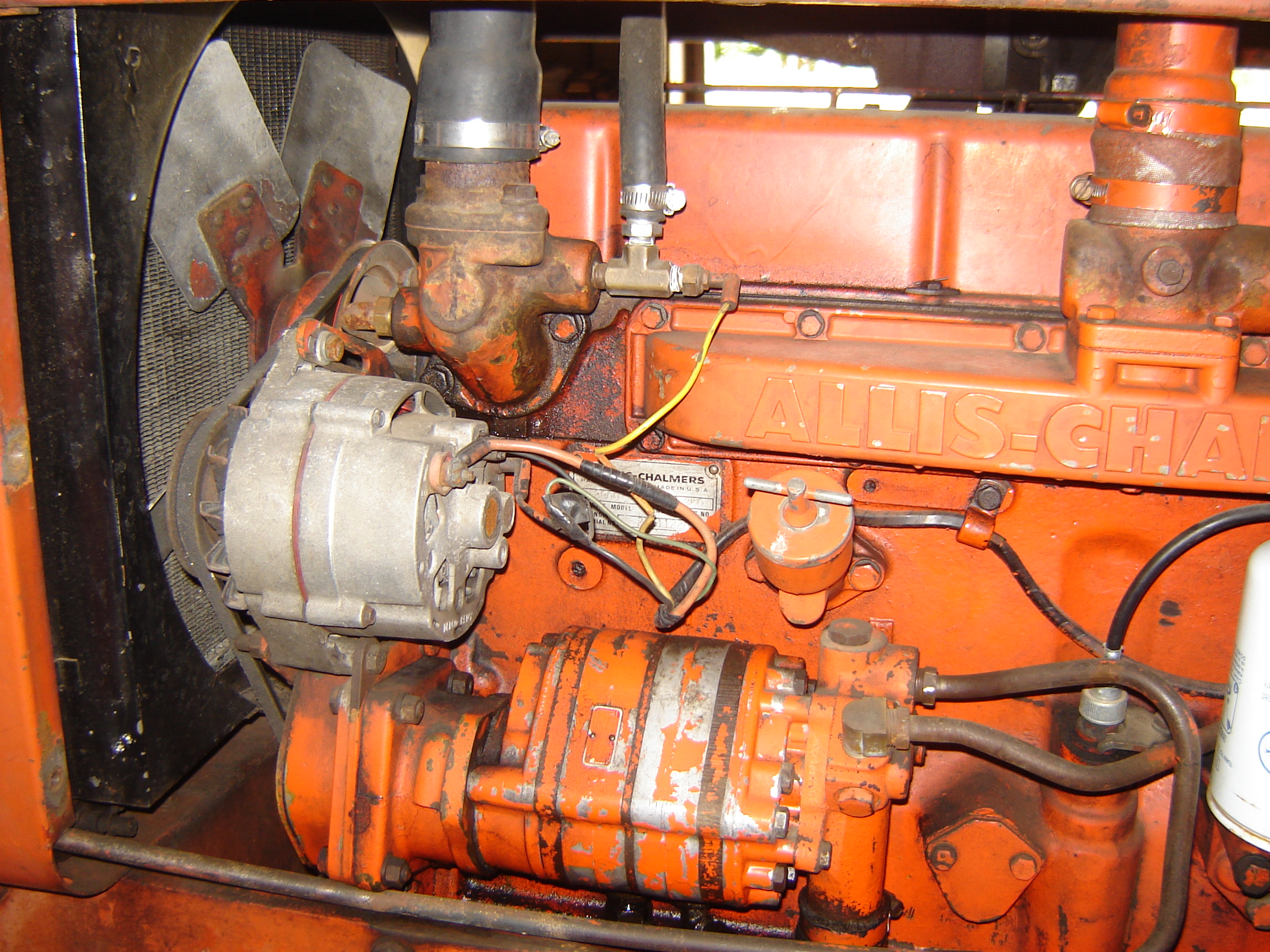

Originally posted by 6wheeler 6wheeler wrote:
Originally posted by tbran tbran wrote:
It drives off the cam / oil pump - mid block - the gas has a 90 degree plug on the distributor base that contains the tach drive mechanic and male threads for the cable. 74054851 IS THE PLUG     parts.agco
How did you find that number? I went on the sight and it doesn't recognize that number. It doesn't recognize the tractors serial number 190 5960 either. Maybe I am doing it wrong Ouch
Don't search my serial number, search by the model (190).  You have not said if your tractor is a gas or diesel, but here is a picture of the tach drive and cable on a 1967 diesel - just left of the oil filter.
