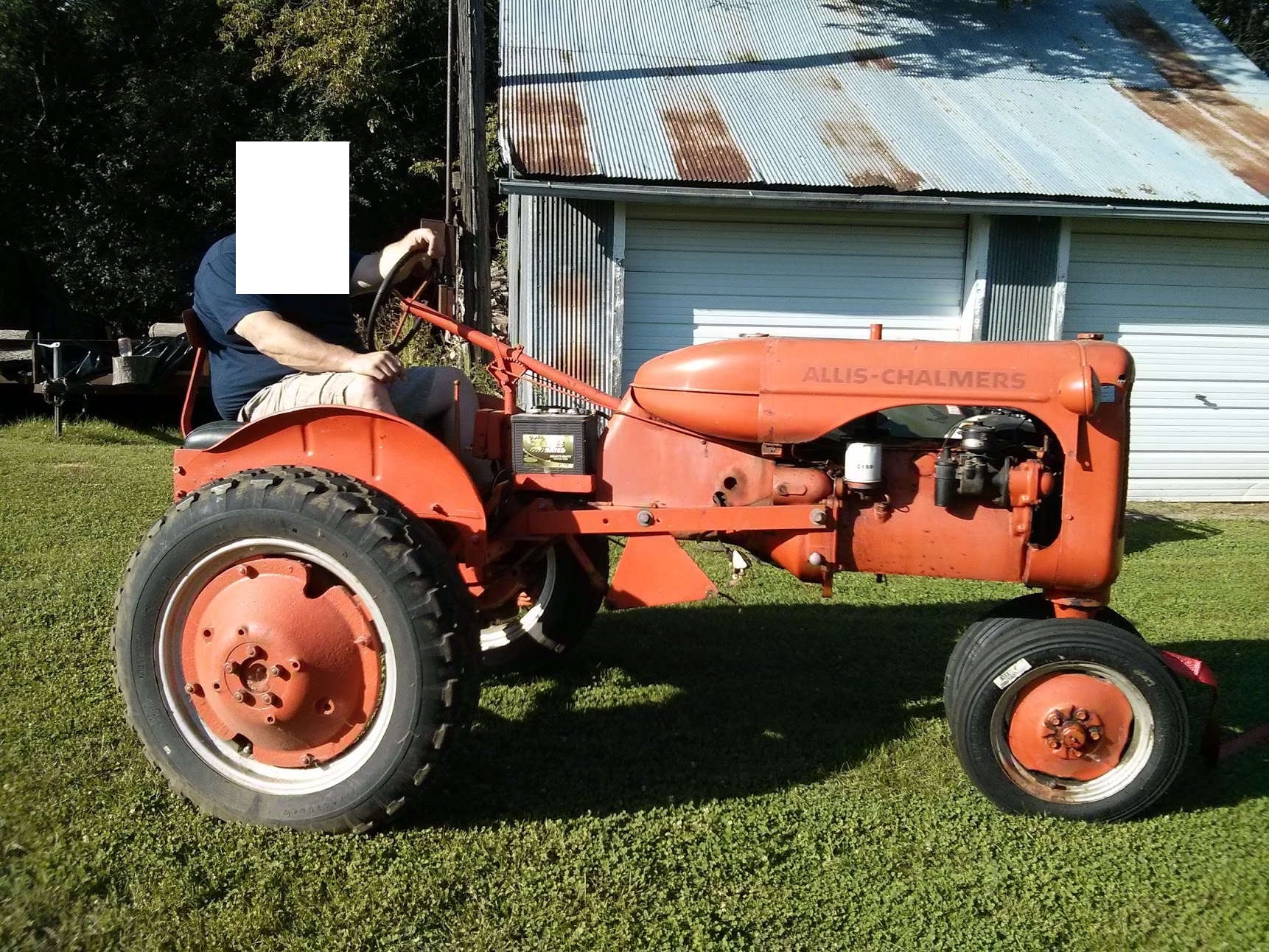

Hello,
I purchased a (supposedly) 1952 Allis-Chalmers B with a narrow front end (must be from a C from my reading) and I'm looking to first rebuild and get it running and then restore it. I've never owned a tractor before, I didn't even grown up on a farm, but I sure as heck have got the itch to get this beautiful machine running again.
I paid $700 dollars for it (I probably overpaid), it has 2 frozen pistons, and has been apart for about 8 years in a garage, it looks in pretty good shape. It came with a Woods L59 belly mower.
I know I have to clean up the engine, I was thinking about buying an overhaul kit with pistons and sleeves. Here are my questions:
How'd I do?
Where do I start with the engine, do I just buy the overhaul kit (on YT ~ $650) and start digging into it? I don't know much about motors but I'm pretty mechanically inclined and can figure things out. I understand it's a big job, it'll be a learning experience.
I figured I wouldn't worry about getting the pistons unstuck (was left outside and some rain apparently got in there, it doesn't look all rusty but they're stuck) and just pop them out with the sleeves since the overhaul kit comes with the sleeves, can I do this? Should I do this?
He said I should bring the head to have it professionally cleaned, it looks gunked up, not rusty or anything). Do I really need to bring it in? I heard someone online saying to make sure and get it "cooked", what does that mean?
Anything I should look for specifically before or after pulling the sleeves/pistons? What should I take pictures of to help on forum questions?
Any books you recommend?
Best place for parts? (DJs, YT, OK, anywhere else?)
Where can I find a picture of an original 1950s B so that I can see the original color scheme for all parts/body?
Sorry for the book but I figured I'd ask the experts.

the rear hubs have 5 bolts which appear to be from a model C.. with the narrow front, I assume you have a "C".. serial number is by the shift lever stamped into the case.
Motor stuck, a kit with pistons and liners would be a good start. You might be able to save the  liners and pistons, and just install new rings if you really know what your doing. Yes, you can pop them out as a unit, but you need to get the piston out of the liner so you can take out the connecting rod and reuse it.
  Motor is very simple. When the liners are out you can pressure wash inside the block and clean out all the gunk.  The bottom end is somewhat different than a car motor. The bearing caps normally have a few shims between the block and cap on the bolt. Removal of a couple shims will allow you to tighten up the clearances. YOu will need to measure the crank and bearings and get the clearances set right. If you have not done this, you wil need a little help or advice when you get to that point. A micrometer would help. The crank has to be round. Several thousandths out of round would not be good... Taking the head to a shop and letting them fit the stem guides and lap the valves might be a good idea.

Some B's had the 5 bolt rear wheels but no B's had a narrow front end from the factory. I can't tell from the picture how wide the finals are. If they are wide like a C it could be a C with a B tranny if the tractor number starts with a B.
 If the cylinders don't have a lot of ridge in the top and aren't rusted up or scored, you might be able to get it running without an OH kit. If you buy a kit with bearings, you need to mic the crank before you order it to get the right bearings.

what is the serial number ?  photo of tractor from left side to show steering. photo from back to show final drive housings.
---rear hubs are deep dish (C) and rims appear to be set in as far ass possible for narrow width....... looks like new rims ?? Are the 4 mounting bolts of the hub to the rim go thru a steel "loop" welded to the rim ?

One thing I did note was that the steering linkage (or whatever it's called, sorry) points up, and apparently on a B it points down. I just assumed that since I was told it was a B, and found out from reading online that B's didn't ever come from the factory with a narrow front, that putting the narrow front on it from a C may require you to change that piece too.

Since C fenders are not as easy to find to replace if needed and this tractor has the C fenders I would guess it is a C. A picture from the rear showing the drawbar would be the key to its identity.
The center drawbar is from a B the outside one is from a C.
These little engines are great to learn on. They are a little different than an auto engine as how the oil system works and the way the main and rod bearings are shimmed. The bearing bores can be upgraded to not need shimmed but costs more money. The main thing is to make sure how each and every detail works and why. You will find a lot of good help on this site.
Points: 90463
Post Options Post Options   Thanks (0) Thanks(0)   Quote steve(ill) Quote  Post ReplyReply Direct Link To This Post Posted: 16 Sep 2015 at 8:55pm
If the steering arm points up ( at the gas tank), then you have a "C" gear box also......... starting to look like a C tractor.

A narrow C front on a B using a B steering box.

Dick L, yeah the one I have points up towards the tank. Also, my rear wheels are about maybe 6 or more inches from the fenders. Must be a C.

Everything I see in the picture has "C" written all over it.
